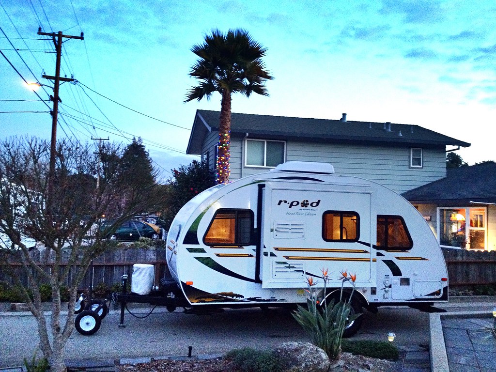

A Ram 3500 with a Cummins can weigh anywhere between 6,000 and 7,500 pounds, and yet they are rated to tow up to 30,000 pounds. So if they are rated to tow almost 5X their curb weight, then I don't know how towing a 4,000 pound trailer with a 4,000 pound 4Runner is considered "unsafe." Americans like excess and believe you shouldn't pull anything with less than a diesel truck. Try going to Europe or the rest of the world and you'll see little 1.6L cars pulling "caravans" (small trailers) everywhere, and on grades at least as steep as ours.
My point: You'll be perfectly fine. With an automatic you may be a little slower on the hills, but nothing like your Bronco II was. The transmission cooler is a must and with an automatic transmission, I think the Tundra brakes are a really good idea. Not necessary on a manual though.
This week we did a roadtrip from California, across Hwy 50 through Nevada, Arizona, Utah and New Mexico, and saw (and photographed) several vehicles pulling the 3500-pound R-Pod trailer that we are interested in. Among those vehicles were a Pathfinder, a Mitsubishi Outlander, a Subaru Outback and a Subaru Forester. None of them were upside down in a ditch, overheating, or doing 25mph up passes. We did see at least two dozen newer diesel trucks broken down on the side of the road though.
Here's my advice. Rent a trailer of similar weight and take it over some passes and make sure you're happy with it. If all else fails, U-haul's 5x9 trailer with ramp weighs 2400 pounds and you can rent it for $29 per day. I rent these at least once every couple of months and will give you some idea how your truck handles the weight.
From this weekend:

LOL, yep that is pretty much my thinking on it so far.
I was just now looking at RV rentals in this area which is a little sparse apparently but I should be able to find a trailer of some sort in the 4000# range to give it a work out.
4000# is my absolute max weight I was ever even dreaming of anyway, so if I can rent something like that and haul it to the mountains to this particular campground that I like that will give me plenty of Highway mileage and up and down hills plus a pretty decent dirt road up to the campground.
That will give me a good idea of what I feel is my comfortable towing capacity is in the 4Runner.
Thanks

Yep the RPod was my first consideration after the T@B Teardrop.
The main problem that we couldn't get past was that none of the models have a "Dry Bath" the taking a shower sitting on the toilet thing is a no go with us.
That and the price was on average about $5000 more than the Pacific Coachworks which has a good size dry bath with a closet inside it.
The RP 179 was really good looking though, I liked the rear kitchen that was good size, but $5000 to much for a single axle and the wet bath took it off our list.
Since you are in California you should check out the Pacific Coachworks Econ E16RB, pretty much the same as the RPod but cheaper, made just as well if not better, basically the same weight.
Looks like a nice floor plan, and the aluminum construction is key. Do you know if the actual framing of the trailer is also aluminum? Some manufacturers somehow get away with saying "aluminum construction" even when much of the framing is wood.
My biggest complaint with these small trailers is the lack of windows. Obviously when the trailer is small they need wall space for storage, but then you end up feeling like you're boxed up with no view. That's what I really like about tent trailers, is the open feeling like you're really camping. The R-pod with the rear tent, or almost any hybrid trailer, fixes that issue by offering hard sides but with the openness of a tent on either or both ends of the trailer. No one trailer has everything I want. A dry shower would be nice, aluminum construction, dual axles (like the Fun Finder X), at least one tent-end and lots of windows, haven't really seen it yet. I could very well end up with a tent trailer with an added external enclosed shower.
