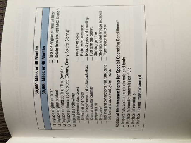

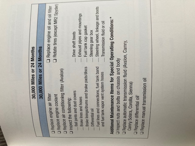

My 01 schedule says coolant drain every 120 Months, I try to remember at 60.
The toyota red coolant does say good for 'Life' or 150K.
My factory maintenance schedule says to replace the engine coolant every 30,000 miles or 24 months. It repeats in the maintenance schedule every 30,000 miles as well.
