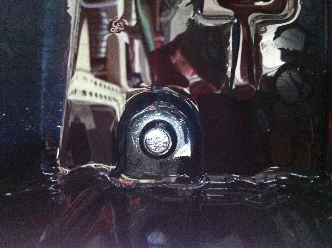

Got the pan off,there is enough meat to retap,I can buy a new pan for 95.00,or tap for free.
I think a heli coil for 10x1.50 might be alittle to big but I could tap 7/16x14,whats your oppnion?
I was going to recommend a helicoil; I put one on a spark plug in a '89 Toy PU and worked fine for 60k, prob still works, I sold it... not a lot of pressure in that system. Just remember if you have to strip gasket material use a plastic putty knife!!!
I used a 3/8helicoil,that's as close to the oem size as I could get,it's covered in ATF to test for leaks,now I just need to find a decent 3/8bolt and gasket.im just using the stock crush washer and 3/8 washer and bolt for testing.
