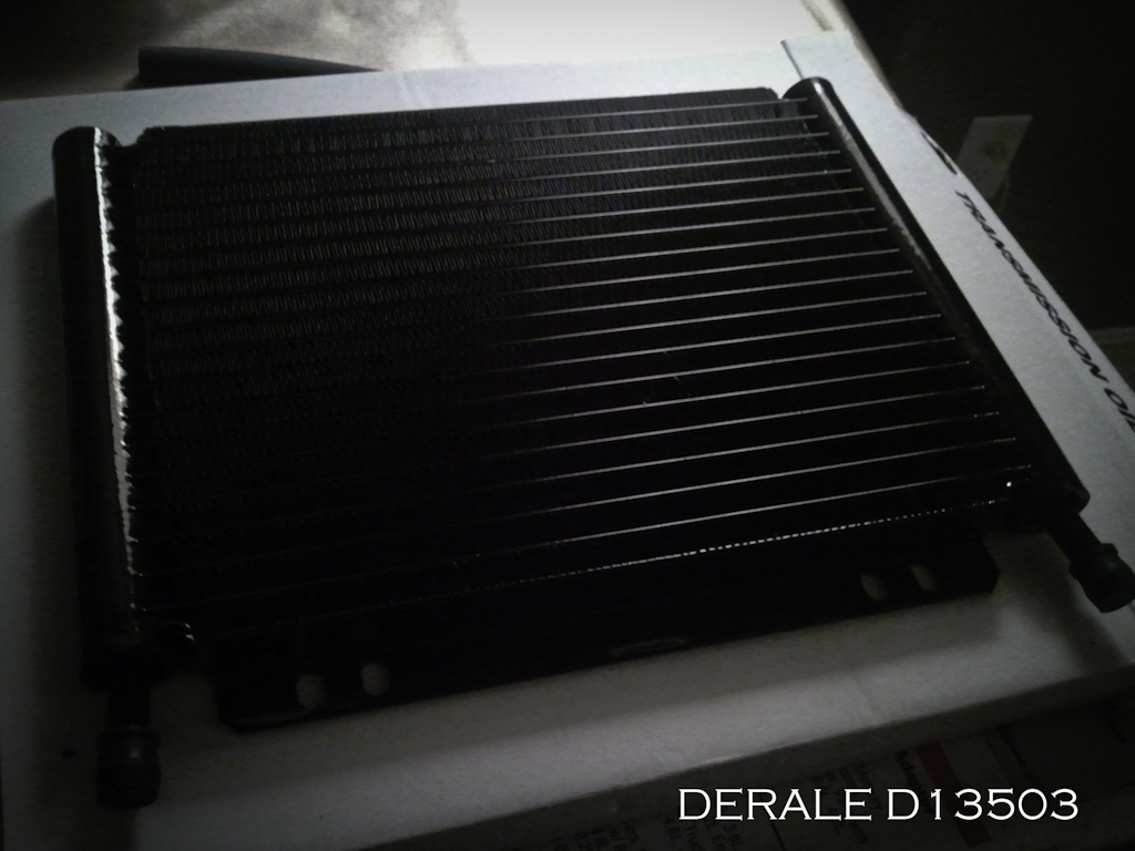

I just got a Derale D13503 plate-fin cooler from etrailer.com . It measures 11" x 8-3/4" x 7/8". Not pictured are the nylon "through-the-radiator" zip ties, the 4' of hose and 4 included little hose clamps. Impressions are that this is a high quality piece...no signs of cheapness or shortcuts being taken. Here's the direct link for the part: Transmission Coolers by Derale for 2006 4Runner - D13503 4 feet of hose is kind of exactly as much as you'll need, so I went ahead and bought myself some more hose at the local auto-parts store so that I had some leeway in routing these things. It was cheap insurance against not having enough hose. There was no use for the included fitting....it is a universal-fit cooler.

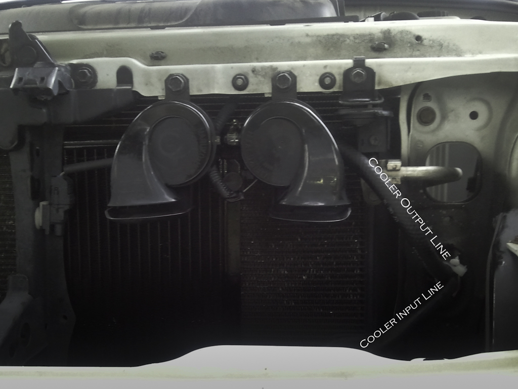

I actually do think it's best to mount these right to another heat exchanger. To benefit the most from the airflow created by the fan shroud and cooling fan, I went with the recommended installation and put it on the front of the A/C condenser. I can say that when the engine is running, you can feel the air being pulled through the front of it with your hand up against it. This way, you get cooling not only at highway speeds, but at rest/idle, as well.
I was able to mount it right in front of the fan by carefully pulling it up from under the passenger side of the front bumper and sliding it behind all the supports, horns and stuff and into place. It may be worthwhile to remove the horns for installation, but I didn't. The black cover on top of the radiator support was also removed for easier access. Also, make sure to attach your hoses to the unit before installing...it would be a lot more difficult to do so once it's on the delicate condenser. One thing that will be necessary is to carefully unbolt the radiator to properly fasten the zip ties. You will need to be able to access the rear of the AC condenser to fasten the ties to it. DO NOT RUN THEM THROUGH BOTH THE CONDENSER AND THE RADIATOR. Not only will this put unnecessary pressure on both, but it will make radiator replacement difficult down the road. I did not take pictures of this part of the procedure, but there are two nuts/bolts on each side of the radiator that you'll need to remove. Be extremely careful in moving it.

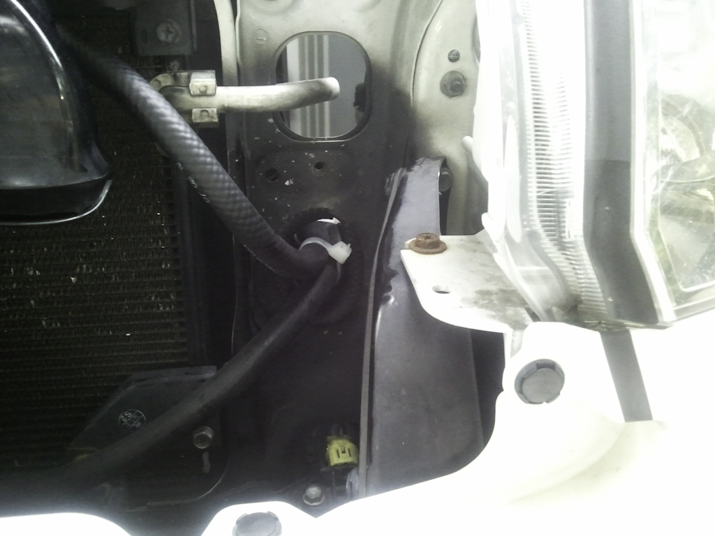

I used a pass-through near the driver's side headlight to route the hoses. I would strongly recommend doing what I did and put some split unused hose around the edges of this to prevent any chafing or cutting from the bare metal edge of this hole. Pay a lot of attention to your hose routing all throughout your plumbing to avoid any rubbing or cutting issues, as those can leave you stranded on the side of the road. I used a few industrial strength zip-ties to keep the hoses in order and away from the edges of that pass-through.
