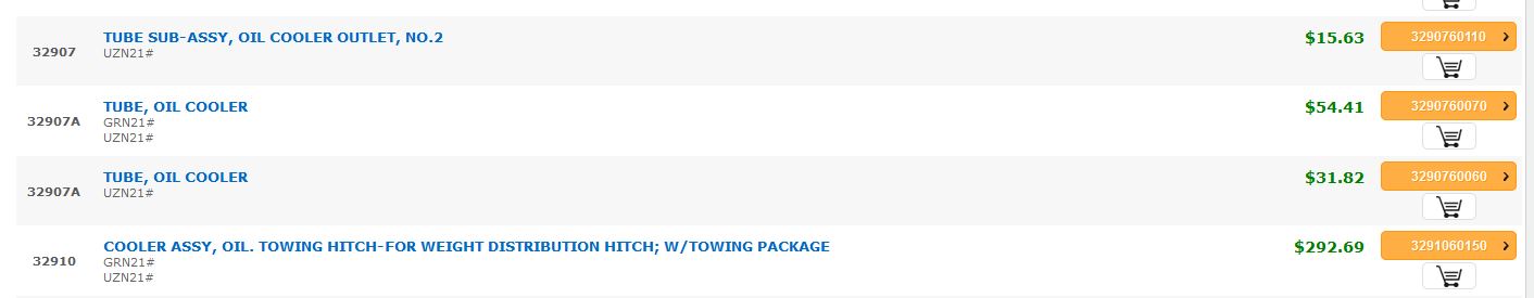

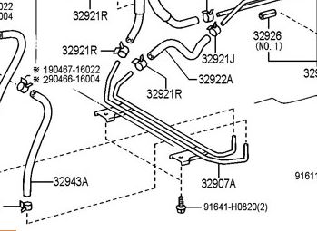

I was under my truck inspecting the lines and noticed that I have a lot of corrosion on the transmission cooler lines. I want to order the part but have a question. On the parts site there are two brackets Part number: 3907A.
One is $50 the other is $30. Both say it fits the 4runner? Are either ok? Not sure what the difference is?

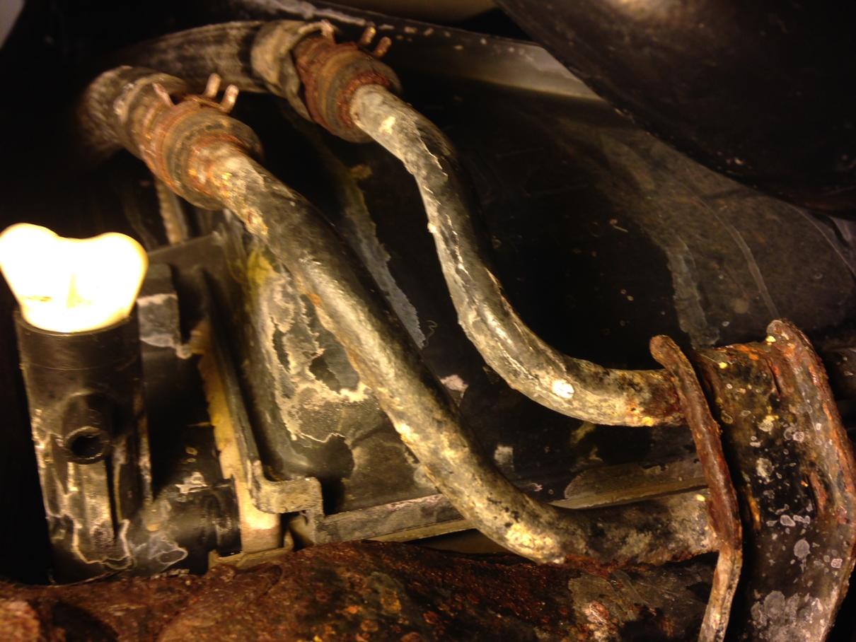

Here's a pic of the corrosion on the line, its pretty much right at the bend. I was able to pick it apart with my finger... not leaking yet but almost there.
The dry coolant is from a recent timing belt change.
