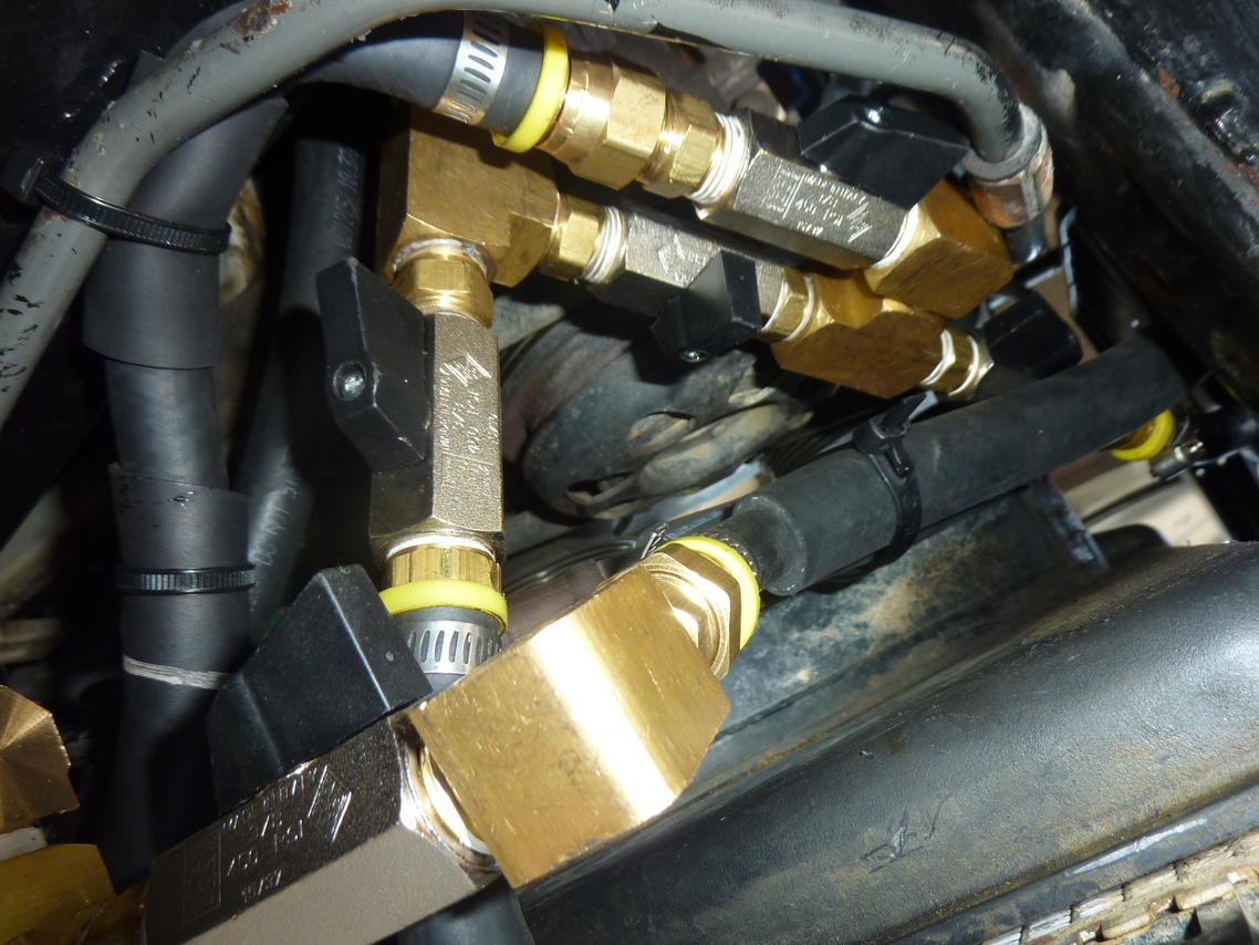

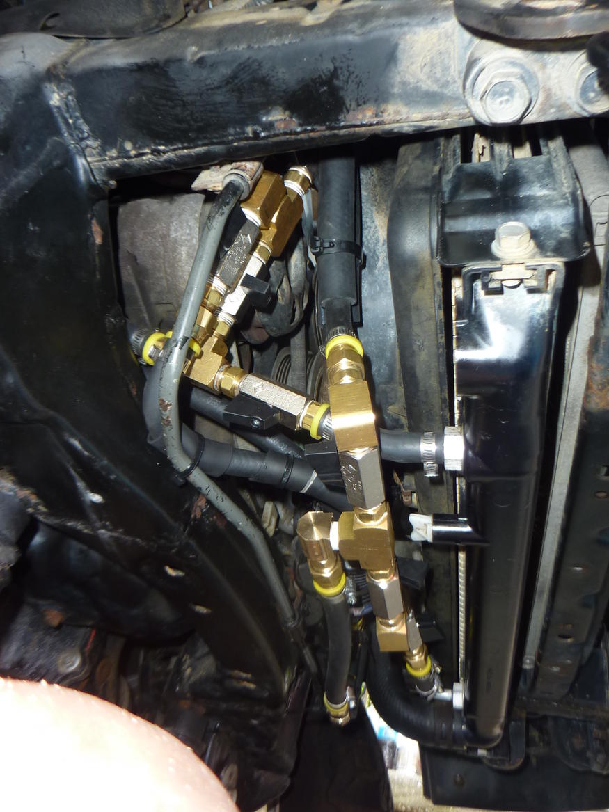

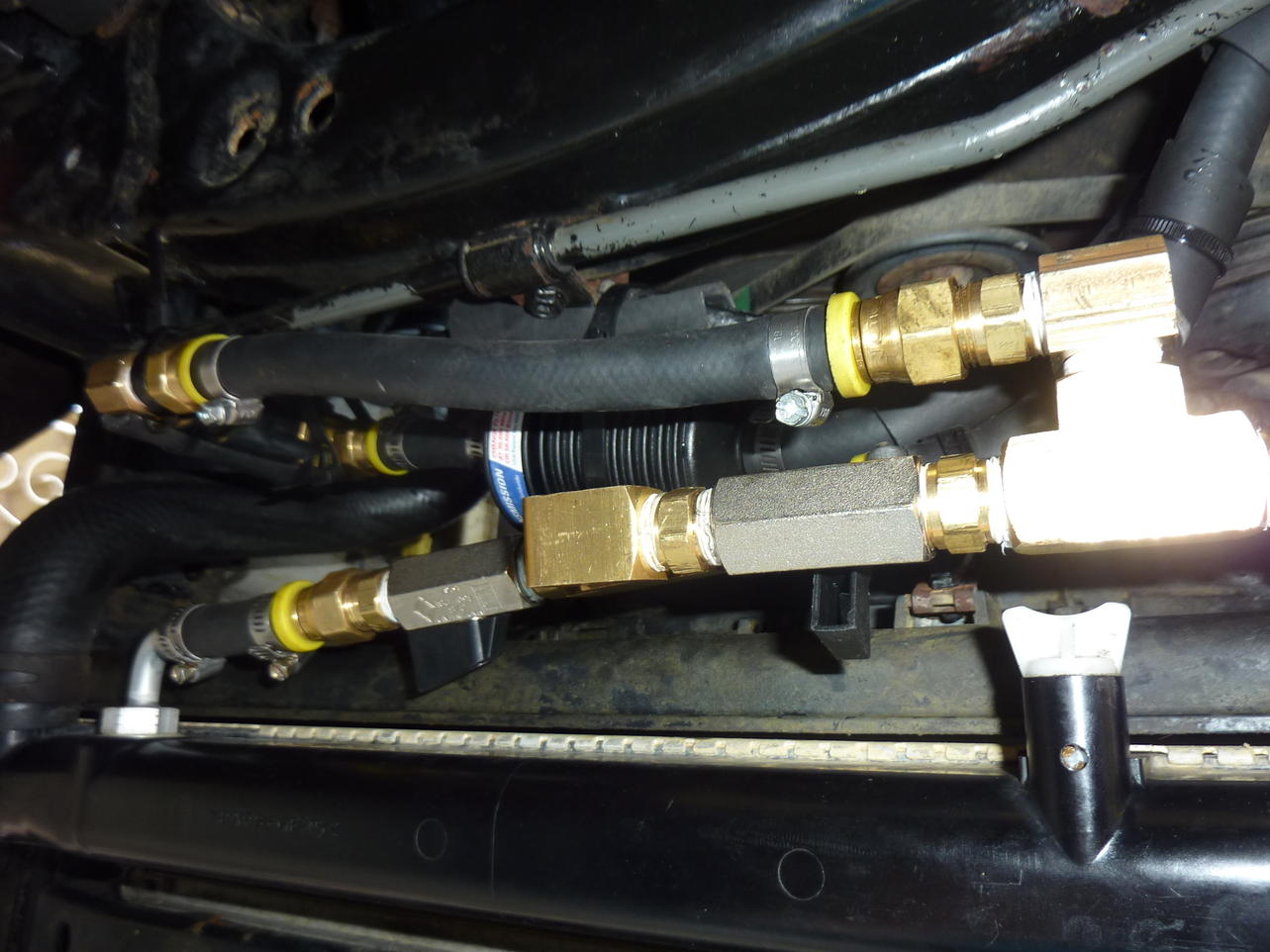

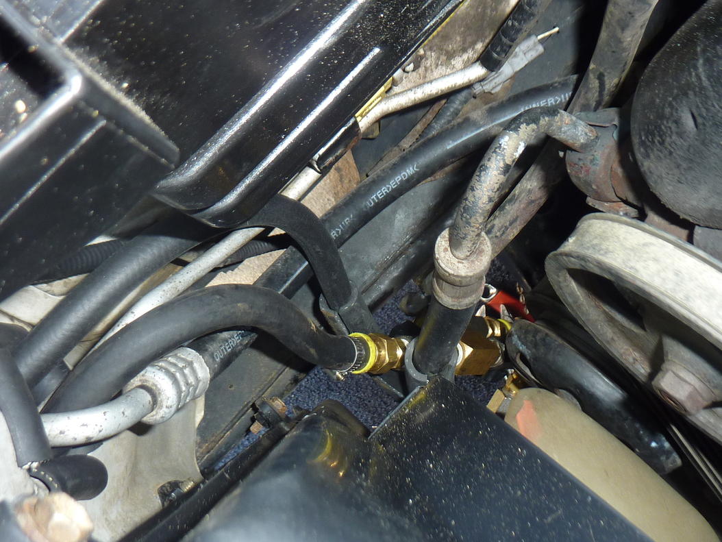

So I installed the external cooler last weekend with the valves and such. Installed a Magnefine filter on the return line before it goes back into the transmission. Might look a little "busy" but there's really only one place I made a 180 turn just to be able to add and locate the filter properly. Nothing shakes around at all. Temps haven't gone over 200* which was my primary goal. I'm gonna run it like this for my trip down to Florida then I might run it just through the cooler on the way back. Added a few more pieces of hose (which aren't pictured) so there's no rubbing like in the 3rd picture between the valve and brass elbow contacting the PS line.
That's a whole lot of fittings. Those fittings, especially anywhere the fluid is forced through a 90 degree is going to increase friction loss and drop the pressure of the fluid. A rubber tube making a gradual curve is going to have way less friction loss than a series of fittings accomplishing the same thing. Whether or not it's going to create any issues for you remains to be seen. It is an impressive set-up and it will be interesting to hear how it works for you over time.
Wow, that is busy. But if it works, no problem. I just wouldn't have the patience to do such.
I have to ask if you aren't concerned about what the Jersey winters will do to such a set up.
I hear ya. I definitely didn't want to starve the return back to the transmission because that's were it's most critical. I took that into consideration when doing this. I examined the loss coefficients for all the fittings in the different positions. That's why in any final valve position there's only two 90 degree turns and the 180 turn for the filter, plus some drag in the lines too although the line size throughout this setup is all around larger. The 90s are larger in bore to lessen the restriction too. We use these when we install air systems which cut down the restriction, which for high pressure air and liquid is calculable. In this setup, there losses are negligible, maybe even non existent with the larger diameter.
Also, as I previously mentioned, this is only temporary. Just a little too much to leak as opposed to just two rubber hoses. I hope to provide some good feedback for running a cooler in series with the radiator as opposed to just an external cooler or just a radiator.
Sounds like you know what you're talking about and have done the research on the potential friction loss. I was basing my comment on my own understanding of friction loss from my firefighter/engineer training where we have to calculate friction loss based off the coefficients in different hose diameters, friction loss in fittings and friction loss due to the pump pressures you're running.
Looking forward to hearing about your feedback once you have all the data compiled.
