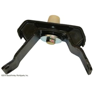

If yours is 4WD the P/N for BECK/ARNLEY Part # 1041805
There are 3 different mounts for 1999. Two of them are for Rear wheel drive.
Thanks, but it seem to me mine is different.
here is Beck/Arnley:
and here is mine... Do you think they are the same?

the beck/arnley one you show is for a manual trans. You have an auto and the mount is different. As seen by your picture.
