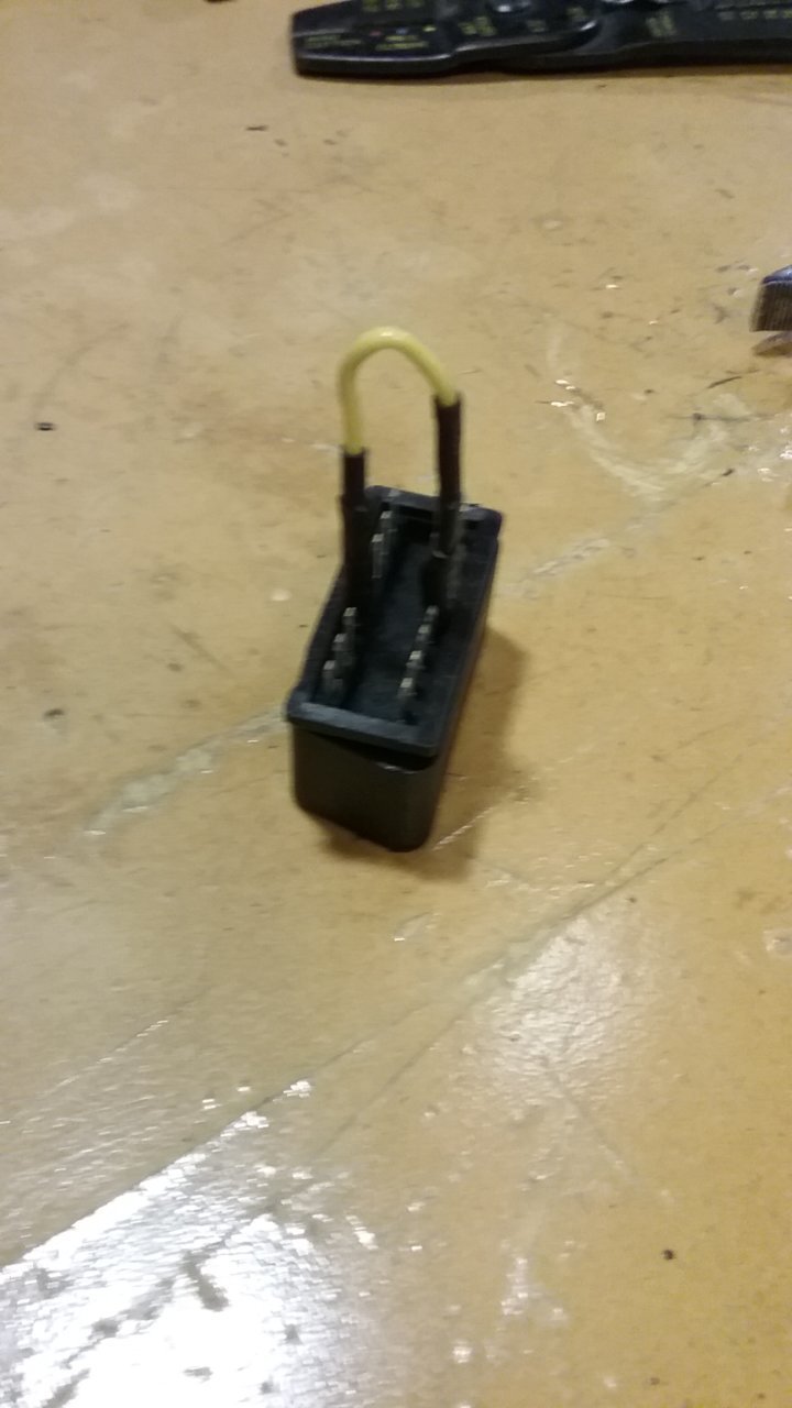

Jumpering the pins is a piece of cake - takes no time at all. Most easily accomplished if you make a small jumper gadget that eliminates the need to crawl down below and squint looking for the #4 and #13 ports in the OBD connector. That said, the jumper method is documented in the FSM.
Pic of gadget below - taken from tacomaworld.com - gadget sold by all kinds of people on ebay. Here's one:
Yes you can
Thank you sir! This the best idea I have seen on this thread, use it to monitor all your temps during your normal use of the vehicle and get live tranny temps when doing your transmission service. It’s a win win!
Just placed my order, thanks DeltaWhiskey.
