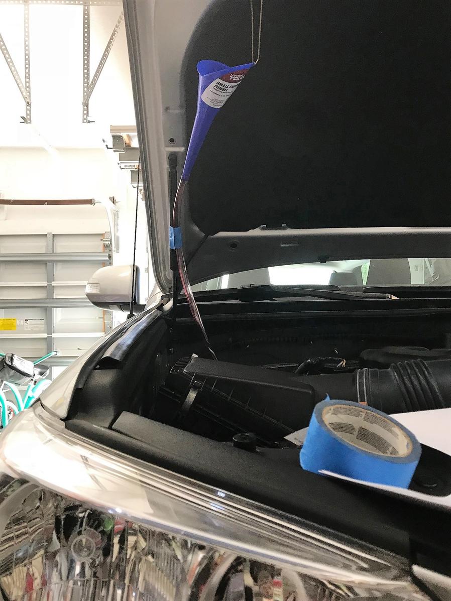

Finally changed out transmission fluid. This may sound OCD but since I have a level kit up front I put 3/4 inch plywood under rear wheels to keep things closer to factory rake. Also, I used a small funnel and half inch clear tubing to fill fluid instead of a pump. I decided to put in a little more than came out and the temp check using the paperclip worked perfect with little fluid draining out.
