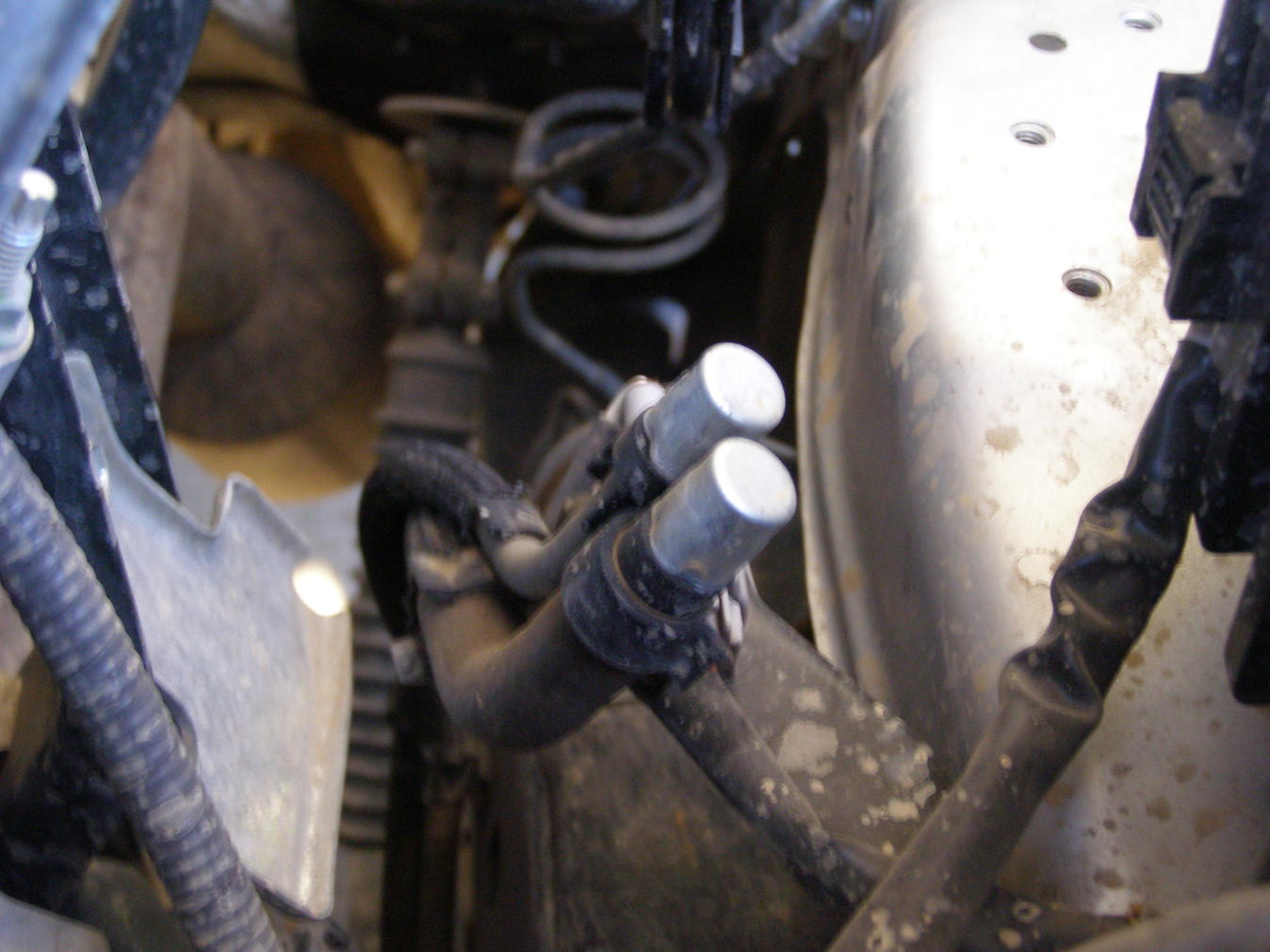

I remember seeing 2 breathers right next to each other in the engine compartment. They were attached to the outside drivers side wheel well in the engine compartment.
I'll snap some pictures tonight if anyone is interested.
I assume one of these breathers is for the front diff? What about the other? Tranny?
two breathers
"I remember seeing 2 breathers right next to each other in the engine compartment. They were attached to the outside drivers side wheel well in the engine compartment They are on mine like that.
08, v-6, sr5.

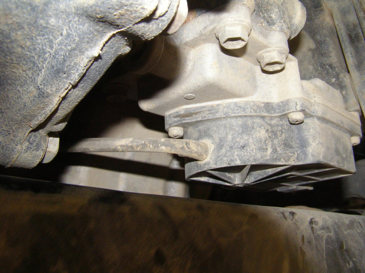

1 goes to the top of front differential houseing and the other look like the an actuator in the 2nd picture, not sure what it is.

Since the 2 breathers wasn't a transfer case one, I went in search. Followed the lines and it is in the same area as transmission one. Mounted closer to the engine section/ bell housing. Need a inspection mirror to see.
08, v-6, sr5.
Both of these breathers are for the front differential.
One is for the actuator for the front differential, as seen in the picture. The other one is for the actual front differential, line goes to the top of the diff.
