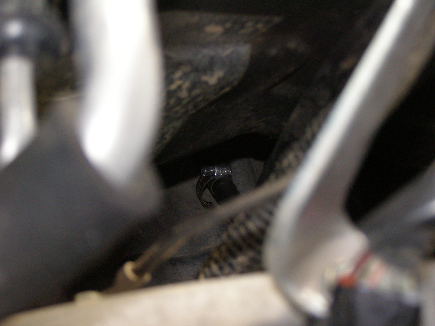

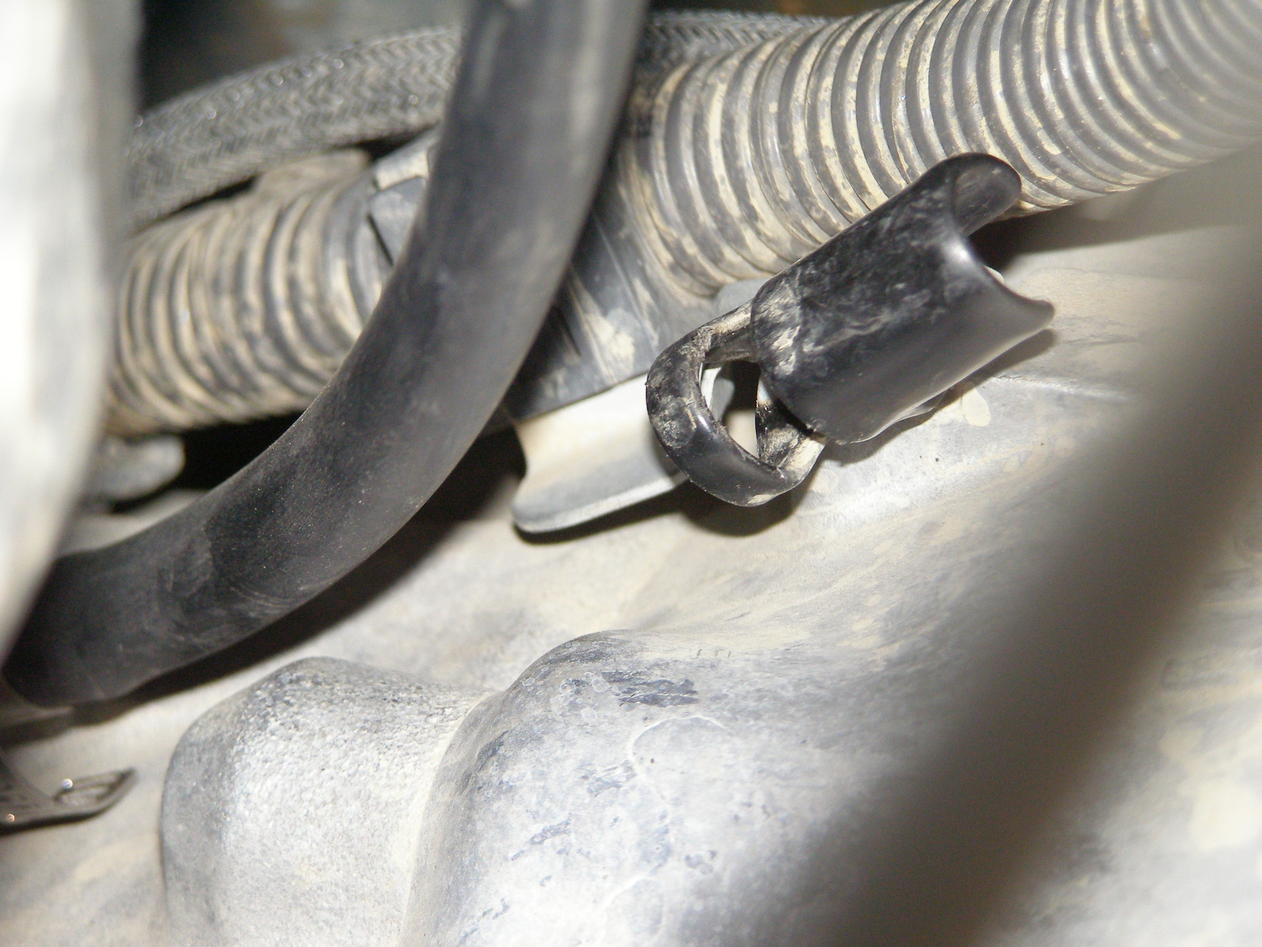

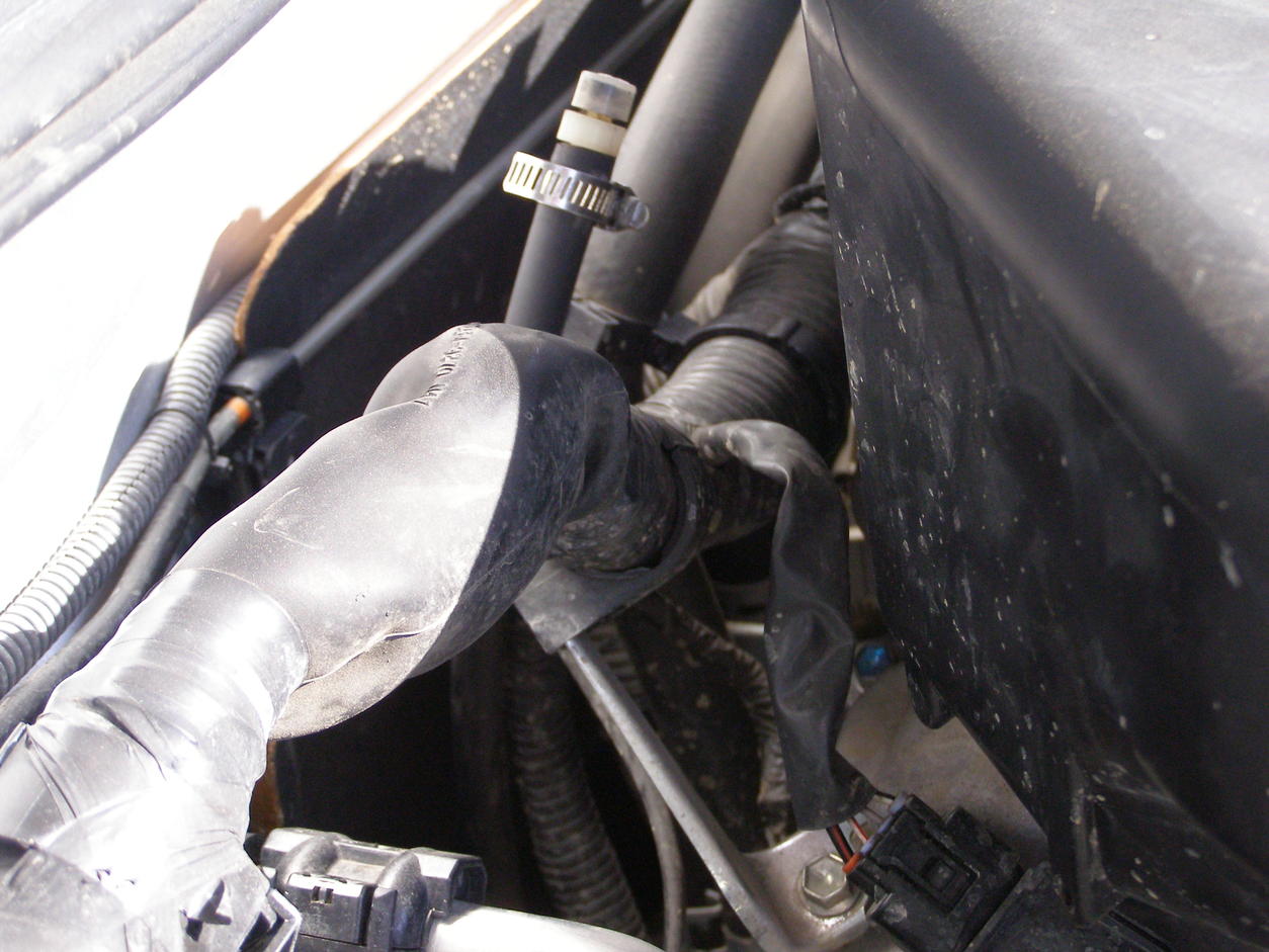

Hope these pictures help. In the 1 photo you can see where I attached the hose and clamped it, can be done.
The 2 photo shows the hose and in front of it is where the factory hose slide into to a bracket to hold it. I couldn't get the hose I have on there to fit into it, even with soap on it. The factory one has a sqeeze clamp on it and a 6" hose with the breather on it, just twist it off and pull through the bracket. I just put the breather on the hose I used.
I have it just straped for now. will do a proper mount when I get the transfer done.
The transfer breather is located at-- when you see where the bracket for the transmission hose, it is in a straight line to the block( engine). Just above the bell housing/ block area, if you can reach down there you will feel it. I traced the lines from the transfer to that location and used a mirror to see it.
I would say splice into that hose above the transmission as it seems to be the easest spot with hand room to play in. I will be getting some hose brackets to mount to the engine area to make it more factory apperance.

Got under there again, and found a hose 9/32" that I could fit into the trans hold down bracket shown in previous picture. Have routed it and zip tied it to the same spot as before.
In photo below you will see a braded hose cover, that is the transfer hose 5/32". Reach above the transfer case and pull on that hose to the rear, it will pop off the holder. Pull again and the hose will pull through a wire hold down clamp that can be seen from the left side above the transmission, the breather will stay on the clamp area and hose will pull through, no hose clamp on this line.
I added a 2' piece of hose to this line and routed it on the right side and zip tied it to a spot above the tranny, continued to the engine compartment with the trans line.
