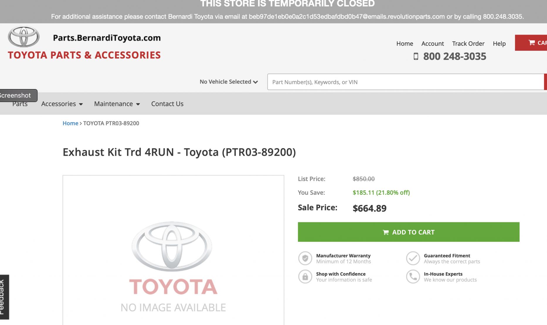

sorry a better question would be where can i get it?
Just find a local dealer that will price match. Most dealers can get it in a day or 2

Mine showed up tonight and there's a sticker on the carton "Attention - The installation instructions for this accessory are on the electronic Toyota Information System (TIS). Please see your Toyota dealer for a copy".
I don't really need the instructions but would be curious to see what the torque specs are. I saw Toyota stated 48 N-m (35 lb-ft) for the Taco unit, then I saw the youtube from SnailTrail4x4's Borla install, he used 20 lb-ft.
Haven't a chance to unpack but I suspect the donut gasket is not included. I suppose the existing one can be reused as ForRun indicated. Besides, TRD site shows two separate parts - PTR03-18131-AA & PTR03-89200-AA. The first one appears to fit the FRS as well while the latter is no where to be found. I just don't want to have everything apart only to find out I lack a lousy $10 part.
For those who had done the install, what is the consensus on the torque and gasket?

No need for another part. Reuse the front bolts and front donut gasket. Other parts are included.
As for torque, I didn’t lift the truck so using my big ass torque wrench wouldn’t work. I just used an impact driver with socket adapter and tightened the hell out of it. No leaks. No creaks. Don’t plan on taking it off. Bolts will seize with rust and salt anyway... maybe it has something to do with gasket sealing properly, but I have no issues. Just make sure you tighten gradually. One side, the other, back again, etc to get uniform compression on the gasket.
