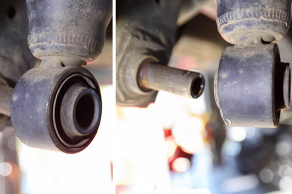

I went through this with 2 different sets of shocks. I suspect the bottom mount like I mentioned in post #30. I am willing to bet that the spacer that goes through the lower bushing is rattling around in the lower shock mount post, which is a fixed length. This only happened to both king and icon shocks for me when it was cold. The icons had rubber bushings, but the sleeve would still rattle in the cold when the rubber bushings would become harder. The kings have misalignment spacers, and used to rattle like a bastard until I found it.
It's unlikely that a tech is going to find this on a hydraulic lift. It's going to be blamed on the shock. Past experiences with Fox make me think that they're not going to be helpful at all.
Get someone to rock the truck in the cold so that you can recreate the sound, and climb under there and put your hands on the shock. If you hold the lower mount and the sound stops, the fix is an easy one.
This is what the lower mount looks like. When the male bolt is tightened, this post is a fixed length, no matter the torque.
Clunking at slow speed in the winter was the sound I fought for years. It only takes a tiny bit of slop to make a big amount of noise here. And it can be great all year until the temperature drops.
