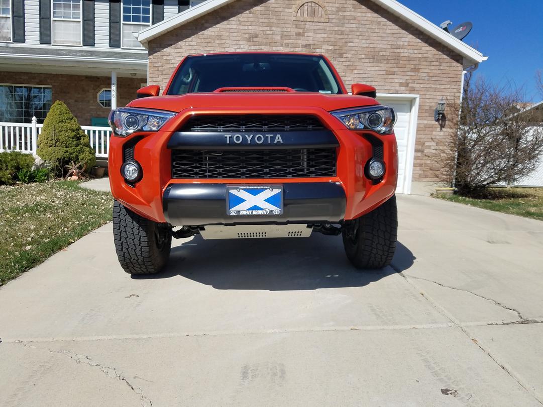

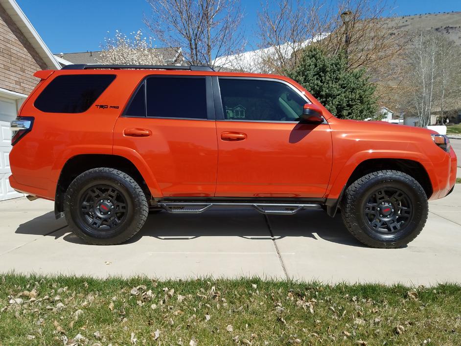

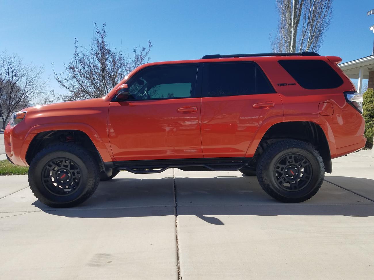

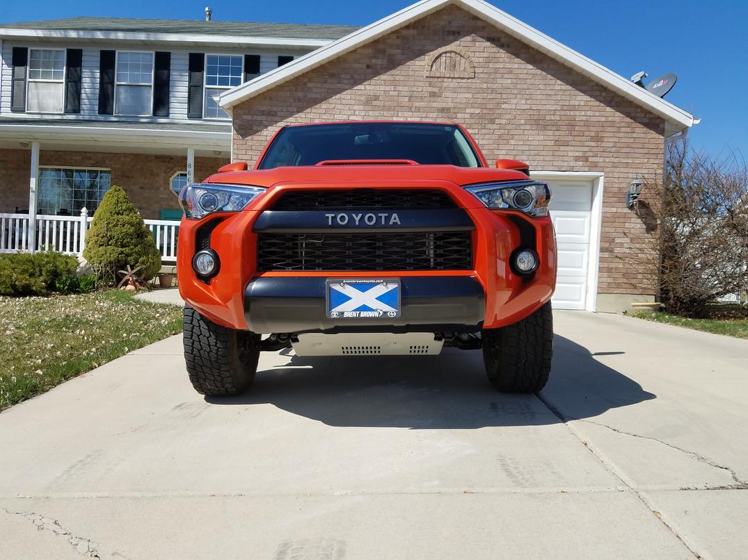

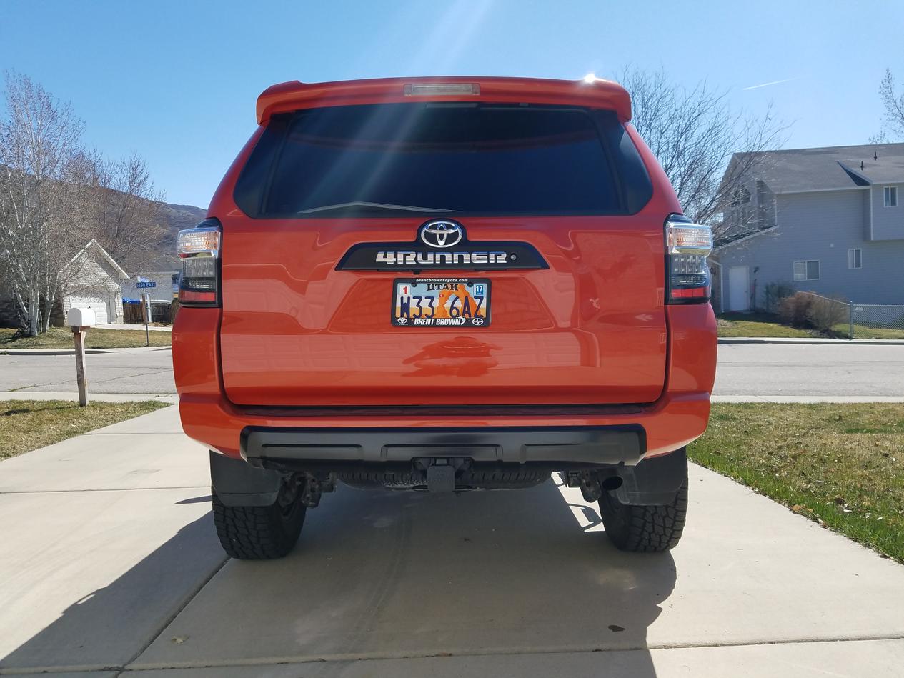

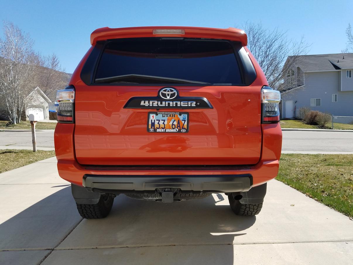

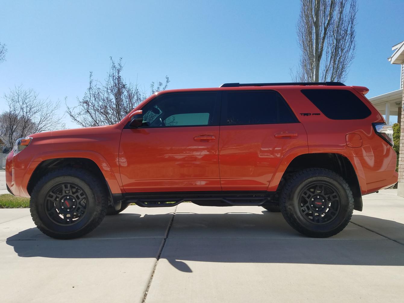

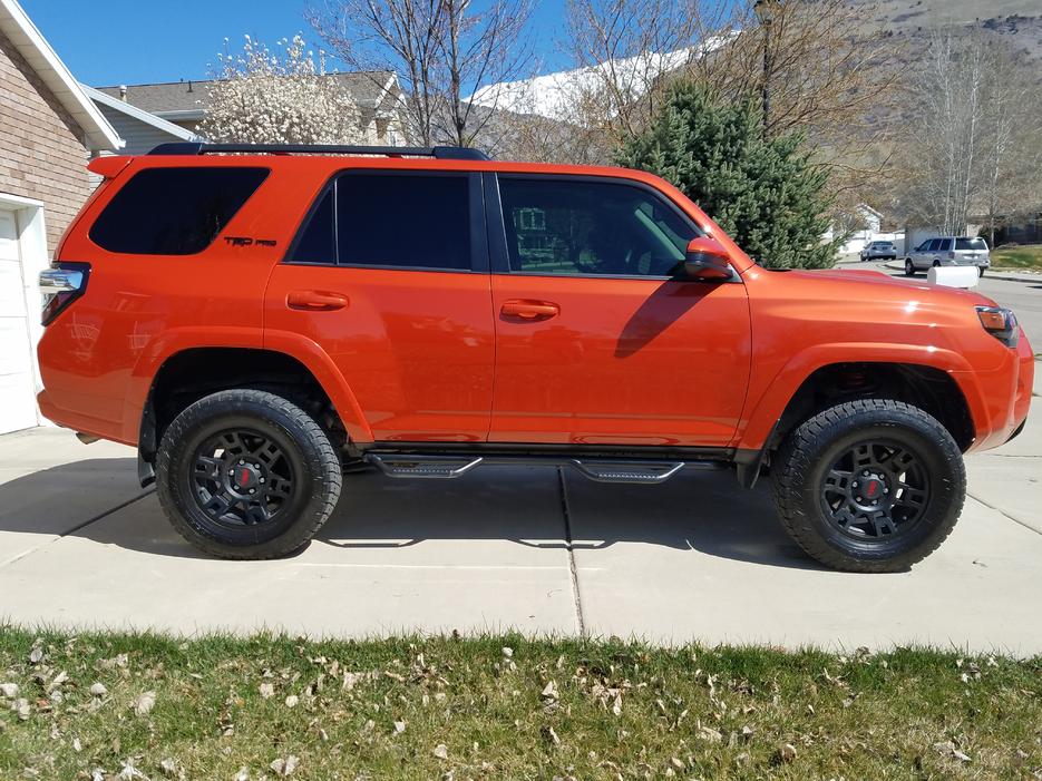

Lift and Wheel Spacers Installed.
Here are some comparison shots I took. Same, stock tires in both pictures. I'm getting some rubbing when I back up while fully turning the wheel so I may have to get rid of the spacers. But I love it. I think it looks like it should always have looked.

Looks awesome. Stock tires look fine for now. I just cant justify trading out tires with 15K miles yet. I am worried about my spacers as well. I get a rub at full lock now and I have trimmed the heck out of the front of the wheel well and removed the front mud flaps. We'll see once it gets installed on the 4th.
Question: did you do the 2" toytec springs in the rear? I went with the 1.5 SAW's.

I did do the 2 inch in the rear. Got rid of my spacers. Too much rubbing and it was on the front bumper. Now for new tires. The stock ones look ok but I definitely want bigger and quick. Haha.

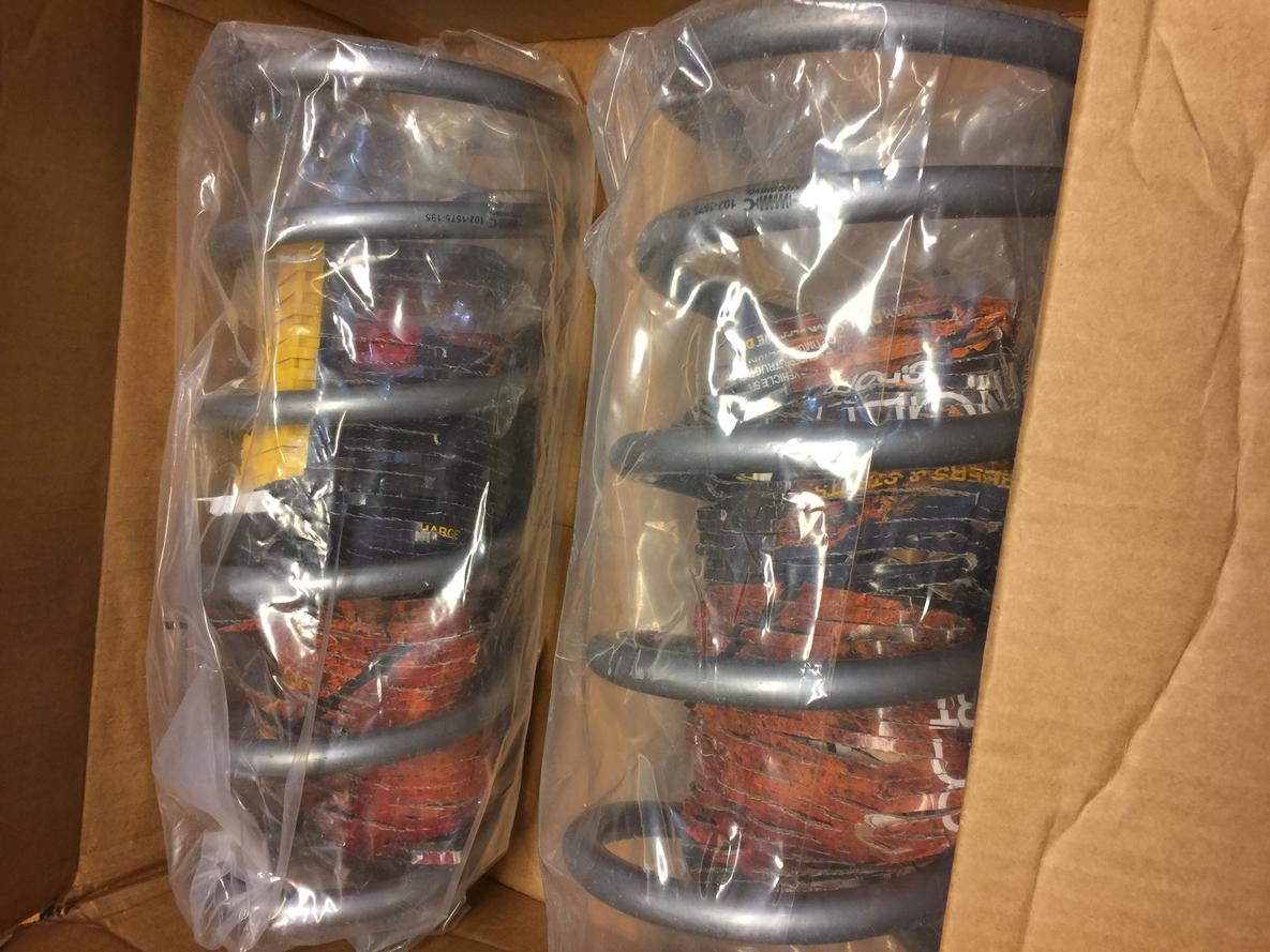

Can someone confirm that these are the stock rear TRD springs. - Thanks!
