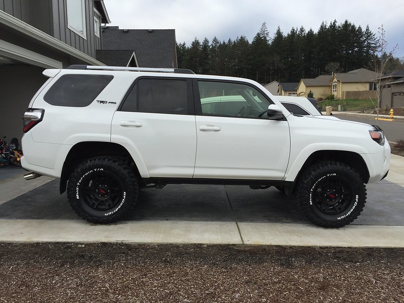

I like the white walls out on that. Been thinking about doing it myself when I need tires. How do you like the new All terrains from bfg. How many miles on them so far? Are they stiff?

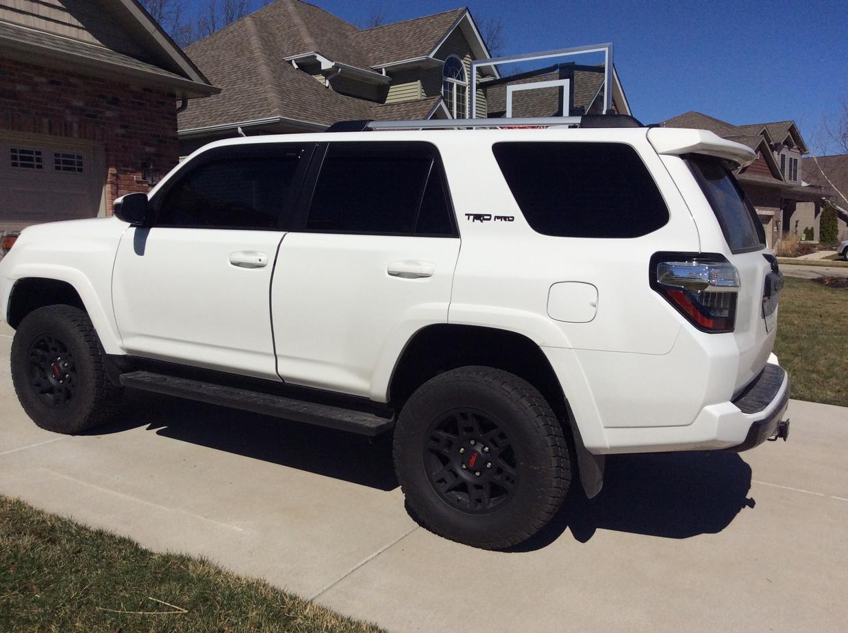

I forgot to post up after my lift install last month. Really digging this setup now!!
I also got a great deal on the install at a local off road shop ($270) and then another $104 for an alignment at another shop. As others have stated, I'm noticing less front end diving on hard braking, and it drives like a dream! I haven't been able to sell the stock Nittos, so will keep them and upgrade later to BFG KO 275.
If you have a TRD-P; GET THIS KIT!!
** apologies for the ipad pic and the fact my driver'side door is slightly ajar....

How does it ride when going fast over speed bumps? How does it affect the ride then?

I can't really attest to going over speed bumps? I don't recall going over any as of late since the lift install.
The ride is just as wonderful as it was prior. I have ZERO regrets with this lift.
And no TRD front end clunk, but I must say I did not experience the clunk prior to the install and I'm in a cold weather climate when I took delivery in December.
I have noticed that when going fast over large enough speed bumps the front does get a tiny bit of air. Certainly no where near bottoming out on the downward swing though.
The lift pushes or holds the suspension down farther than stock thus shortening its amount of downward travel.
By the same token upward travel is increased from the stock position since the suspension is already standing on-its-toes so to speak.
That's not to say that there is more travel available due to the lift, only that the kit changes where the suspension sits at rest within the same, original amount of total travel.
Stock probably keeps the suspension closer to the middle of it's total travel distance where-as the kit keeps the suspension at rest closer to the lower travel limit.
It's always a compromise...
