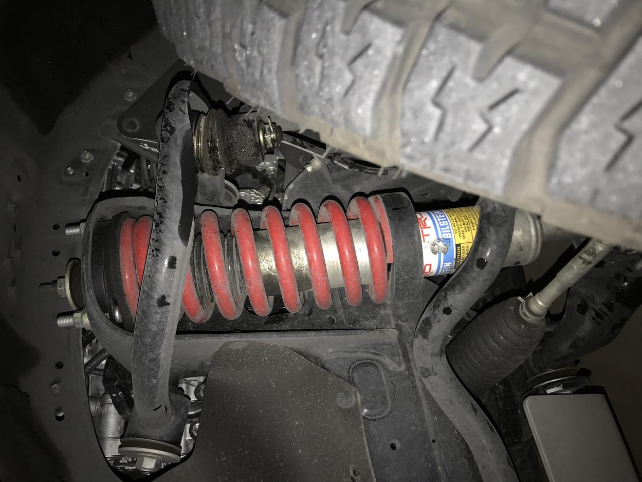

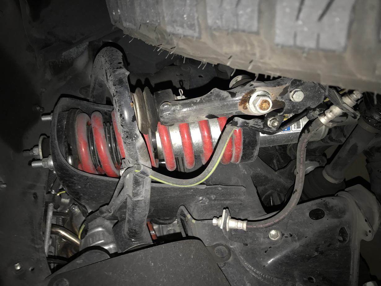

I posted pics of the front with the kit installed. I have stock tires and i am measuring ground to fender flares bottom tip.
