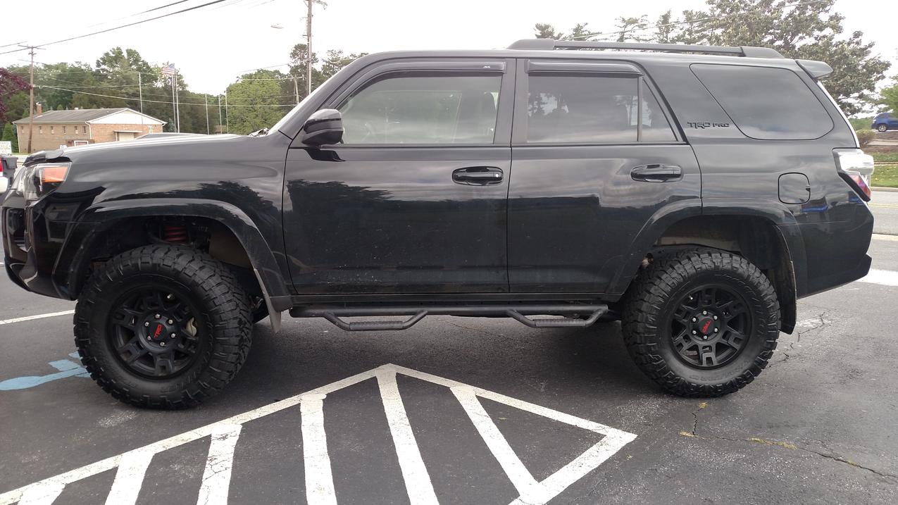

Did this a couple months back. This was taken the following day. I do believe it has settled a little bit since. I did ¾" toytec spacer up front and OME 998's for the rear. Definitely a stiffer ride but does not sag or come down hard on the trail with a full load and a full tank now. Tires are next to fill it out.
Do you still have the stock TRD Pro suspension? You should be planning on 35's to fill that gaping hole! I would be concerned with how high the ride height is in the rear if you're still using stock shocks. Have you taken any measurements for uptravel/downtravel of the rear suspension after the new springs?
Same shocks. All around. I'm not too concerned with the increase in the rear, I also was not planning on having it be so tall with the new springs originally either. All trial and error for me with the truck. No measurements either with the new set up

I just picked my TRD-Pro up from the shop. I had the 2" lift kit from Toytech installed. I also ditched the Nitto Grapplers for BFG KO2"s 285-70-17. Here we go. I love it, perfect height, i now have to give my GF a boost to get in. This lift has provided a different viewing experience before we go somewhere. The front end diving when breaking has really improved after this kit. Truck doesnt dive as much. The ride quality has improved believe it or not. Also no tire rubbing at all. I love my 4runner even more. Love the height and look. Also Toytech is an excellent company to do business with!! Ill try to post pics soon.

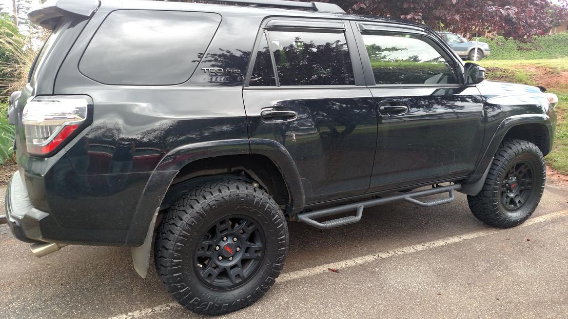

Lifted my 2016 TRD Pro today
New member here. Just had my ToyTech 2" lift installed today. Went on perfectly. No Spacers needed. Went with Nitto Terra Grappler G2's 275 70 R17. No rubbing at all! Also had the diff lowering kit installed at the recommendation of ToyTech staff. The shop is recommending that I get a new upgraded upper control arm to help get the alignment and camber perfect. Also should help make ride better. Only driven it about 10 miles so far but ride is fine...definitely can feel a bit stiffer in the rear but its fine. sits niceand high now and the tires went right on the stock TRD PRO wheels...very happy...

TRDP Toytec Lift with new 285's
Waited on the crappy factory Nittos to wear out.
