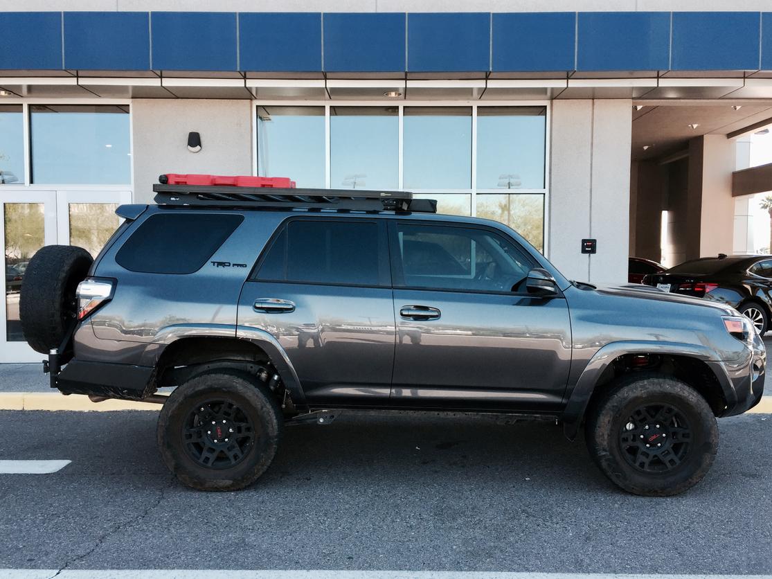

1" Front Lift for BAJA TRD Tacoma's, TRD Pro Edition Tacoma and 4Runner Installed.
Looking good! Do Thu happen to have the measurement? I got the whole 2" kit, debating on if I should used the same part to just level it until I get new tires in the future.
That looks great, my kit arrived Thursday after I got my new wheels on I was on the fence on weather or not I was going to do it. Your pic may have sealed the deal for me to proceed. How did it effect the ride quality?

Thanks!This was taken today after i filled it up with gas. Hope that helps you decide. I see that you're from Elk Grove CA. Im in EG to right by Hal Bartholomew Sports Park. If you wanna check the truck just PM me.
Thanks! No effect on the ride quality. One thing i noticed after the lift is nose dive when braking was reduced.

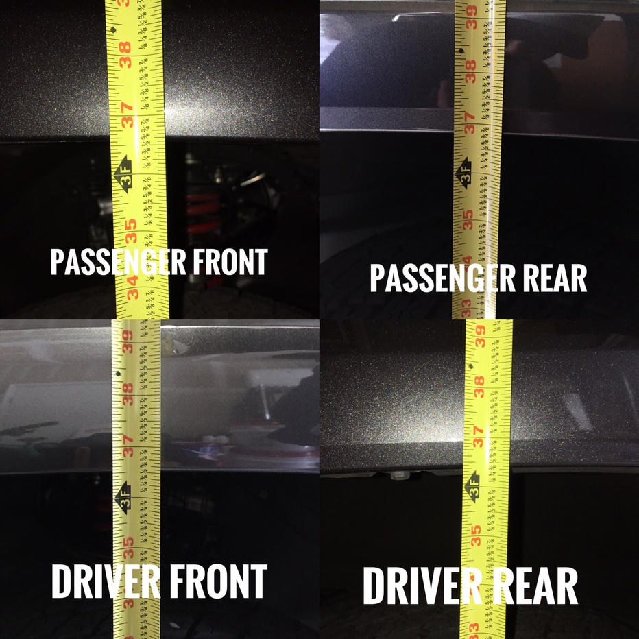

Man, this is closer to level than I thought. Was thinking I'd see 1/4 difference. In the first pic of the Inferno, it looks reverse raked to me. Now I'm back on the fence.
I just called Toytec tech support and asked about the 1" coil perch lift vs the 3/4" top spacer lift and he (Justin) recommended the 1" all the way. Said it wouldn't reverse rake the truck. Said the 3/4 really works out to about 1/2".

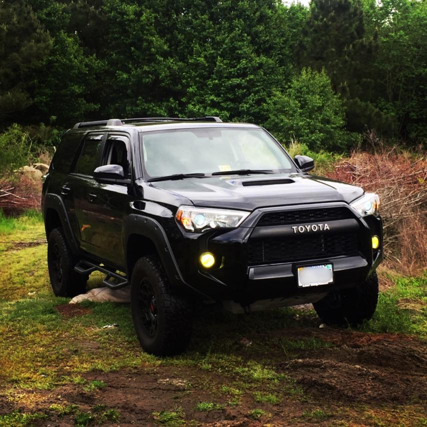

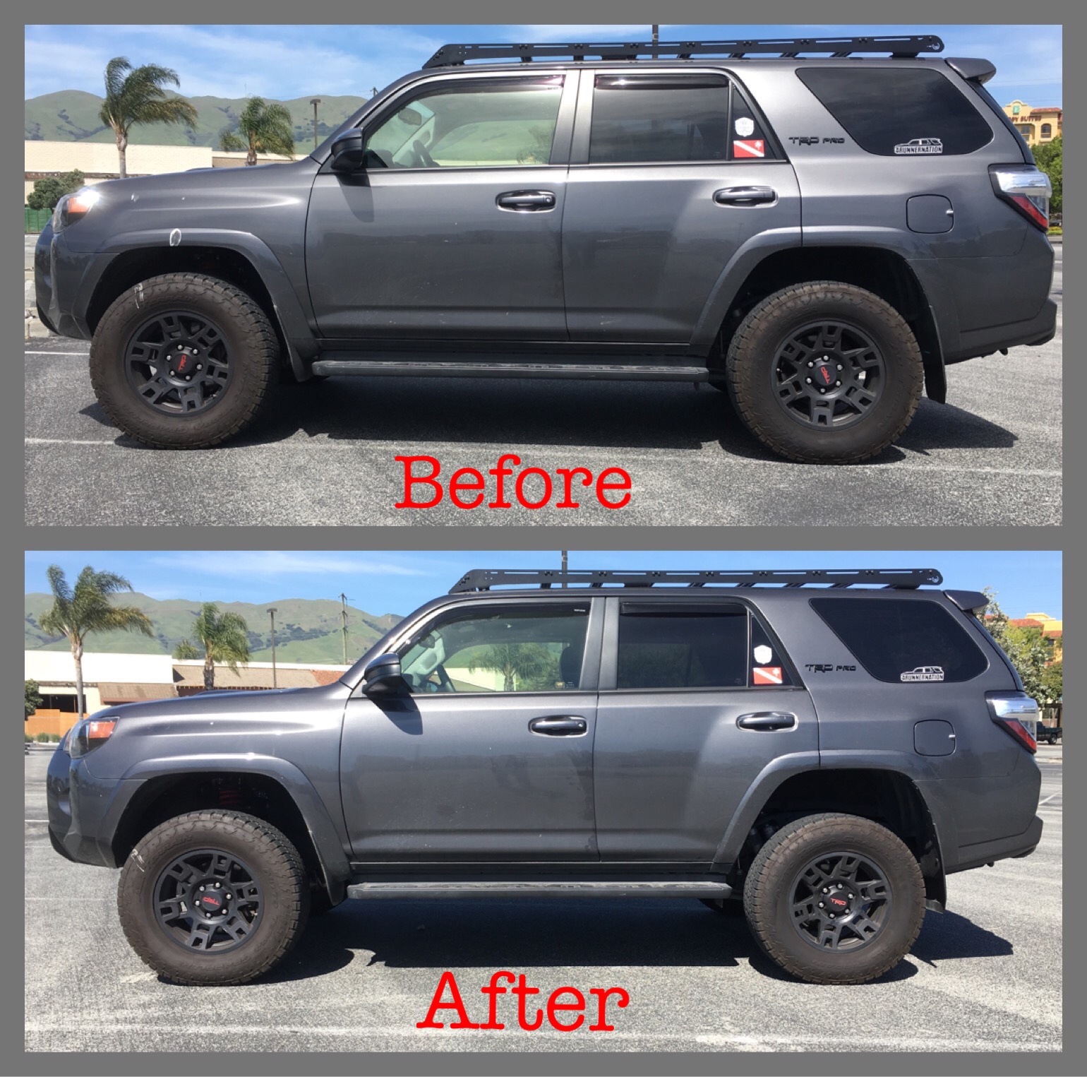

I've been running my pro with just the 1" botttom spring perch for awhile now. It levels out the rig, doesn't cause a reverse rake as long as the rear isn't heavily loaded, and I have had no decernable difference in ride quality on or off road. Here's a shot right after install and then another couple of shots after I put on 275 KO2s
Looks good with the 275s!

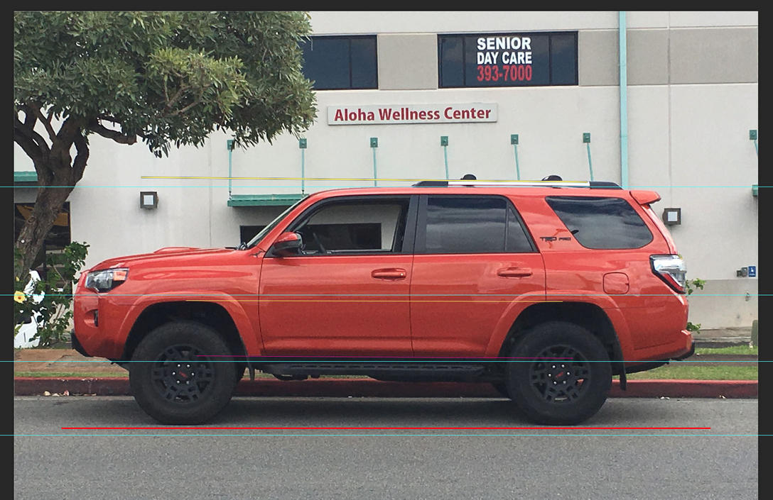

Sorry to use your image as an example, but it's one of the straighter-on views I've seen...
I've always thought that if you create the exact same amount of space in the fender wells, that the vehicle looks a bit reverse-raked. I leveled your image to the bottom of the tires, and then drew lines to the various 'lines' of the vehicle. Just my personal opinion, but when my eye gauges rake, it seems to gravitate toward the longest straight line of the vehicle, i.e. between the two wheels where the running boards are installed. Anyway, based upon this particular line, the truck looks like it's got a slight reverse-rake. I think the running boards being perfectly level is a sort of 'natural' litmus test, but everyone's mileage likely varies on what they consider 'level'.

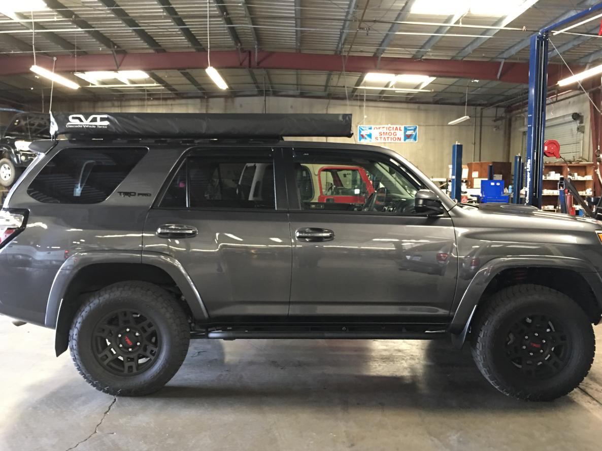

Did my lift yesterday. It's basically the TRD Pro Toytec lift but with Icon 2" rear springs that were gifted to me by a friend on here. So I only bought the front components. I have no more than 2" rake. Pretty much same as factory when I did the before and after measurements. The rear feels way more stable though with the new springs. I'm pretty happy with it but I think I'll go with 275s next. I already have the spidertrax spacers and I have no rubbing at all with the stock tires. We'll see with 275s but i already pushed the fender liner forward. Anyway here you go. Comment away.

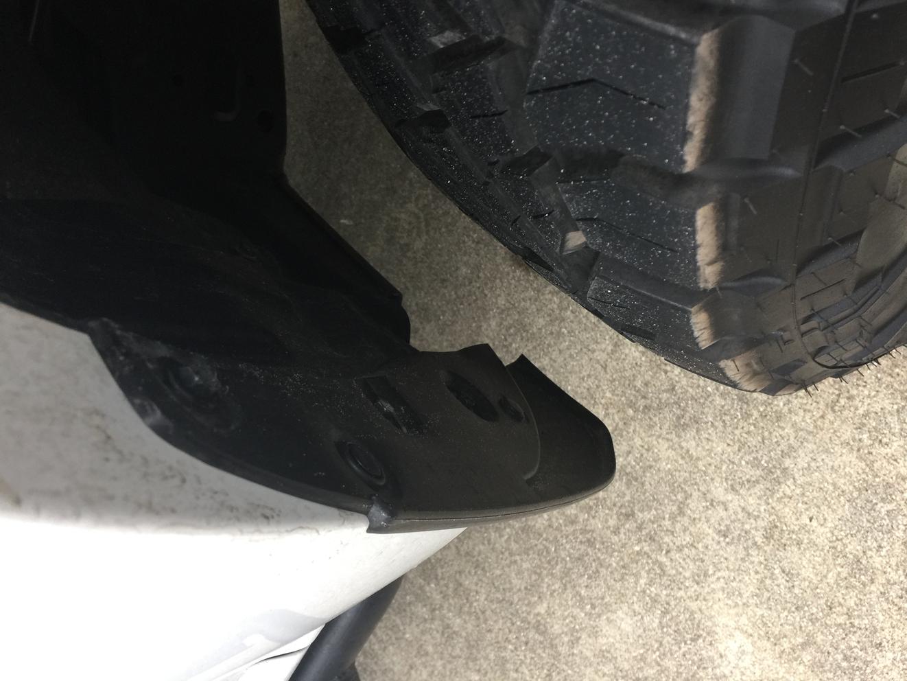

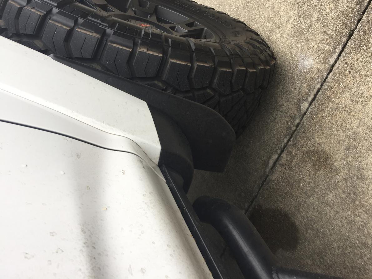

Do you guys think 285/70/17 KO2s would work with the 1" Toytec up front? Seems as though we have established that the 275s are golden even at stock height...just seeing if we can squeeze some more out of the setup.
I think so, with no spacers and you will have to mod you mud flaps. I didn't like the heat gun trick and went with half flaps.
