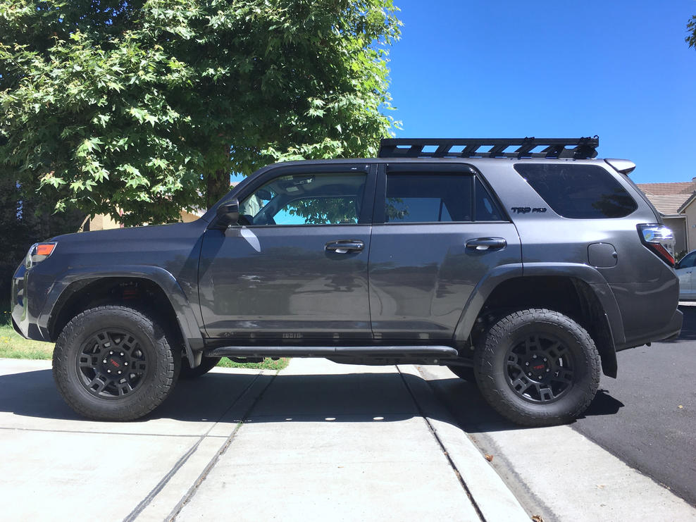

Toytec 2" lift kit with Dobinsons C59-505 - Stock rear end load, 1.25 to 1.5" lift. 405/405mm, 17mm wire, 220LB **NEW COIL** @ Dobinsons Mike.

So you just used the toy tech for the front and the Dobinsons in the rear instead of the super flex?

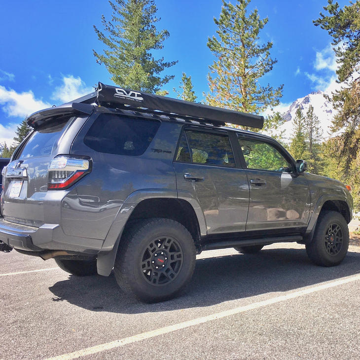

I never had any rubbing on 285/70/R17 w/the Toytec kit...the only concern I had at the time on 285/70 was the rim width on TRP rims but for me no worries at all in my experience and many others ...it's a nice stance
Did you have spacers too?
With or without mudflaps?

Only the front spacer that comes with the kit.
No mud flaps either
