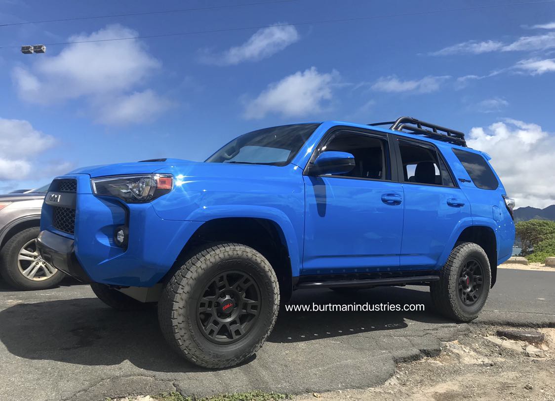

We did a 2/1 on that 2019 Pro in the pics. Order here:

Way too much negative rake with the 2/1 Need at least 1.5" in the back if going 2" up front.
Cool. And that's another reason we do any custom size you can think of. But some people still want some rake, many travel and put people in the back seats, or have the cargo area loaded, or tow, etc, so then it's riding level when loaded and not sagging in the back. The best part is, I can have it made in any size to fine tune the exact look someone may want. But I do sell a lot of the 2/1.5 also.
