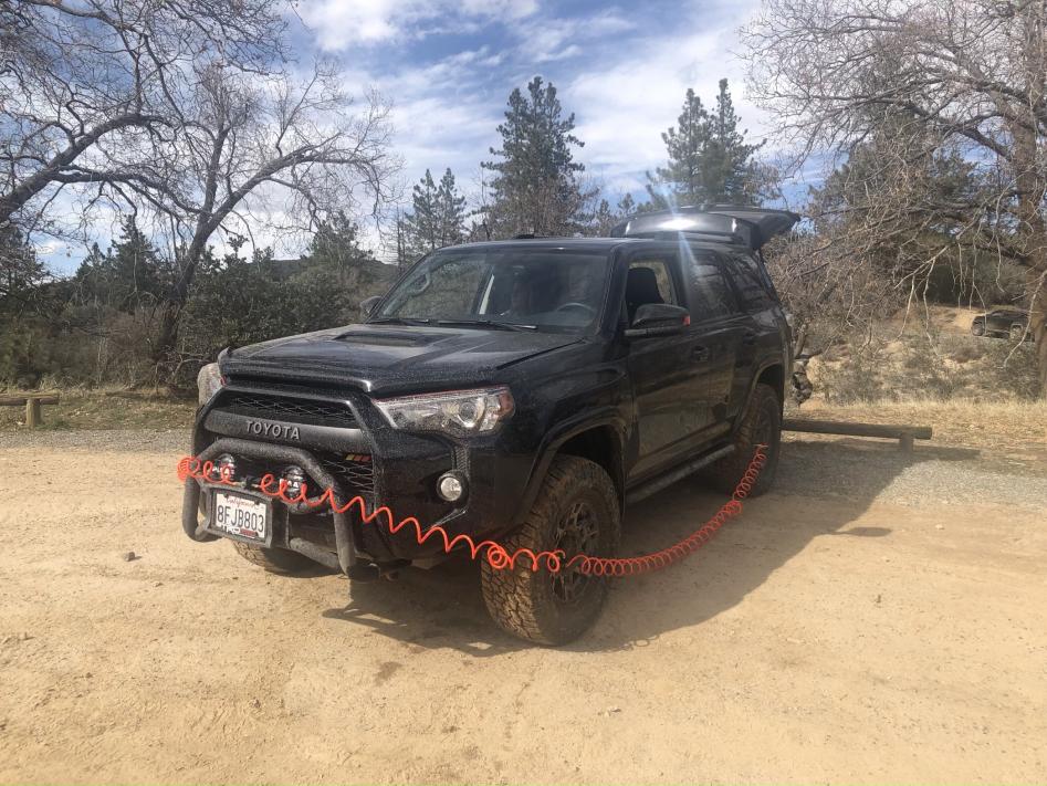

My 285/70-17 is pretty tight. I was thinking the same thing with inflation of the spare.
I have my ARB compressor and SponsoredByWifey inflation kit sitting in my garage ready to install. Once I have everything installed, I plan to attempt to fit a 315 in there or at least something larger than the stock one I currently have.
I thought that was a joke and it was approved by the wife. Lol. I looked it up. That’s pretty cool. I have a poor man’s arrangement with a cheap compressor and a 4 tire inflate/deflator from Speedflate. It works good though.
