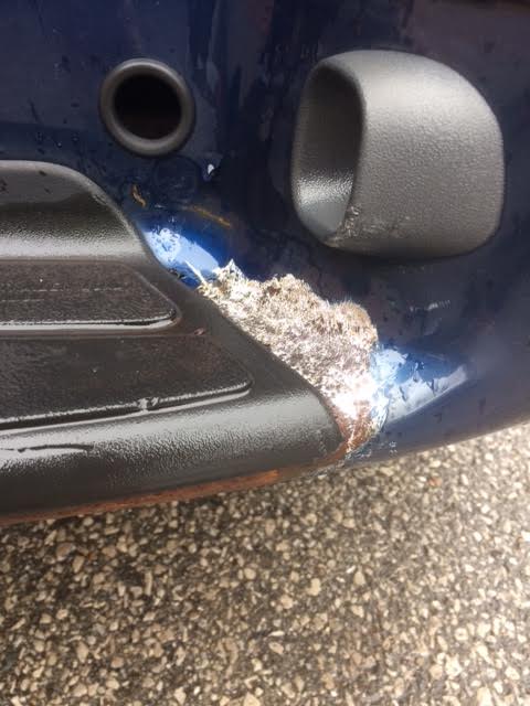

So I've got a question for everyone. I've had any and all body rust repaired properly over the last few months, including a complete rear hatch, only to find out that we are going to (ahem) "need another big vehicle". So gotta get rid of my Gen 4 Sport that I've been working on building. I literally just put the FJ springs and adjustable Bilstein 5100's in LAST WEEK! I love my wife. Anyway! My question really comes down to this. Would you guys rather know that the rear axle and frame are solid, but come spring need a good wire brush and paint, or would you rather see it painted now? I hate the idea of just spraying the underside so it looks pretty, because it's so darn hard to find a good condition Gen 4 T4R in western NY because of all of the stinking salt in winter. Thanks and let it fly!

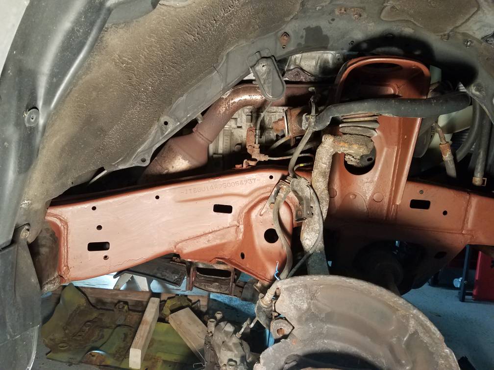

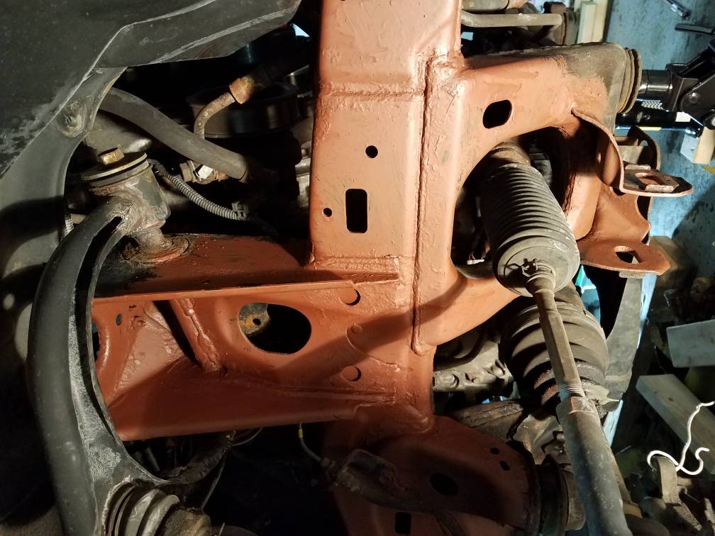

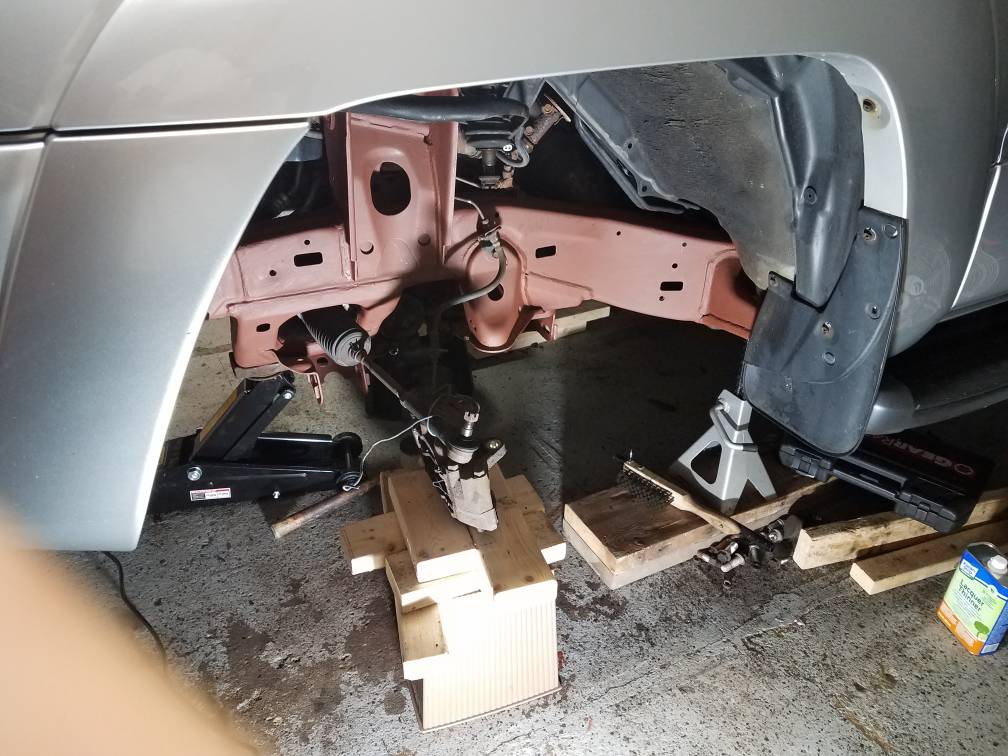

Here's what I did while replacing my front suspension stuff. 20170225_224430.jpg20170220_085512.jpg20170220_085443.jpg

I've never used Fluid Film here in Colorado, but it seems like a good product. The Por15 would work underneath to prevent the gravel sandblasting effect on leading edges. We always get surface rust underneath because the gravel used in winter has a sandblaster effect on the chassis paint. The beauty of the western states regarding rust is the lack of humidity. The roads of course are salted heavily when it snows, but one day later the humidity drops to 10% and all that moisture built up underneath gets sucked right out by airflow. There's no lingering moisture to keep working away at the metal, there isn't a constant freeze/thaw cycle day after day month after month.

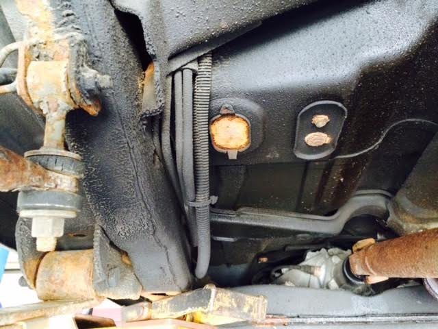

GMC was previously oil undercoated for 12 years straight...product brand ?...and only has a few bad spots / so oil spray works.
- on the easy spots to undercoat, it has served this vehicle very well
- even the original brake & fuel lines, are caked like grease

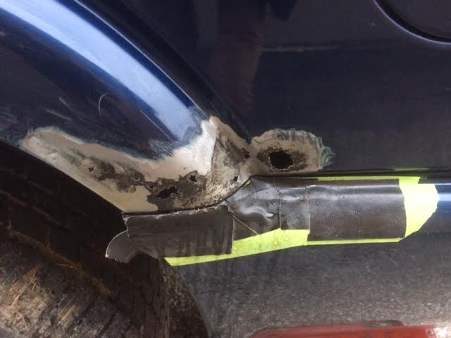

- the rear left quarter area, now rusting from the inside-out...a hidden area, obviously missed of oil coverage, during undercoating
- after a mild etching, the dark colored metal is only half thickness (rust under paint area)...and will be removed
Now requiring rust holes be cut & enlarged, back to solid metal / and a steel patch be welded in or adhesive bonded.
Note - Gorlilla duck tape is good at protecting painted areas some, from wire wheel abrasions (on an electric drill).
Portions of the rear steel bumper was heavily corroded, and will be de-rusted prior to neutralized with a phos coating.

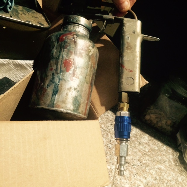

What oil spray product did you use for the Jimmy? What is in that sprayer pic you've posted?
