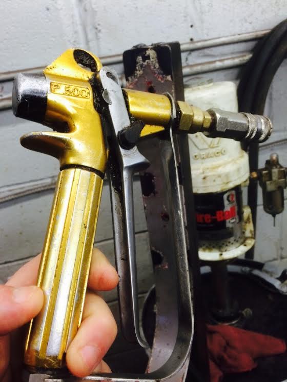

What oil spray product did you use for the Jimmy? What is in that sprayer pic you've posted?
From Earlier Post:
The old spray gun (pictured above), is one I made up for spot undercoating & spraying steel brake lines.
Jimmy was a purchase off a flipper friend, from the original owner.
- senior 70 y/o guy, bought 2005 GMC new and had oil sprayed, every fall.
- why the exterior body plus frame & floor, was still solid
- former undercoat brand is unknown

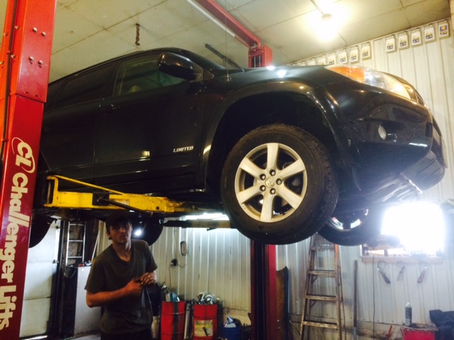

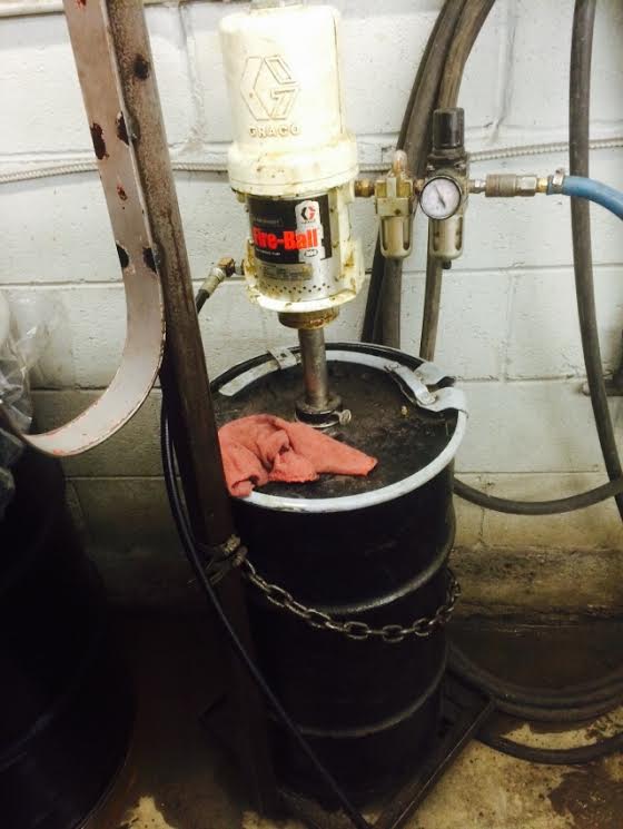

While I use a wax-oil (Fluid Film or similar), and have it applied using a 2 post lift.
- proper spray equipment system (w/wands) costs, approx. $3,000
- using a hydraulic pump, to keep oil mist/fog at a minimum, less product waste & better oil yield
- commercial undercoat gun (as pictured), are around $500
