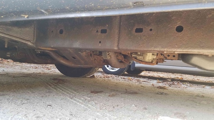

I scaled the frame and blew the sand out of the inside of it (lots). While scaling I found a couple spots that were no longer metal so welded some new steel in. Then it went in for inspection and a Fluid Film bath. Hopefully it does the job.

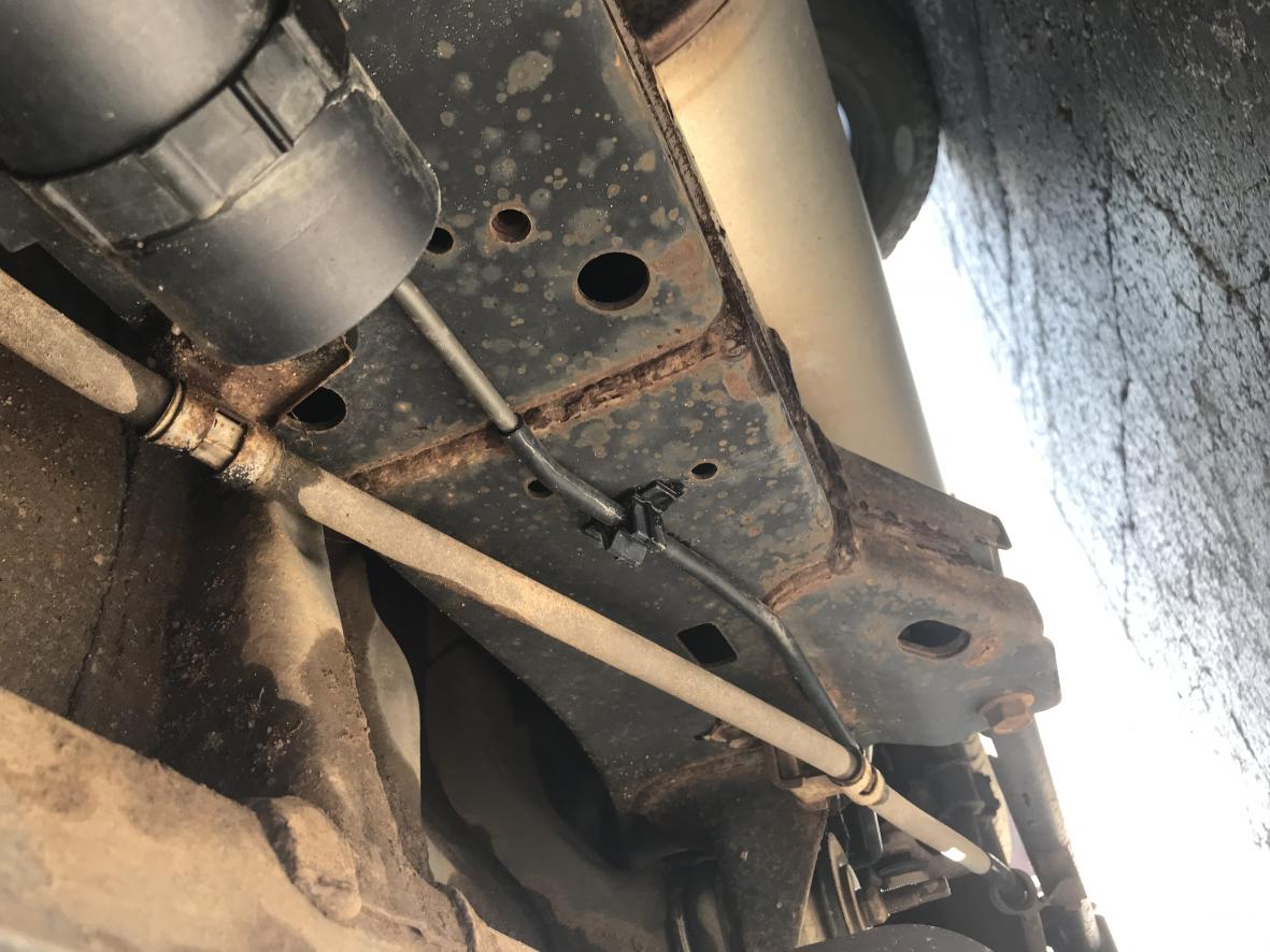

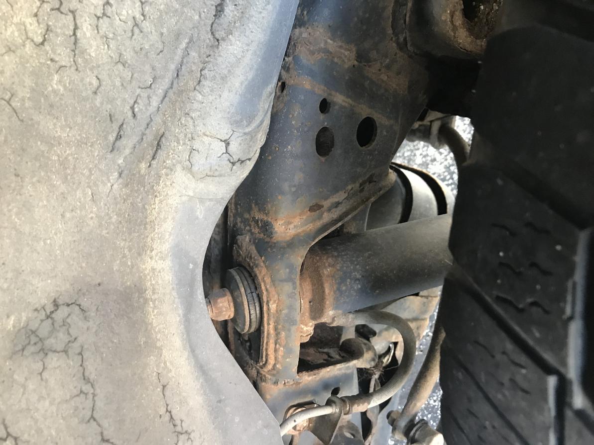

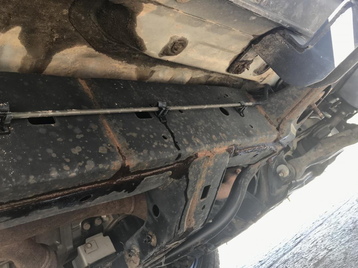

Apologies for digging up an old post but I'm looking for some direction. I have an '08 that has a bit of surface rust. I have some shops quoted to clean it up/fluid film application it, but was looking for input first. Each seem to think very differently about what stage the rust is in and how to treat it. They are also all over the place on price. As I'm no expert, I'm looking for opinions on what route to go. I want to keep this vehicle for a long time so will do whatever is necessary to treat and prevent it correctly. (Also some spots are wet in the images sorry)
First shop wants to just apply fluid film over a two hour period and call it done for about $200
Second shop cleans the frame and underside-dries overnight-spray fluid film throughout entire underside in and out of frame etc for a day and letting dry overnight for $500
Third shop cleans frame and underside then wire brushes off existing rust and hand-applies 'rust resistant' paint. Then after paint dries they apply fluid film to the entire underside of the 4Runner. Costs about $800 - $1200
Appreciate any insight
From what I can see yours looks pretty decent but you need to check some other areas. Check the front cross bar where the recovery points are. Check under the AC drain hose and think about rerouting it as mentioned in another thread here. Also check the horizontal flat areas about where your feet are when inside the car. IMO, the biggest thing is to make sure the inside of the frame is oiled well as all of the holes I have repaired rusted from the inside out. That last picture was the fluid film job on my car after I cleaned the frame, it was all gone after the winter so I am no longer going to waste my money on that product. I have heard ATF or bar&chain oil works better where the latter is super sticky. I already brushed on the b&c oil in the middle sections to see how it holds up. I plan on heating b&c oil up and spraying it inside my frame soon.

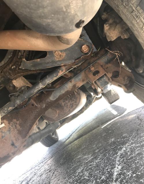

I'm hoping someone can help me find a solution to the frame on my '03 V8.
Some backstory: For all practical purposes, this is my "pet project" vehicle. I have replaced and upgraded many parts (engine components, new fluid lines, suspension upgrade, etc), all in my garage. I have no intention of ever selling the truck, as I have a lot of time and money invested in keeping it running as long as possible.
With it being an older vehicle in Wisconsin, there is surface rust present, but the frame overall is solid.
The issue is with one section of the frame, located behind the passenger side wheel well. Here's two images (one top-down and one underside) of the affected area:
IMG_20200928_224458055.jpg - Google Drive
IMG_20200928_224511898.jpg - Google Drive
What appears to have happened is a condensation line had been incorrectly routed to where there was a constant source of moisture on that segment of the frame, leading to it rusting through. I will re-route the line and I had intentions of cleaning and coating the underside of the whole truck myself to halt rust development, but after the extent of the damage became apparent (this past winter) I have put the project on hold as I explore options. I'd like to get the frame solid and then I'll seal it to stave off an entire frame swap.
I'm wondering if the Safe T Cap I purchased from autorust.com will be able to be installed and give more structural integrity to the truck's frame. Here is the product I have: Front Frame Section, V-8 Model (ART-200-R) Passenger side - autorust.com
I will eventually want to do a frame swap, but this is not in the cards for me at the moment- Right now I just want to improve the safety of the truck, and I would be very thankful for ya'lls opinion and expertise. If the cap and a patch or two isn't viable, is there a possibility of replacing the whole section? I'm not a welder, and this would be the first work I've really gone to a shop for my truck, so I greatly appreciate any help on this.

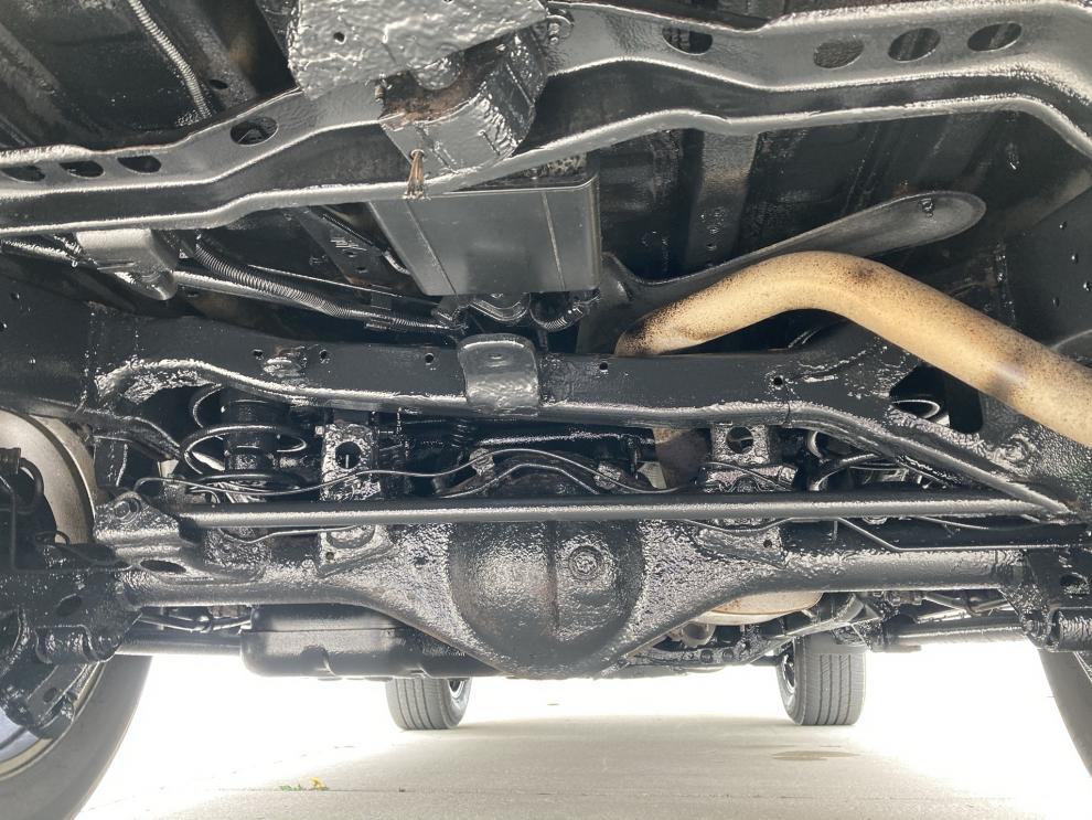

I took my ‘07 Ltd V8 for a Woolwax treatment today. I was very happy that I found no structural frame rust when I bought this 4Runner last month, just some rust at the welds. The cradle under the radiator and the rear bumper were pretty flaky but cleaned up enough to give me confidence they will last with this treatment applied.
I compared the frame’s condition to my buddy’s 2012 Tacoma and they were equal...even though his truck is 5 years newer with 100k less miles. And I am very happy with this product. Woolwax seems to be the answer to prolonging the life of my beloved ‘07. BTW, they had to cut the spare tire cable to remove it to spray that area. I tried to lower the spare yesterday but she was froze up solid. I bent the chintzy lowering tool and the lowering crank mechanism just wouldn’t budge. I’m just going to leave the spare in the garage. I have roadside assistance with my car insurance and will definitely use it should I be unfortunate enough to get a flat.
