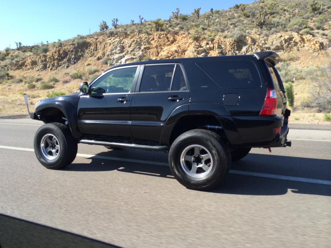

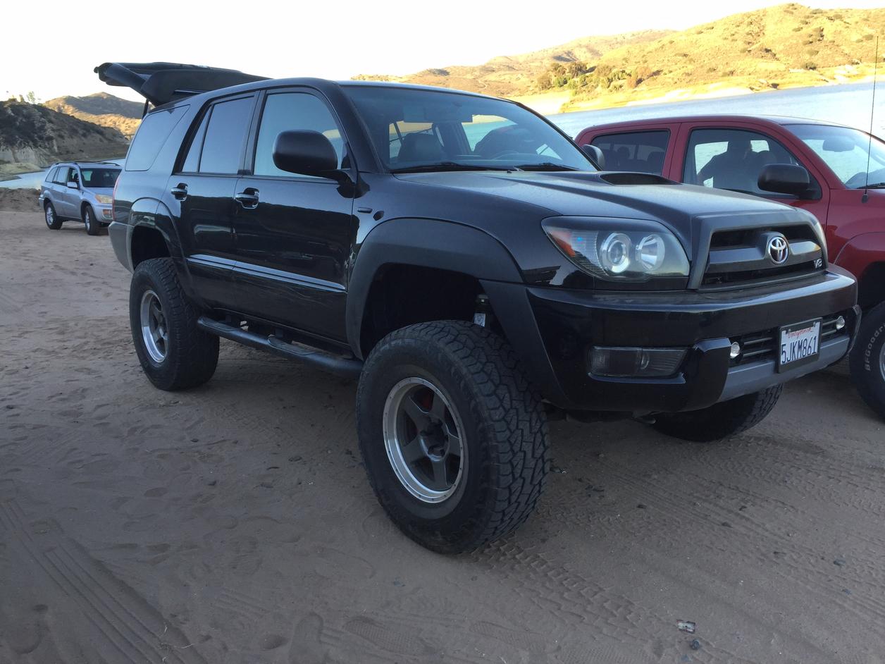

Truckhigh's 04 4runner Sport V8 RWD
I only have 80k right now and i beat on this thing when i need it. I'll post more pics as they come along.
Suspension
trd pro 6112 now-bilsteins 5100
td pro Bilstein 5160rear
3 in metal tech long travel springs
maxtrac 4in lift spindles
eBay uniball uca(every component replaced uniball's/bushing/spindle hardware)
had Light Racing UCA
4crawler 1.5 body lift
Prothane frt +rr sway bushing
diy rear swaybar link
moog inner/outer tie rods (rust extremely fast)
firestone rear airbags
moog ball joints
Energy suspension LCA bushings(removed due to squeaking)
Total chaos cam tab gussets
febest tsb-120 through tsb-125 body mount bushings
Wheels/ brakes
level 8 Punch 17x8.5 -6, 4.5 bs
315/70/17 Cooper At3
Frt + rr cross drilled and ceramic pads
centric ss brakelines
LROR extended brakelines
1.5 in rear wheel spacer
1 in front spacer
Engine
tru flow drop in filter or k&n cai
B&m oil cooler for power steering
denso iridium plugs
tb spacer
Pac SPR200 battery isolator
electronics
White dash light conversion
frt + rr cameras w/ 7in screen
pioneer radio
pac swix
pioneer components

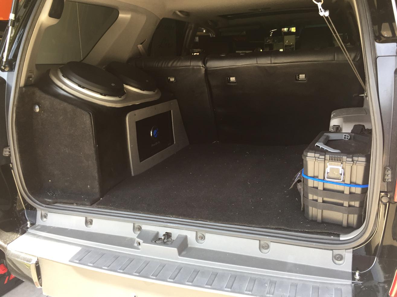

2 jl 12w6v2
Planet audio amp 5000(impressive amazon amp)
amazon led int kit
mdx roof ant
Pretty stuff
DIY front bumper 2 square tube plated
McNeil front fender flares
Clazzio Black seat covers
WT frt+rr Mats black
RAZO RA98GYT Shift Knob
black carpet
06 headlights and taillights
06 grill trimmed shaved
hid- Head,fog and driving lights
06 sport running board tubes(wifey needs them)
rr wiper delete
Ebay rear wing ( nice wing and paint failed 3 years later)
Roof rack delete
Broadway 400
hid 3k fog projector 4.3k low beam 6k oem fog
Jdm Astar 921 800 reverse bulbs
3 led dry reverse lights
20 led bar Amazon
Carbon wrapped door accent and pull
waiting to be installed
Diff lock
Dual batt
Compressor

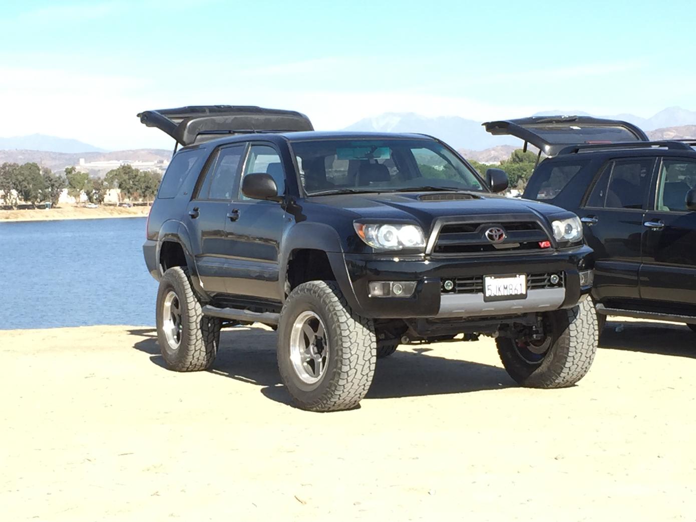

man thats a nice lift ,ordered my icon coilovers and have a lot left to do some nice trails, might have to take some ideas of your build:thumb3:

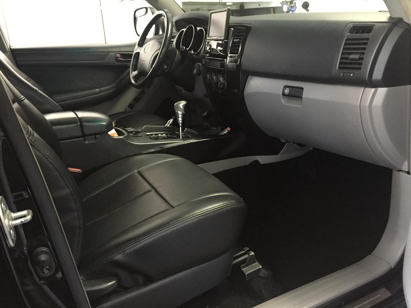

I just bought some Home Depot black carpet and trimmed to fit. It's only like $5 a foot by 60. I did my trunk too and il post pics later. There is a seam by front seat mount. But it was cheap and there wasn't any aftermarket companies yet. There is one now
03-09 Toyota 4Runner Carpet 4 Door, Passenger Area Only 2003, 2004, 2005, 2006, 2007, 2008, 2009
Yea I've seen that company and kinda just decided that for me that's money better spent on a winch or something.
Love how your truck sits man. It looks great!
By the way, can you snap some pics of how that home depot carpet ended up? Thanks

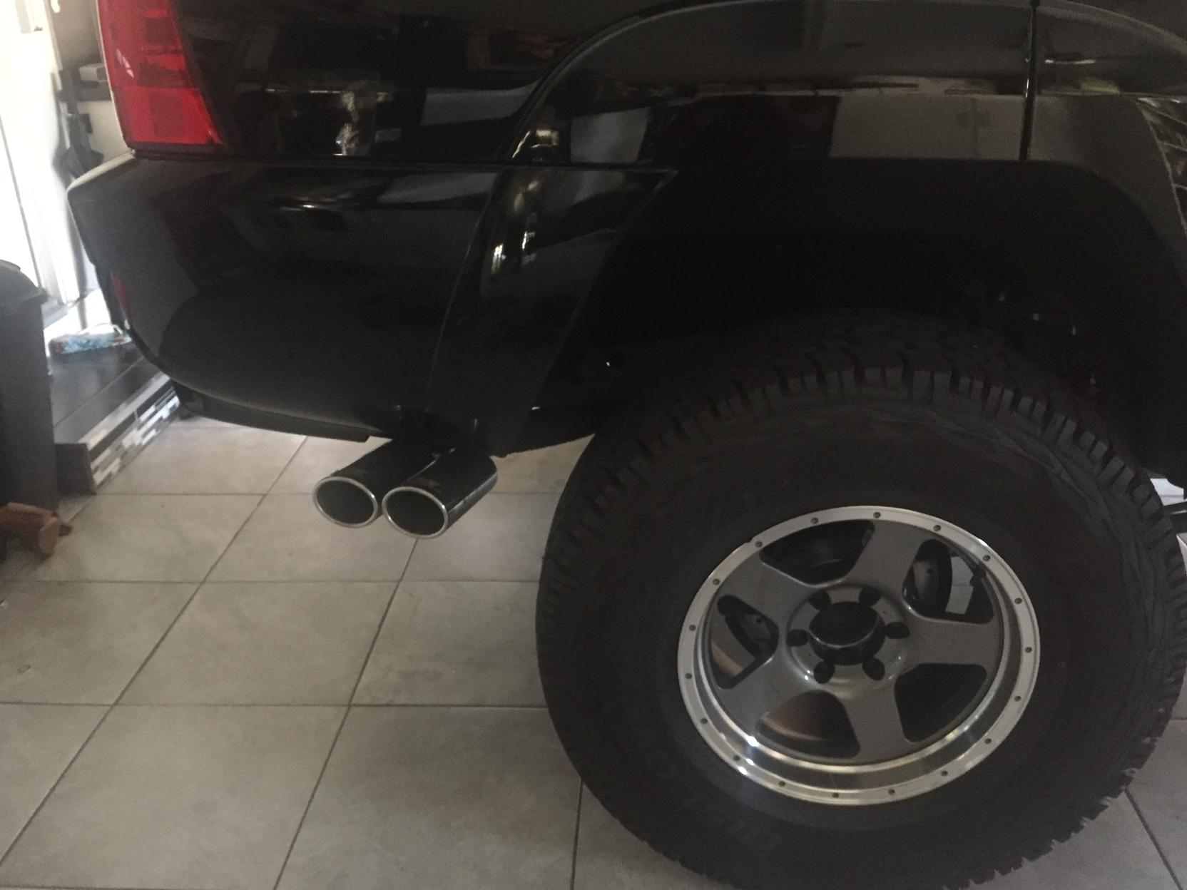

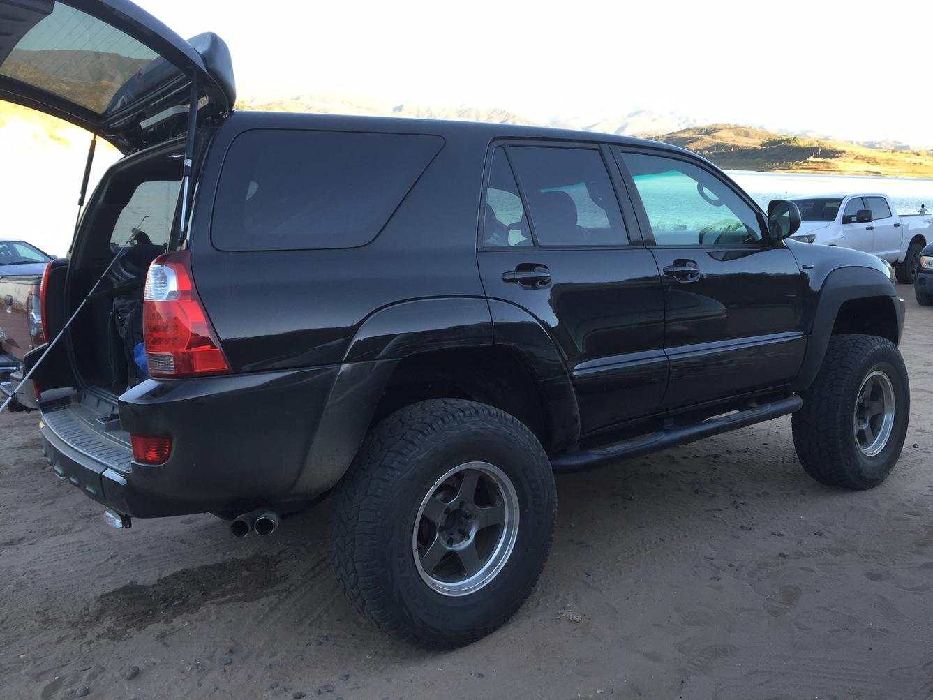

What is the exhaust? Didn't see it mentioned
I changed back to stock after my trd dual. I just recently changed the tip to try to get less fumes when I have my rear window open.
It's just a dc slant/dual/oval from Amazon welded on oem exhaust. All those raptor threads made me want a that raptor look. ��

The trd dual Y's after the muffler and was close to the pan hard bar. It also didn't look as good with the 1.5 body lift. It sounded good and it was a borla muffler
