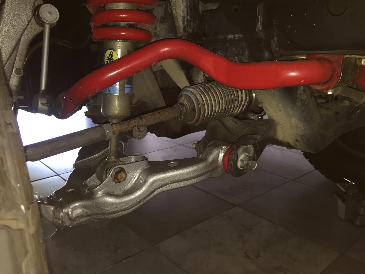

Just installed total chaos cam tab gussets, ES lca bushing and Tacoma springs. The cam tabs were worth it cause mine were bent and I would always knock it out of alignment when I went off road. The bushings were just time consuming and came out to about $100 for wire wheels propane and bushings. I was lucky I got them though when I pulled my Lca's down I could move the bushing with my hand. 4Runner is nice and tight in the front again
