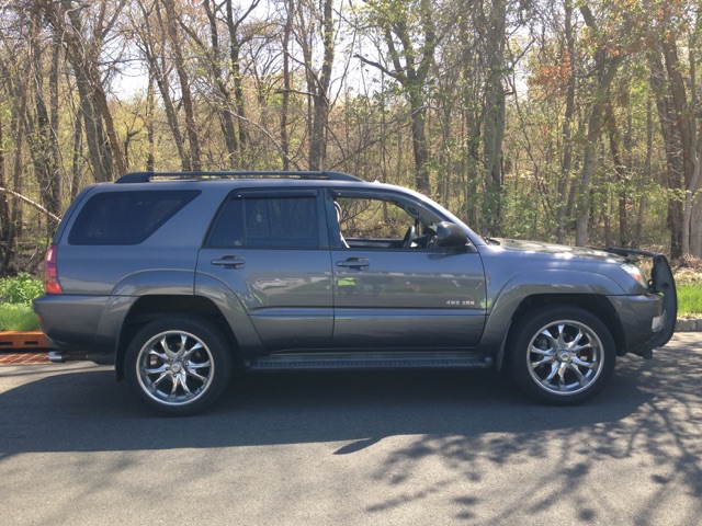

Taking a 2003 SR5 that has a chopped suspension and low profile wheels to a higher level...

Thanks for the reply ! The Runner only has 84K on her, It was either buy a new vehicle or put a couple of grand into this inherited Toy. Bumper stops definitely need to be replaced. Need to take off boots and inspect - before committing to C/V replacement. This is my first Toy suspension rebuild and I spoke to several Toyota owners (Tacoma and Tundra) that had shops do their work and they said there was no need to replace the CVs - Said that any thing under 3" did not need the extensions. Got new brake lines - Just in case.
Before the tear down
Springs were cut then spacers were added - What was my nephew thinking ??? My turn ! Gonna do it the right way !!

Your nephew hangs out with the wrong crowd. Bring him over here so he can see what a 4Runner is supposed to look like.
Young ones do before thinking - I'm thinking what I have to do - let out the beast within. Pictures will be posted after I tame this animal...
