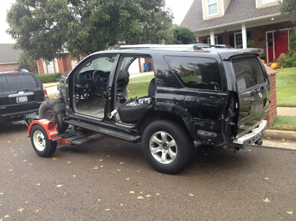

I Bought a Used One!
I needed a rear gate to replace the one on the SR5.
I bought the tail gate for $450 (It came with a few extra parts)
That's funny, I wound up buying a whole 4Runner for just the lift gate too haha. Lift gates are hard to come by for a decent price.
