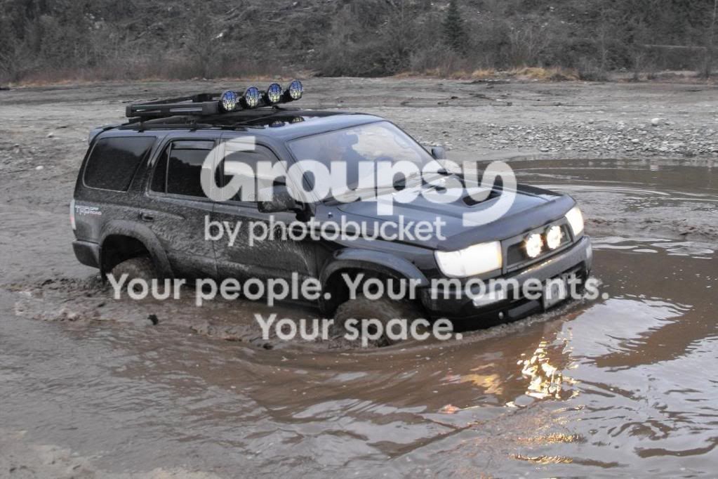

I went thru door deep water with the elocker locked and it didn't kill it...messed up some other stuff, but the elocker still works. Is there something about the retorfit maybe that made yours go out LINY?
You could source out a pair of e-lockers:nerd:
but then they'd stop working when you go through deep water like mine did :(
Stick with the ARBs lol :hatsoff:
I've hit up bottom of the door deep muddy water, clearly the motor on the 3rd member housing is submerged....went back and forth 3 times and still going!! Sorry to hear about yours LINY.
