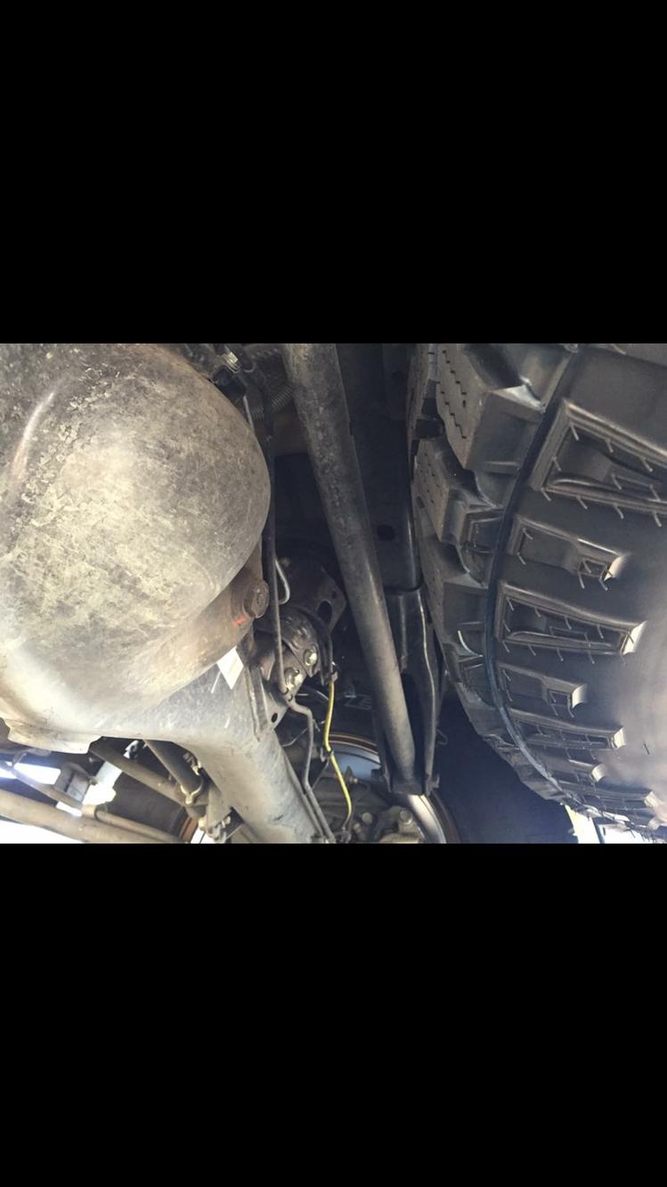

Trying to fit 275/70R17 spare
4OYOTER
It kinda fits, but not really. It won't fit on the curved spare "brace", so I have it wedged on the cross member that the curved brace is connected to. It's obviously very close to my panhard bar. Do y'all think this will be okay off-road? This is a 275/70R17 KO2 at 11/32 on a FJ steelie rim. The psi is at 45, I might try airing it down tomorrow and see if it fits any better.

On my Dodge truck, the summer spare tire is stored at zero psi. Only way it fits. I also have on board air.

I'd say it will probably be fine, if it's wedged in there tight and not moving then it shouldn't bump the panhard much as that will not wiggle side to side much.

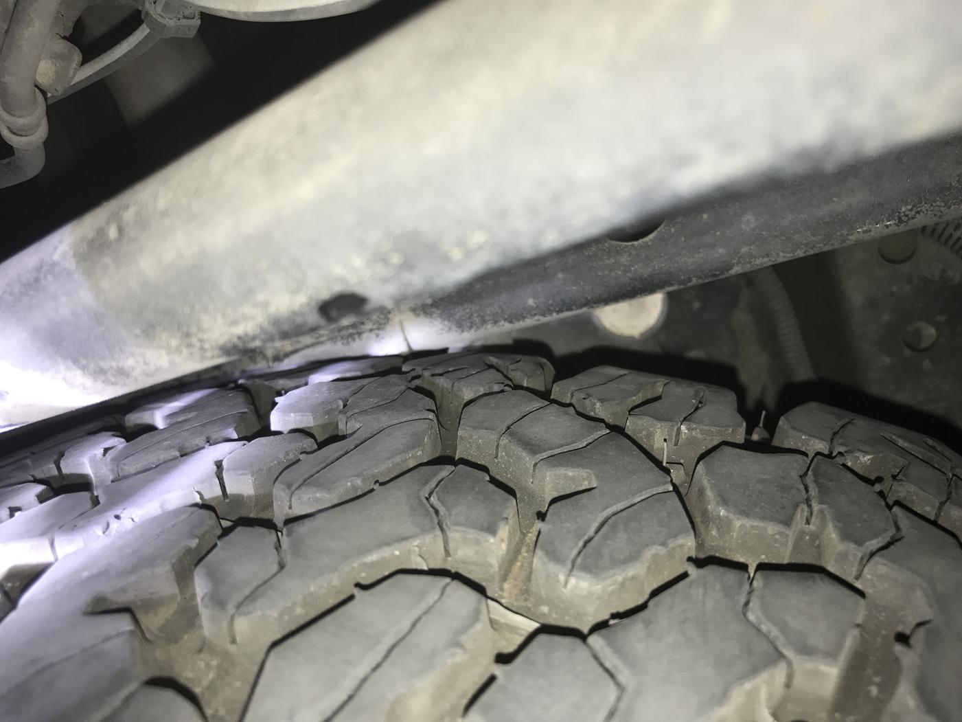

Did you pull the tire towards you while cranking it up? Ie towards the hitch? Have a 285/70/17 Duratrac in my spare location which tends to run larger and it still clears the oanhard bar by a good amount. You want to make sure the panhard bar can cycle freely.
This is a 285/70/17 Duratrac with still plenty of room for the panhard bar.

I have an 06 Limited V8, factory hitch, using a slightly used 255/75-17 @ 35 psi, on an OEM Tacoma alloy, as a spare, in the OEM location.
About 3/4 inch to spare to hit the pan hard. :confused:

The thing is I saw several people who had the V8 hitch get this size mounted. I am hoping once I get some wear it will fit. I think it is barely hitting and once it clears I will be able to snug get it in a better position. These tires were also alot bigger that I thought they would be. They are noticeably taller than my old 265/70s and with those I had about 3/4" to 1" clearance between spare and panhard bar.
I have a 275-70-17 KO2 Spare that has about 1/4 Tread left and I have about 1/8" Clearance to the Panhard Bar. Very Tight fit.
