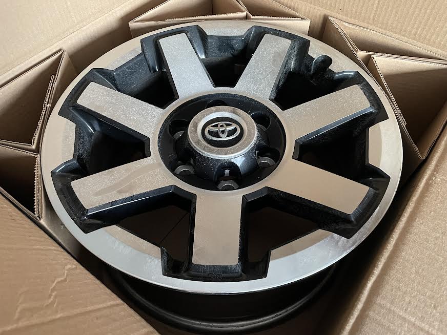

Found these locally, and they were so cheap I couldn't ignore them. Off a 2022, same bolt pattern, and only driven for one summer, so no salt damage at all. $250, all 4, with lug nuts. :cheer2:
They're 17's though.

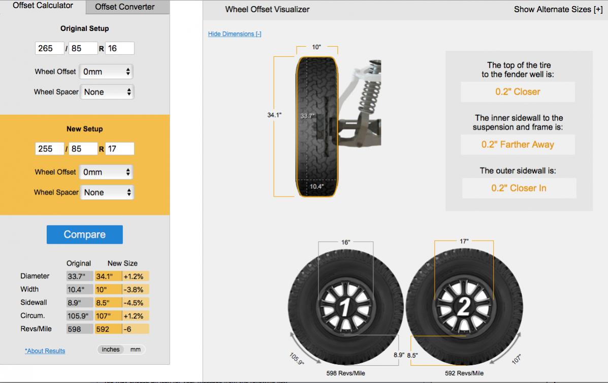

And below is a screenshot of the size comparison, current tire on the vehicle, to the Mickey Thomson.
The video also shows where he got rubbing on the inside rear of the wheel well, so I now have a visual understanding of where, which helps me picture how I'd resolve the rub, but I think this tire, will actually pull farther away, there, and the height, am I crazy? I don't think the height will impact me at all.
Am I on the right track? At this stage, I'm happy to deal with whatever the results are, but I think I can run this with no wheel spacers at all.

Just figured out how to measure wheel offset, and these 2022 4Runner stockers, are 124mm from mounting surface to inner rim edge.
Simply adding that data point.

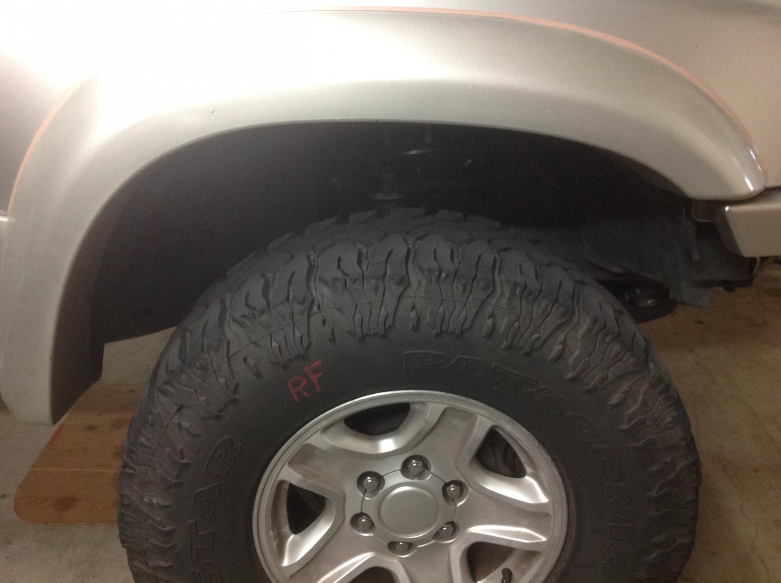

Changing wheels I wanted tires to be same location they came from.
I marked them with a enamel paint pen so tire guy would know.
No precleaning a lite swipe with paint figured it'd wear off. 8 months later
Could barely tell a difference, it took comet short stiff bristle brush n elbow grease.
Alcohol precleaning doing it with purpose could get you some options.
