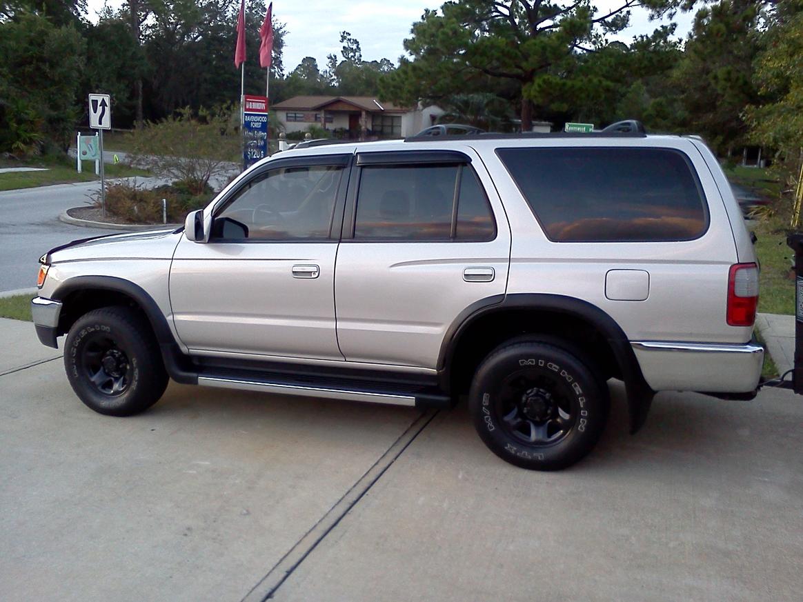

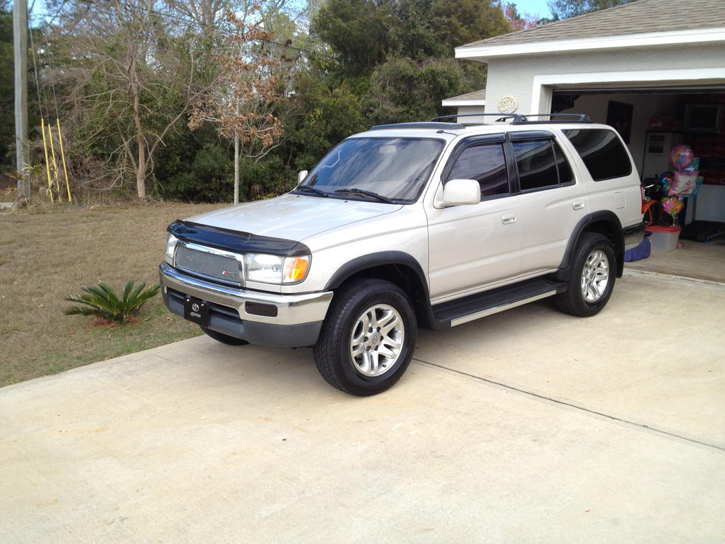

Thanks for the info, and heres the outcome. I am so happy I finally found a set of these wheels. Big difference!

the before looks almost like a low rider haha
the tundra rims are the only rims i love not painted black, im jelly aha
Looks muuuuuch better tho!
