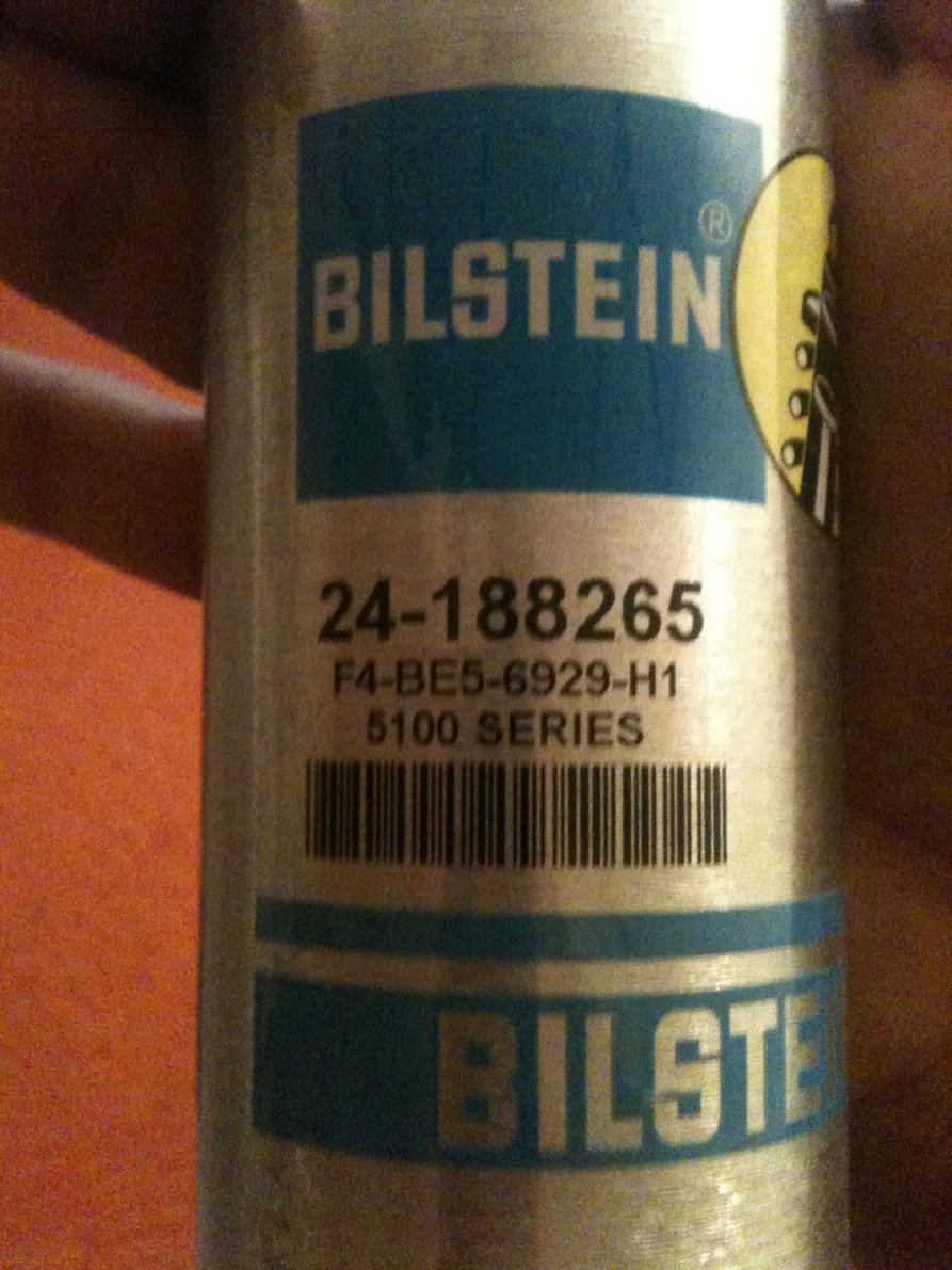

this is the part number
sorry so big lol:girl:

huge picture of Tundra 5100s
That is one Big picture of the 5100s! Since you posted the pic, what's your measurement from wheel arch to center of cap with what I assume you have TRD springs? And what perch are you using.
yes thats correct ----tundra billies and trd springs from dealer
center cap to center fender ---24.2
set on middle perch aka 3rd from top or 3rd from bottom :nerd:
