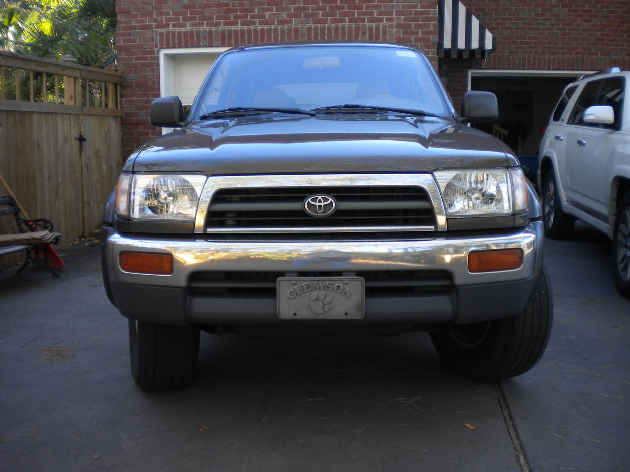

I installed TYC headlights in my 1998 Limited, and I have a question about the reflector cones. The cone in the right assembly (left in picture) appears to point straight out; however the cone in the left assembly (right in picture) points downward at an odd angle. (Hope the picture shows what I'm saying. It is very noticable.) Is this normal??? My theory is that it's engineered this way to point away from oncoming traffic. I just installed today, so I haven't checked the pattern or lined them up. Will do that later tonight. Did a search, but I couldn't find an answer to this question. I like these lights. They seem to be sturdy and well made. Thank you in advance for the assistance.

No, they are not supposed to point at odd angles. They are supposed to point the same way.
You got some cheap Taiwan aftermarket headlights, quality control isn't really part of their 'Standard Operating Procedures'

Unfortunately TYC is the primary aftermarket headlight supplier for the United States. I haven't seen any other options besides OEM.
Good news though: you can just swap the glass :)

I put in an aftermarket set. Tossed my old ones in the dumpster cause they were chiped and fogged. After one night drive I went dumpster diving and thankfully they were still there! My stock water taking on are brighter, better and all around superior. Baking the glass sounds like your best bet!
I have the same issue with the set I bought from Low Range Offroad. The one cone is pointing at some weird angle. You can reach inside from the back and try to bend it into position, but it's not easy.

Old thread …I know, but, still relevant. Thought I’d contribute 2-cents. I recently received a pair of the TYC headlights. Six years later and yes, they’re still sending them out with the bulb shield pointing down. The reason for that is that the driver’s side headlight is assembled using a passenger side shield. The shield does not fit properly and will not perform its intended purpose which is masking extraneous light from blinding oncoming traffic. It also interferes with the focus of the beam. I pointed this out to TYC and asked that they send one properly assembled … waiting.

Can confirm as well. The TYC's stiil come like this. I just swapped my cloudy 98's out for them. Its possible to adjust the beams via the long Phillips screwdriver method to make the pattern better. If you have foglights that helps too. Might try the oven method mentioned bc I still have the old lights.
