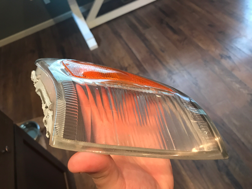

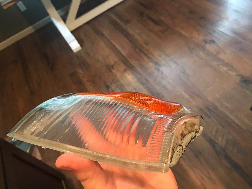

Not 100% yet, as I melted the lenses on my corners when I had them in the oven to remove them [emoji30] Gotta order new corners now. I'm sure it's not everyone's cup of tea, but I'm super happy with how it's coming together. A lot of guys like blacked out housings, but that's not really my cup of tea. I think Thunder Cloud would look really good on almost any color. I'd be willing to build another set for anyone interested. It's not a quick and easy job, so it's also not a cheap job.

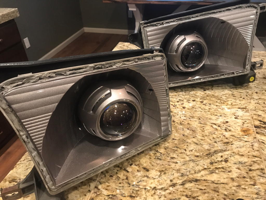

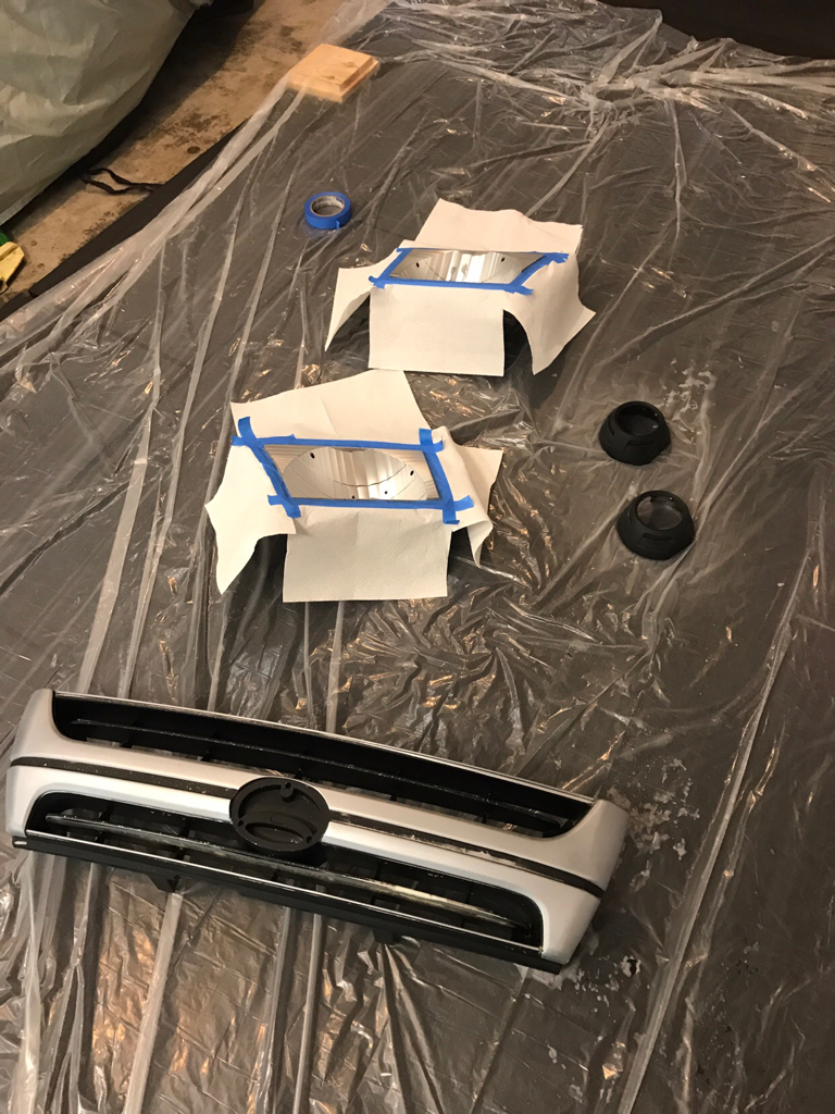

After drilling the housings, and aiming/aligning the projectors, I could get going on the paint.

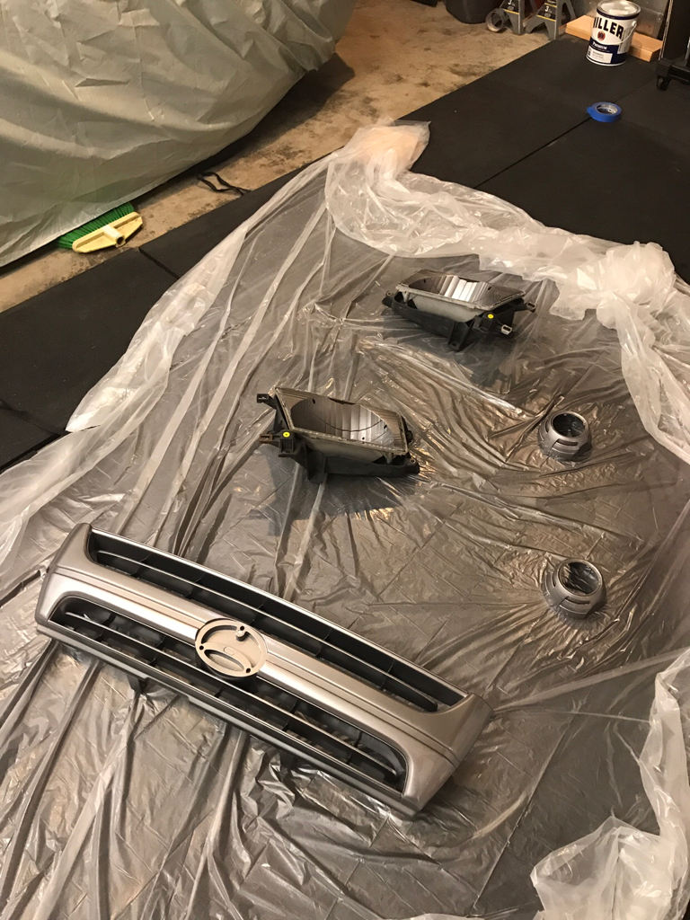

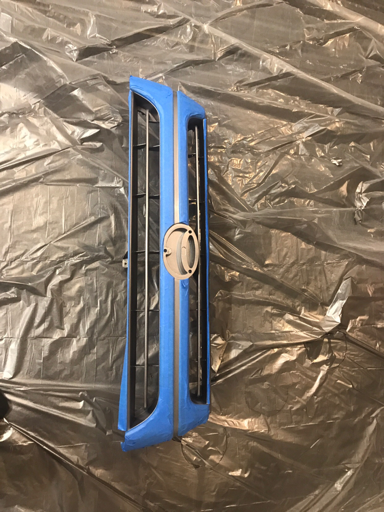

I scuffed the headlight housings, projector shrouds, and stock chrome grille.
Shot it all with Adhesion Promoter, base coat, and clear coat. The clear is a two part product- meaning it has a hardener in it just like auto body painters use.
It layed down super flat, but I ran out halfway through, so the grille will need some wet sanding if I feel like making it perfect.
Anyway, shot with base and clear-

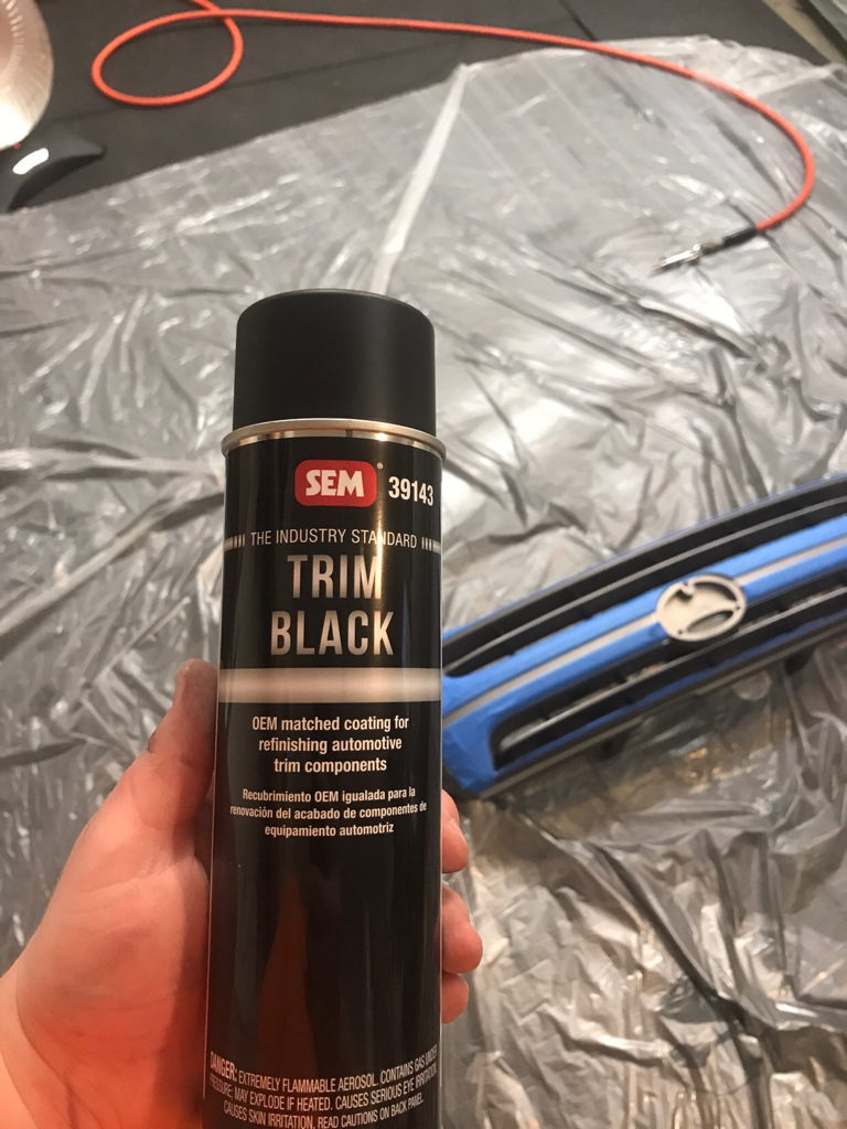

Taping the grill off for the black was a huge PITA, but the SEM Trim Paint is awesome stuff!
I'm not a professional, so- again- this didn't turn out perfect either. Good enough for me though.

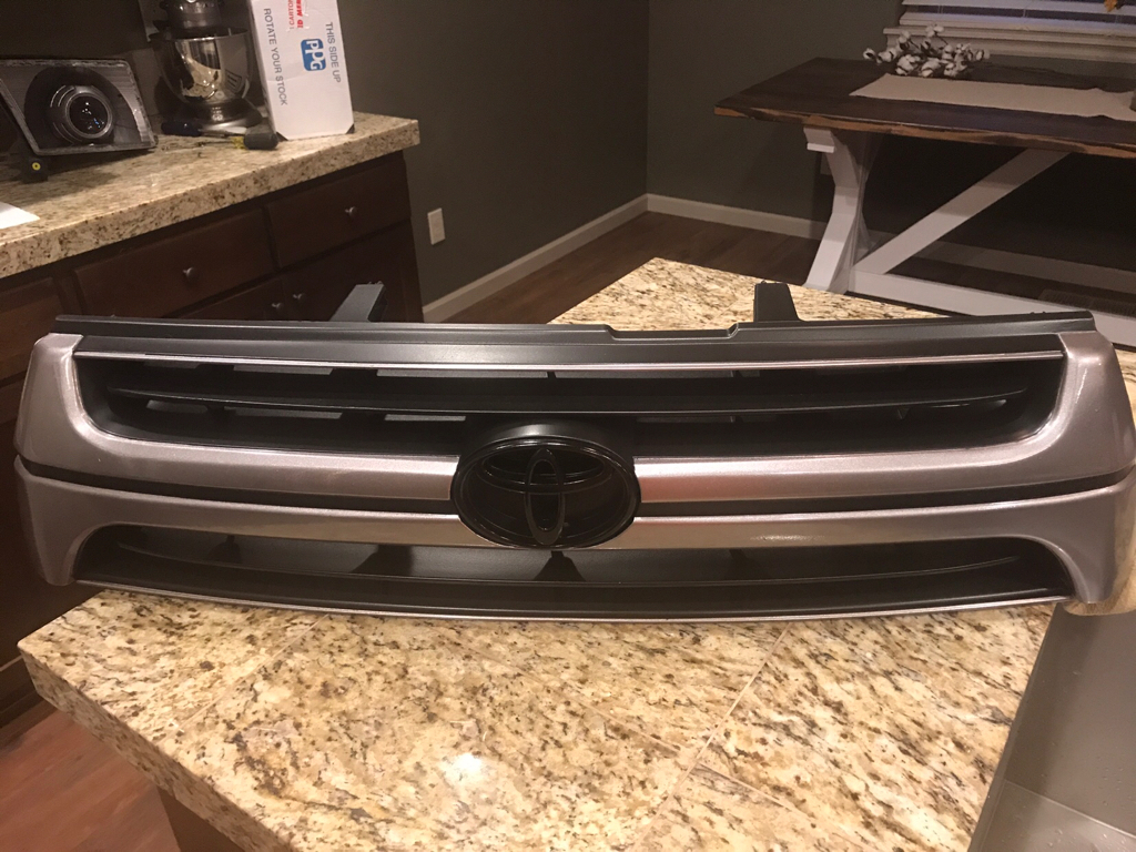

Then I shot the emblem with gloss black epoxy. I thought the gloss black would be enough contrast from the satin trim black, but I'm wishing I carried the body color behind the emblem to give it more contrast. Oh well. Maybe I'll get another grille and take another shot at it.

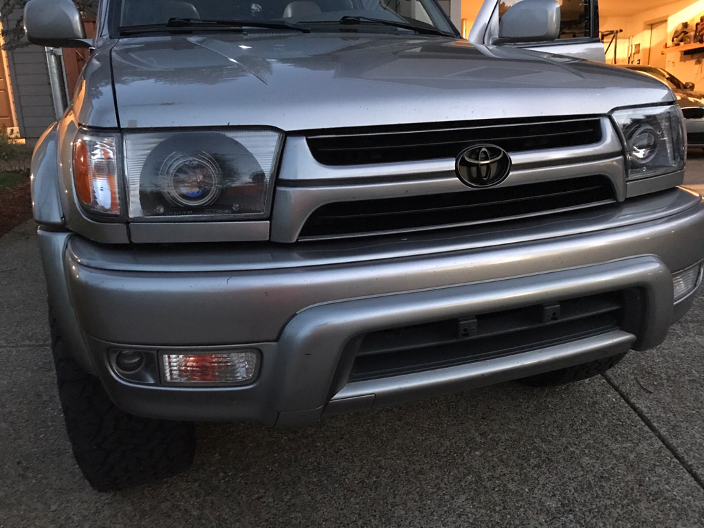

And the almost-finished product
I think the blue/purple lens looks super good with the Thunder Cloud. You'll notice new Tahoe's/Charger's/Challenger's have the same lenses.

I didn't even know you could get colored lenses for projectors. That's kinda cool. Looks like it came out very nice. I like the thundercloud housings instead of the normal black that most people do. Maybe one of these days I'll retrofit mine.
Well- not saying they don't exist, but- I haven't seen various colored lenses available to swap into a projector. The G5 line of projectors from NHK use these lenses, as do some OEM manufacturers. So I didn't pick the lens color, but I do like it a lot! Thanks for the kind words ❤️

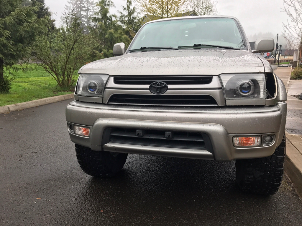

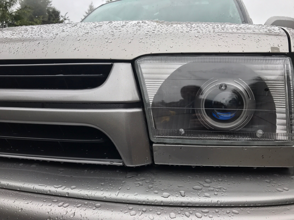

So, while I love the way they turned out- especially the blue lenses with my paint color. I can't say I like the output of the NHK G5-EXL 3.2" projectors more than the D2S 4.0's, but we'll see.
I'll follow up with more, but the Morimoto D2S 4.0 were much better for my taste.

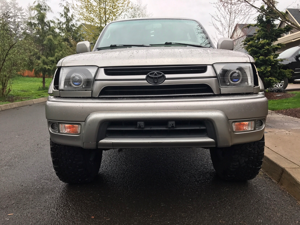

Here's a quick shot from my commute this AM.
Looks good man, I've contemplated pulling mine apart to reshoot my black housings grey to match my grille and scoop
Sent from my Pixel XL using Tapatalk
The color match looks awesome. I’ve been contemplating losing the chrome and matching the thundercloud on the grill. This is tempting me..
So, while I love the way they turned out- especially the blue lenses with my paint color- I can't say I'm thrilled with the output of the NHK G5-EXL 3.2" projectors.
Thanks for the update. It's interesting, it looks like the hot spot, though very bright indeed, creates a lack of uniformity with the rest of the pattern, which I agree would be annoying. Sounds like D2S is the way to go!
Are you painting your corner reflectors Thunder Cloud too? I did a black out set and it cut light output tremendously, not what I wanted. I swapped over to a clear corner as is.

Oh yeah, painting them black will definitely make the already-dim corners drastically more lackluster! If you had sprayed a clear over the black, it would have lit up a little better, but still not great at all. I had the oven too hot, and melted the lenses when I opened them up.
But- once again- [MENTION=124101]Chim[/MENTION] comin in clutch with a replacement set for me! ❤️[emoji1373]
I threw them on so it wouldn't be looking so ghetto with empty corners, but I do plan on painting my old corners, and using the lenses off of these once they're done.

Also, the more I run these projectors at night, the happier I am with them. The nut and bold method is a PITA, but also nice, because it allows you to sink the projector further in. I think that's one thing that helps the looks quite a bit. With the threaded shafts, the projector ends up much closer to the glass, which contributes to the not-so-awesome bug eye look of retrofits on our 3rd gens. As much as I want to say I would never do the nut-and-bolt method again- I can't say that. The more I think about it, the more I think the projector being sunk in really makes it look a lot better.
That's a good point Tyler, I haven't thought about that. Then again, if you're a glutton for punishment, you can turn most any threaded shaft projector installation into a nut and bolt installation to place it where you want it. That's what I had to do in my minivan installation. I can see how the deeper installation would look less bug-eyed than the threaded shaft one.
