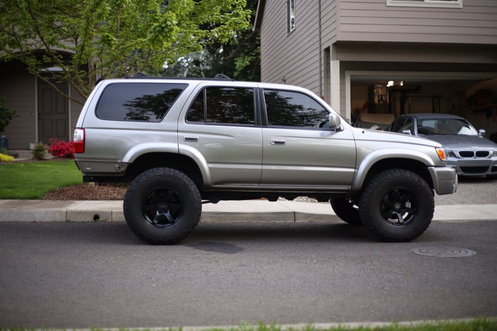

Just a pic dump 'cause I felt like takin pics.

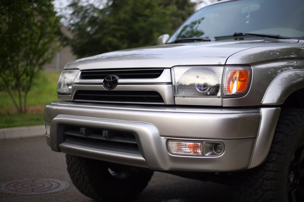

Still super happy with the grille and headlights. Still like the 4.0's better, but I REALLY like the blue glass on these G5's. Maybe I'll wait for the D2S 5.0, and maybe I can swap the glass for blue [emoji847] We'll see. I still need to paint and retrofit the corners, and I'll repainted the filler panels while I'm sprayin.

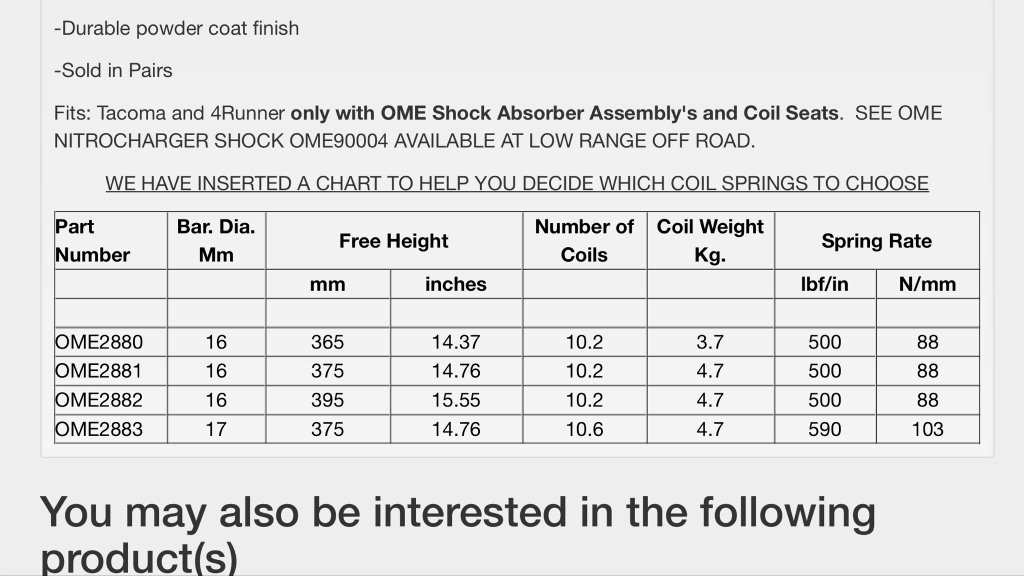

Also want new front coils. The 881's I put on the homie's rig ride 100x better than my 99's do! Seems like the 882 with the same spring rate and a taller free-standing height would be the ticket, but info is hard to find, and some say they ride really stiff! Really doesn't make sense for a 500lb rate coil. Unless they were really pre-loaded.

The headlights look awesome... Scratch that the whole rig does man. Super clean. The blue glass in the shrouds looks very nice. Didn't think much of colored glass for the projector but I really like it. Nice work man!

Toytec says the 882 is stock-weight 2.5" lift coil; they say add a spacer for the full 3" lift.
How much lift are you looking for in the front, do you like the current rake?
It's not that I like- or dislike- the rake, I just HATE sag, and so I don't want it to be sagging when I have a load in/behind it. On top of that, I'm waiting for the Ford tank and rear bumper mounts/design to get finished up, and both of those things are gonna add weight. I hate sag, and I wanna stay as low as I can.
As far as how much lift, I'm at 2.25" over stock right now, and it's about perfect. I'd be cool with anything under 3". The less angle my CV's and arms are at, the happier I am. In a perfect world, I'd be stock height on 37's. That's really not practical without cutting way more than I'm willing to, so it's just a balancing act.
All that said, 2.5" with the 882 with a 500lb rate should be tits, but I've found threads with members saying they ride stiff. [emoji849]

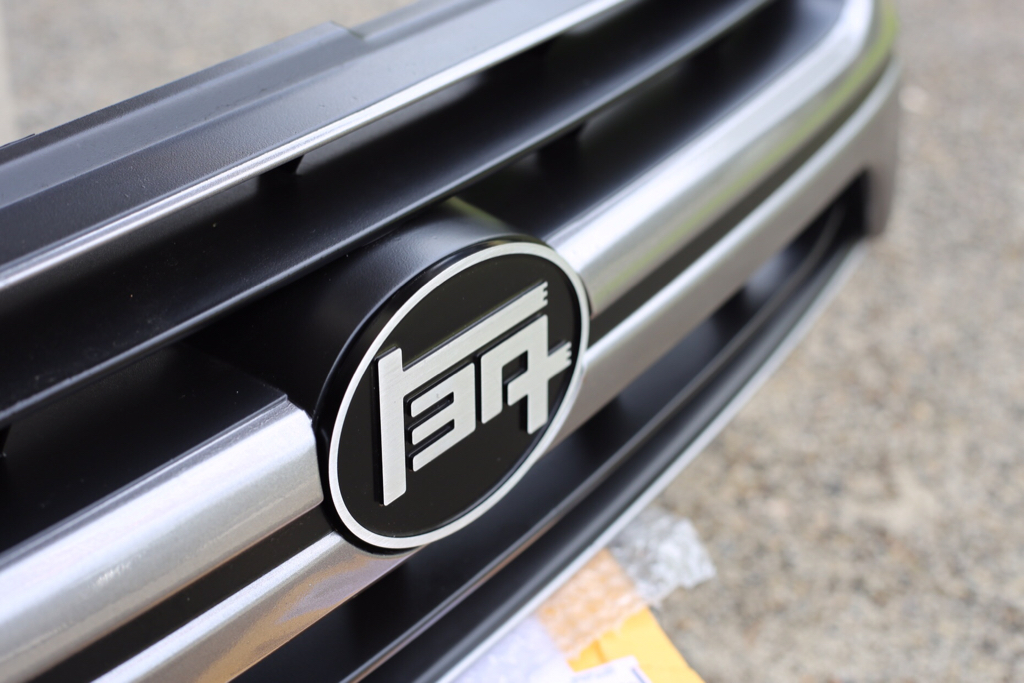

[MENTION=89792]bhicks[/MENTION] of BH3D needed someone to test his TEQ badge on a '01/02 grille, and I happened to be the lucky guy to raise my hand first. Thanks again [MENTION=89792]bhicks[/MENTION]
If you like the style, I would HIGHLY recommend this badge. The craftsmanship is great, and the fit and finish is spot-on. Great work by BH3D.

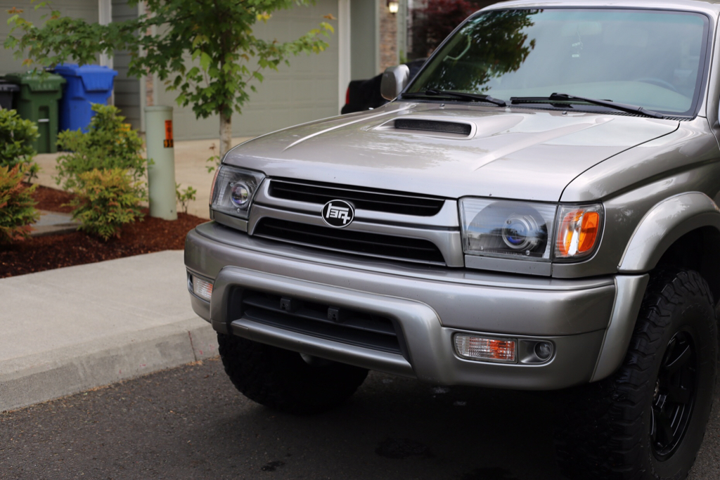

Also picked up a sport hood a couple weeks ago [emoji16]

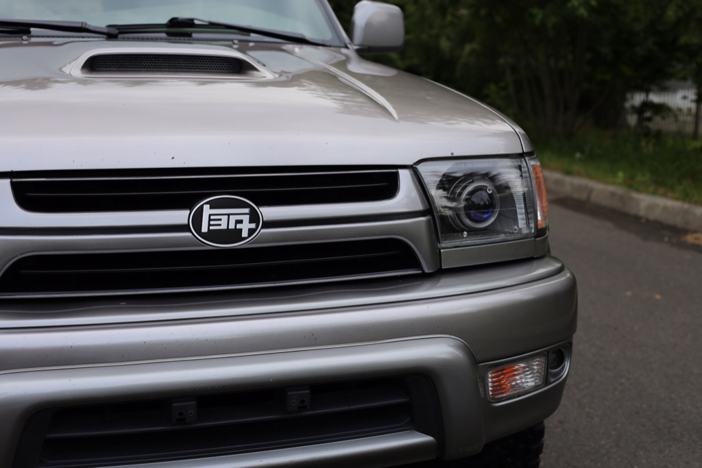

I scuffed the headlight housings, projector shrouds, and stock chrome grille.
Shot it all with Adhesion Promoter, base coat, and clear coat. The clear is a two part product- meaning it has a hardener in it just like auto body painters use.
It layed down super flat, but I ran out halfway through, so the grille will need some wet sanding if I feel like making it perfect.
I'm not a professional, so- again- this didn't turn out perfect either. Good enough for me though.

Awesome!!! This is great news. I will get a large batch of these made up tomorrow and up on my site by the end of the week. Did the hardware work perfectly? That was my biggest concern sine the 80 series grille and 3rd gen grille are VERY different.
Yes! It did work perfectly. When I saw how little the screws actually went into the badge, I was apprehensive. But when I got it on(), the screws threaded in just enough, and the badge was held firmly secure. To make sure the screws were proper, I installed the badge without using the double-sided tape- so I KNOW the screws/washers are a perfect fit for the OEM '01/02 grille
