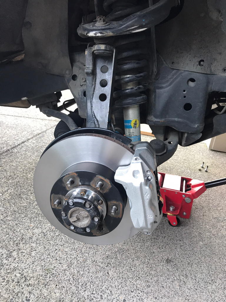

Have I even updated since I did the manual hubs?!

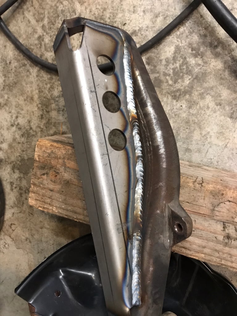

Got the manual hubs on with new bearings, and threw on a TC knuckle gusset while I was at it-

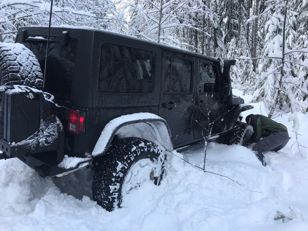

And another trip-
Not good at taking pics much, but it was 2' deep at the deepest point!
My buddy even got stuck in his Rubicon locked fr/rr on Duratracs! Not me! [emoji1598]

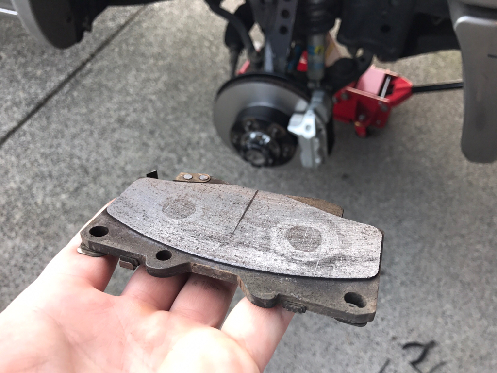

Also had the rotors turned and put Akebono pads on the front. Really happy with them!

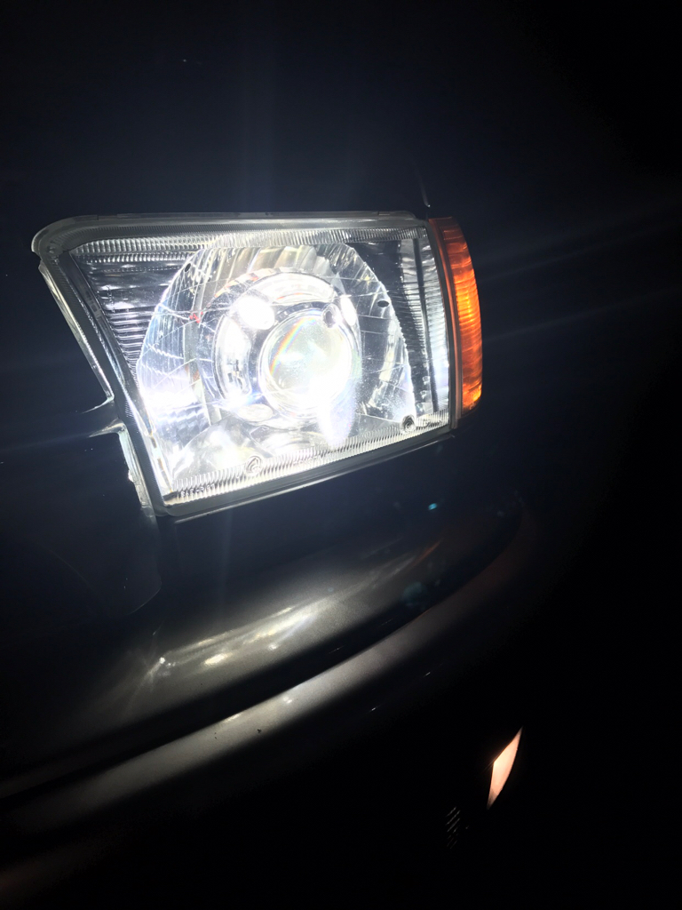

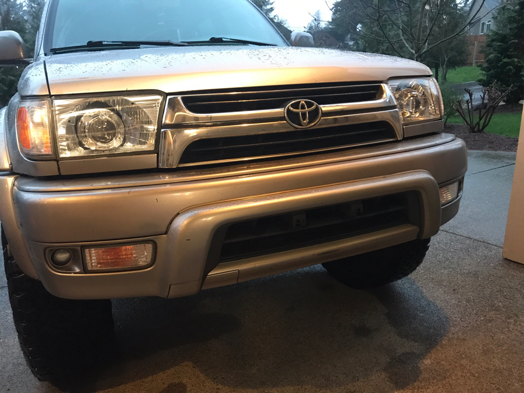

FINALLY got to finish up my retrofits that I built over a year ago! [emoji847]
TRS D2S 4.0 Projectors
45w Hylux ballasts
NHK 5500k bulbs
The light output is so insane, and so nice!
That was before adjusting them up some.
The step on the 4.0 is huge, and sometimes a little annoying. But it makes it so you can have them adjusted higher, while not affecting oncoming drivers- which is obviously great!

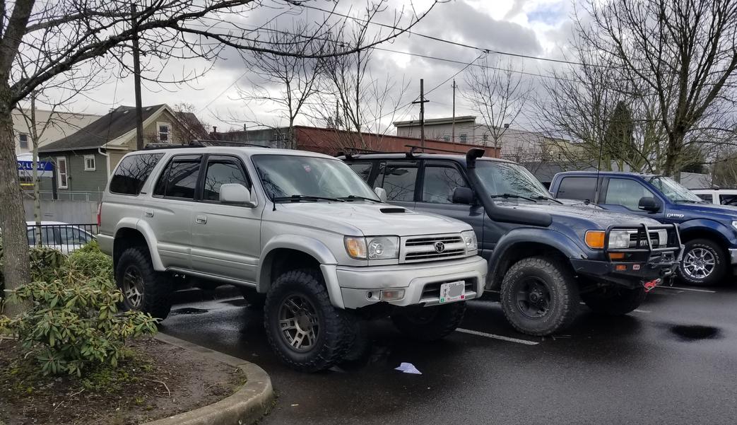

That's my 96 Taco 5-speed V6 recently purchased with 331,000 miles. I figured I'd also include my 88 Toyo Van. It also has 335,000 miles on it. I'm a Toyo guy. Actually between the 3 Toyo's I own they have a combined 900,000 miles and counting. lol

Are you going to put a rear bumper on this thing? If you get rear ended you're totaled. I dont even like driving my rig around the block with out bumpers on but I do. I see you went for the bug eye look, I put that mod right up there with the Satoshi! LOL :flipoff: If I go projectors I would do the duel lenses like Brilliant did only I'd use glass.

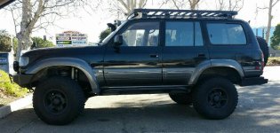

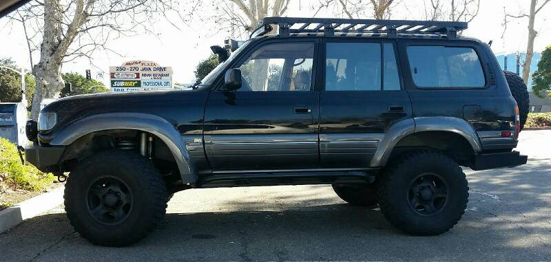

I saw a Thunder Cloud LC100 yesterday that made my pants a little tight. I think I need one.
My wife says "daaaaaaamn, I want it! Looks so good with the black pearl badges. I need something to get around in when it snows"
So yeah, we'll definitely be looking for a LX470 or LC100 in the next couple years.
It looked so good.

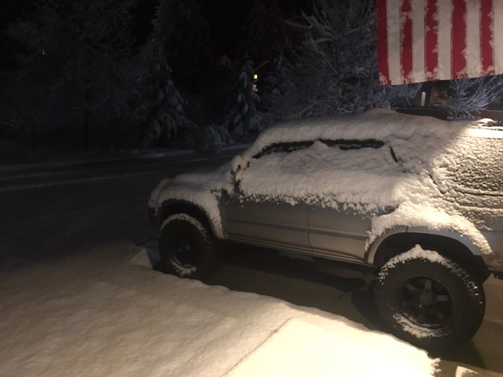

I thought we weren't gonna get a winter this year, so I put the Michelins and M wheels back on the BMW. Guess I was wrong. Got 6" of snow in the last 12hrs.
Wish I would have put her in the garage before it started coming down!

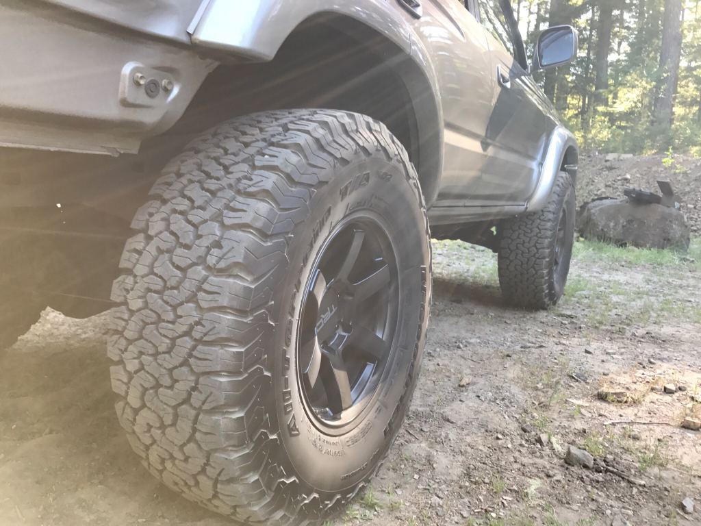

Suspension is '99 Highlander coils on Tundra 5100 on 4th perch up front, and Superflex coils with 5th gen Tokico black shocks rear. With [MENTION=28464]eimkeith[/MENTION]'s PCK, of course.
I pulled the rear coil isolators to lose a little lift in the rear.
I'm at about 2 1/4" front, and 3.5" rear.
My wheels are 17x9" et0 (5" backspace).
Tires are 315/70R17.
