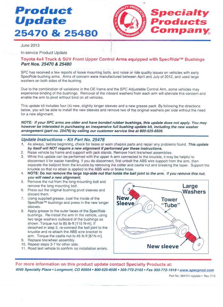

You have version 3 of the instructions. Here is the most recent version 4. Which shows the longer, updated sleeve. In the old instructions, they used a small washer to compensate for the sleeve. They needed to do this until they had the longer sleeves manufactured.

SPC's history
Version 1 - Rubber bushings, large washers on all sides (8 washers).
Version 2 - Poly bushings, large washers on all sides (8 washers). These are the ones that fail in high temp climates. The large washers "squeeze" the bushing to the point of collapse. This does not allow the control arm to pivot on the bushing. Effectively, making the control arm bend up and down at the welds.
Version 3 - Poly bushings, 4 large washers, 4 small (2 large washers on the outer most part of control arm, 2 small washers on the inside). This was SPC's solution to an extended sleeve. This does not allow the bushings to be completely compressed by large washers.
Version 4 - Poly bushings, 4 large washers (2 large washers on the outer most part of control arm). In this version the sleeve is longer and is completely butt up against the "tower tube".
Within version 2-3, there was a bushing change over. The newest bushings have the texture of a golf ball. These dimples retain the lube much better than the original ones which were smooth.
Unfortunately, some of us learned at the expensive of our wallets. But I believe these are the best control arms for the money and adjustability. You just have to make sure you've got the latest version (3 or 4). Or if you're like me, I kept the rubber bushing v.1 and installed small washers. This way I don't have to deal with the squeaky poly bushing issue.

-I'm assuming I have version 3, should I eventually worry about going up to version 4?

I'm pretty sure you have version 3. It will be easy to tell by looking and checking to see if there are small washers. These washers can actually be installed on the furthest outside or inside. As long as there isn't pressure on both sides of the bushings.
I wouldn't worry about going to version 4. Maybe if you need to rebuild them in the future. The small washer solution is bascially the same thing.
