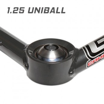

The camburgs are a bigger uniball - 1.25" vs 1" I believe. Both of which would be over kill for me.
also... Camburg uniballs now incorporate flush-mount hardware so they may be able to accommodate a cap kit—like the one available for the ICON tubular UCAs. i've sent Camburg an email asking if they plan to offer a uniball cap kit and will post back up when i hear...

Camburg uniball cap kit = SOON
hey y'all.
did some more digging and wanted to post my findings again here in this thread.
i spoke with Camburg yesterday... super friendly, knowledgable, and happy to answer questions. i hung up the phone impressed. good news: in ~6 weeks Camburg will have a cap kit for their 1.25" uniball arms. apparently the cap will be backwards-compatible with existing Camburg (flush-mount) uniball UCAs in the field too, so that's cool. :trophy:
obviously a cap doesn't entirely prevent a uniball arm from requiring additional care, lubrication, or service; the underside is still exposed, of course. but the cap does at least prevent muck from constantly making itself at home topside, where you don't have gravity working with you to purge debris as you do on the underside.
