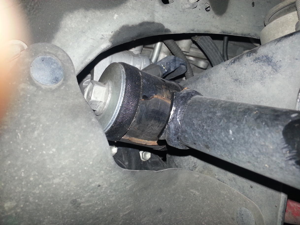

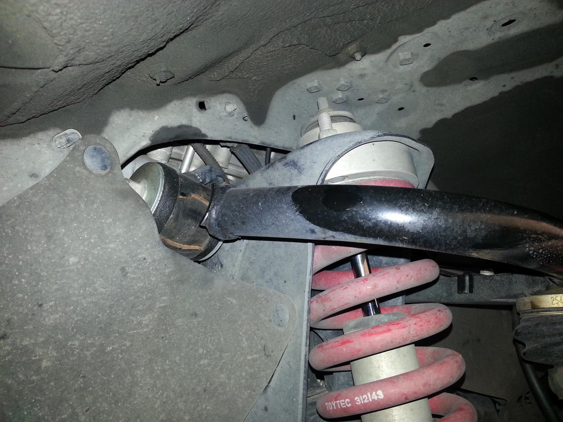

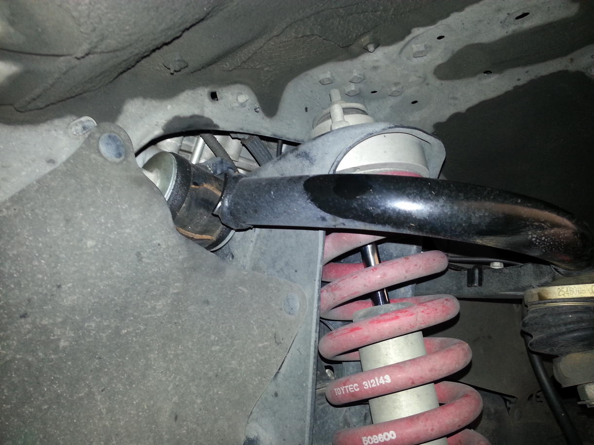

I think the SPC Light Racing arms are crap. This is my driver side UCA. I would never purchase anything from them again. It broke while i was out in California for school and had it not been for MetalTech4x4 which is where i purchased them from i would have been up creek with out a paddle. The design and quality is crap. Stick with a Uni Ball. They were purchased in 5/12 sat in the box and installed in 12/12 and broke by 5/13.
