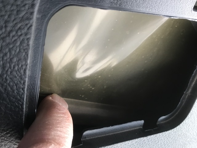

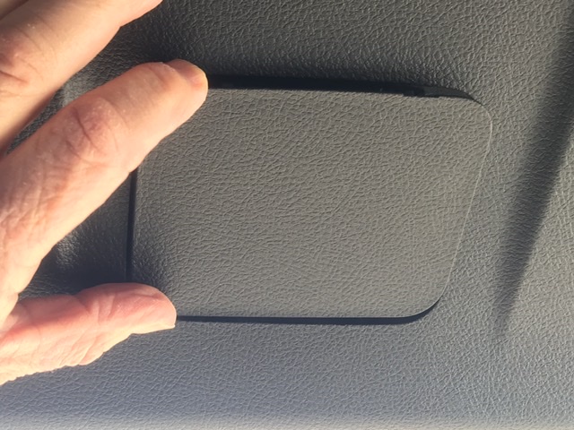

[MENTION=165350]nytosc[/MENTION], will the hatch pop button function on the 2020+ model years? Is [MENTION=569635]kaitlyn2004[/MENTION] the first to attempt this mod on a 2020?
Maybe a brute force method will work, that is, a manual latch disengage. I believe that’s the reason for the little panel cover on the bottom of my hatch door. Pop off the cover and you have access to the area around the latching mechanism. I haven’t done this but you’d have to cut through the plastic dust covering, attach a string to the release lever and fish it back through a hole in the cover. Googling around the forum I see others have done this. This link is the only one I’ve seen that has photos, although not so clear.
https://www.toyota-4runner.org/1609636-post54.html
Rear Hatch Mod (no electric)(open from inside)
