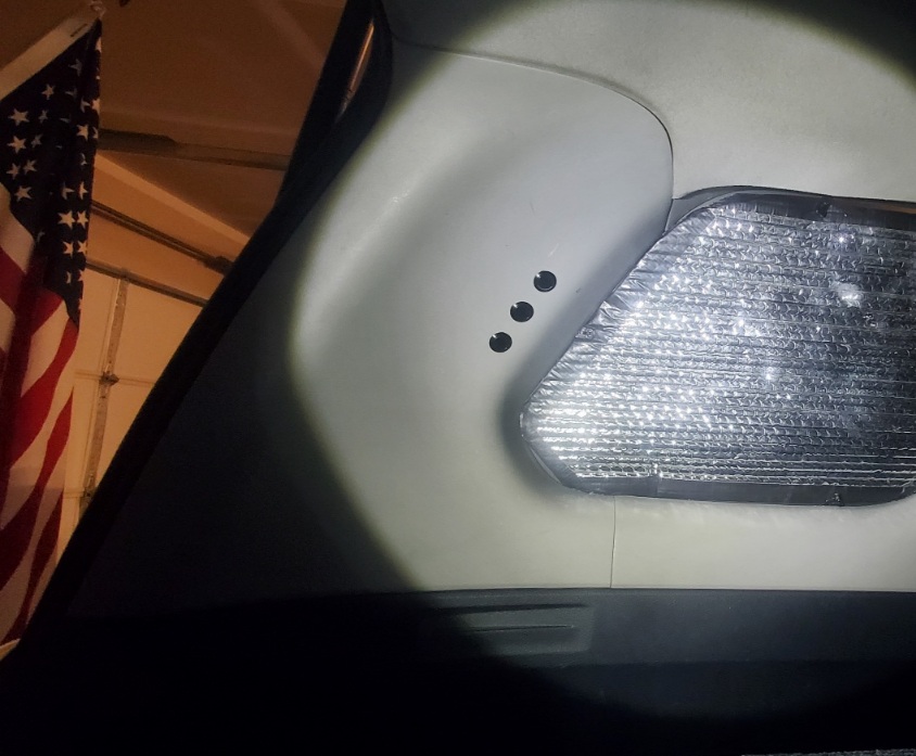

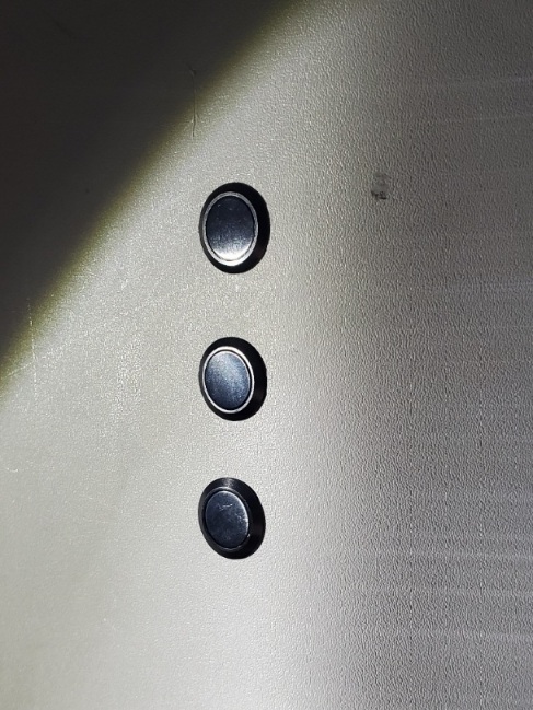

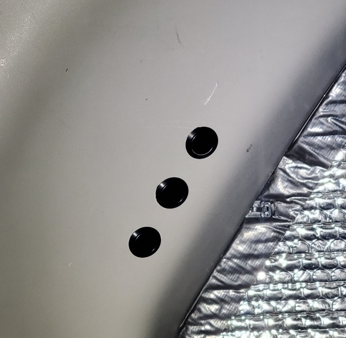

Kit was perfect, instructions were perfect, price was great, couldn't ask for more! Thanks man! I didn't take pics of the process, but here's the finished product.
