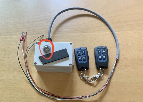

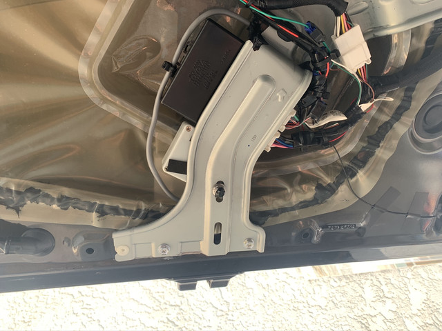

[MENTION=165350]nytosc[/MENTION],
Looking at your latest invention for the remote control.
Can you provide some more info on where that white receiver/control box is mounted?
Is that a mounting nut on the cover?
And the purpose of that black pad?
Is there an antenna?
Can you post some photos of how it looks installed?
Thx.

[MENTION=200736]ElectroBoy[/MENTION] All good questions!
This mounts onto the bracket that holds the body control computer on. Luckily there is a channel on that bracket which I use. I'm pretty happy with how well this fits! See below:
See image below- this mounts to the factory bracket that holds the body control module on.
I drill a hole in the panel and back feed a M6 bolt thru with a special washer on the front to retain it. I ship the kit with the mating nut (and a star washer for your ground) right on the stud to keep things organized.
Black pad is just to provide some insulation as it mounts to a hard metal bracket- its probably not necessary, but it cant hurt.
Yes there is an antenna, but it is housed within the box. To the end user, they dont have to worry about it- all they do is hook up 4 wires and attach a ground via a 10mm head bolt.
