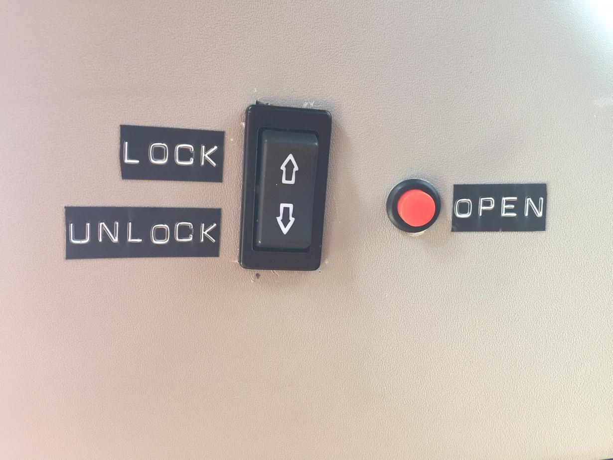

Here's a better photo of the top sill rear hatch install, looking down with the rear window open.
The blank hole cover is a 3/4" hole plug which I installed because I accidentally overbored the first 1/2" hole I was drilling for the red hatch release button... Doh!
It may also be worth noting (it's not obvious) that you are actually getting 5 functions with this. The hatch can be opened from inside, the window can be adjusted up and down, and the doors can be locked and unlocked.
I actually really like this idea. Then you don't have to fish the wire through the rear hatch connection to the cabin (the most painful part of this). Overall this mod is pretty quick though, even having to do the above part, and very useful when sleeping in the back of the 4runner. Made some labels for mine so it was easy to remember which way was locking and unlocking. And then I couldn't leave the red button unlabeled. Maybe you should label yours not just for your sake but for others since the orientation of your switch is not intuitive lol
Maybe I will, but i won't use a label maker from 1969! Looking like those should be labels on a cold murder case file folder...
Lol found this old label maker in the back of my parents garage when I moved them out this past month. Probably was from 1969! But it still worked and I'm kinda diggin the old school look.

EDIT: the most painful part for me was trying to get the rubber boots between the hatch and body back on. It took forever and I had to keep hitting the rubber with the heat gun to loosen it up since it was in the 30's. I used a 1/8" coated cable to fish the wire into the hatch door. It worked and the wire was run in about 15 seconds. Love this mod.
