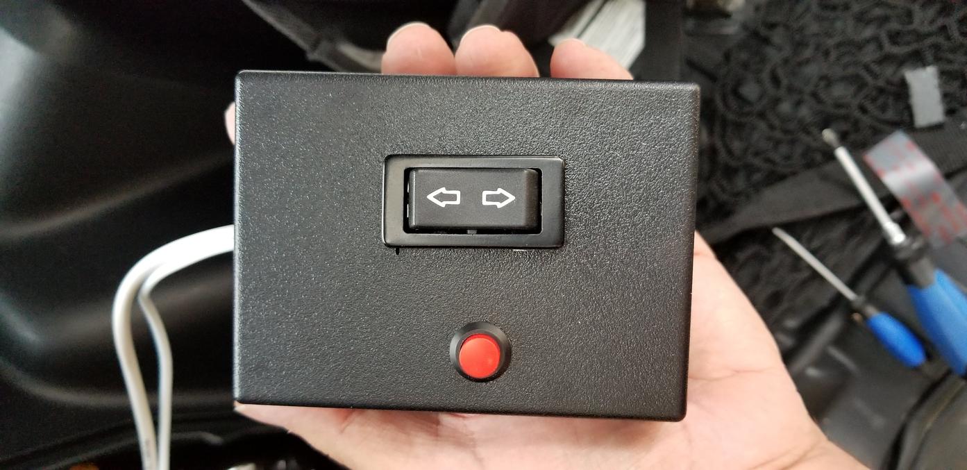

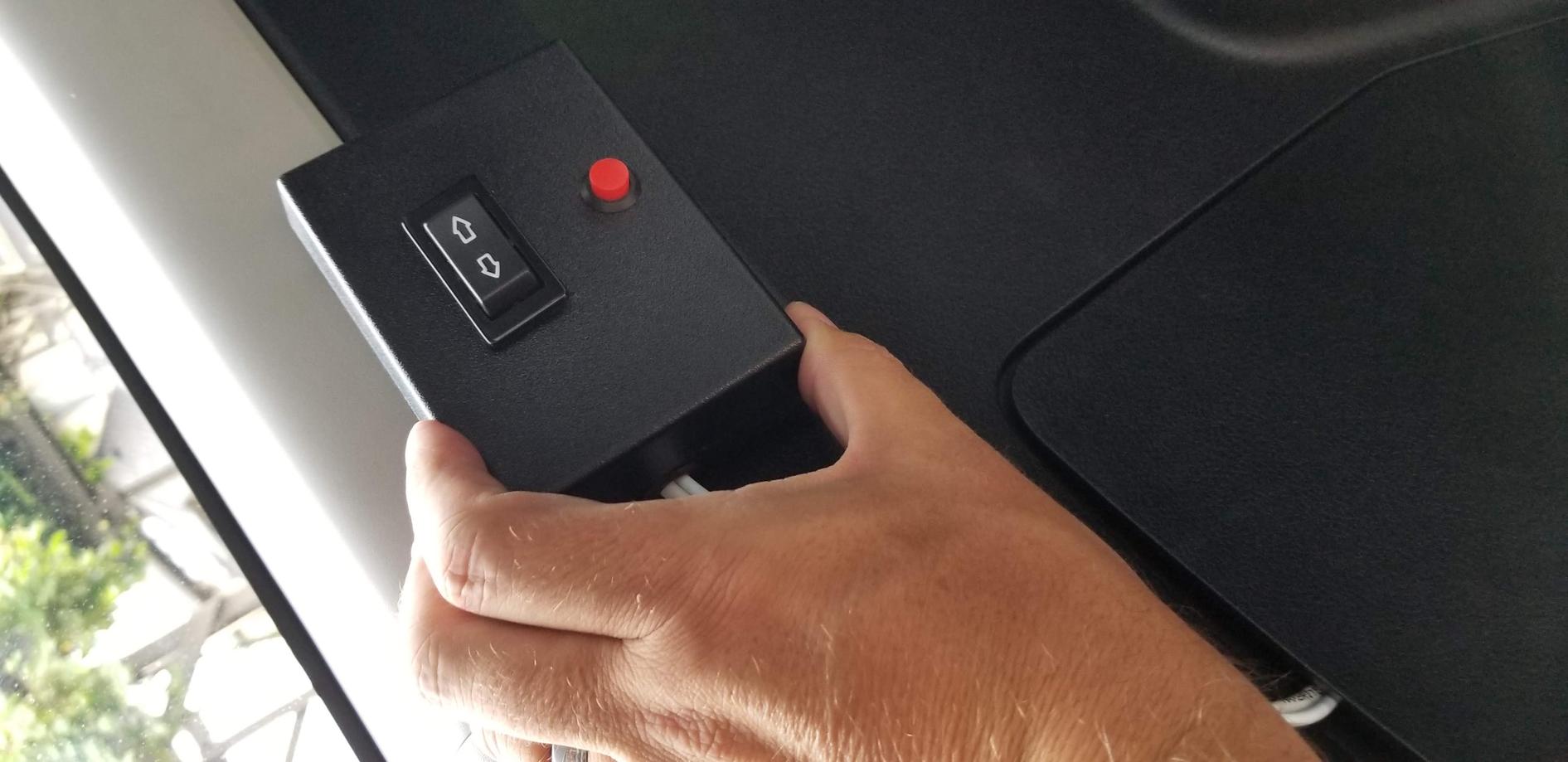

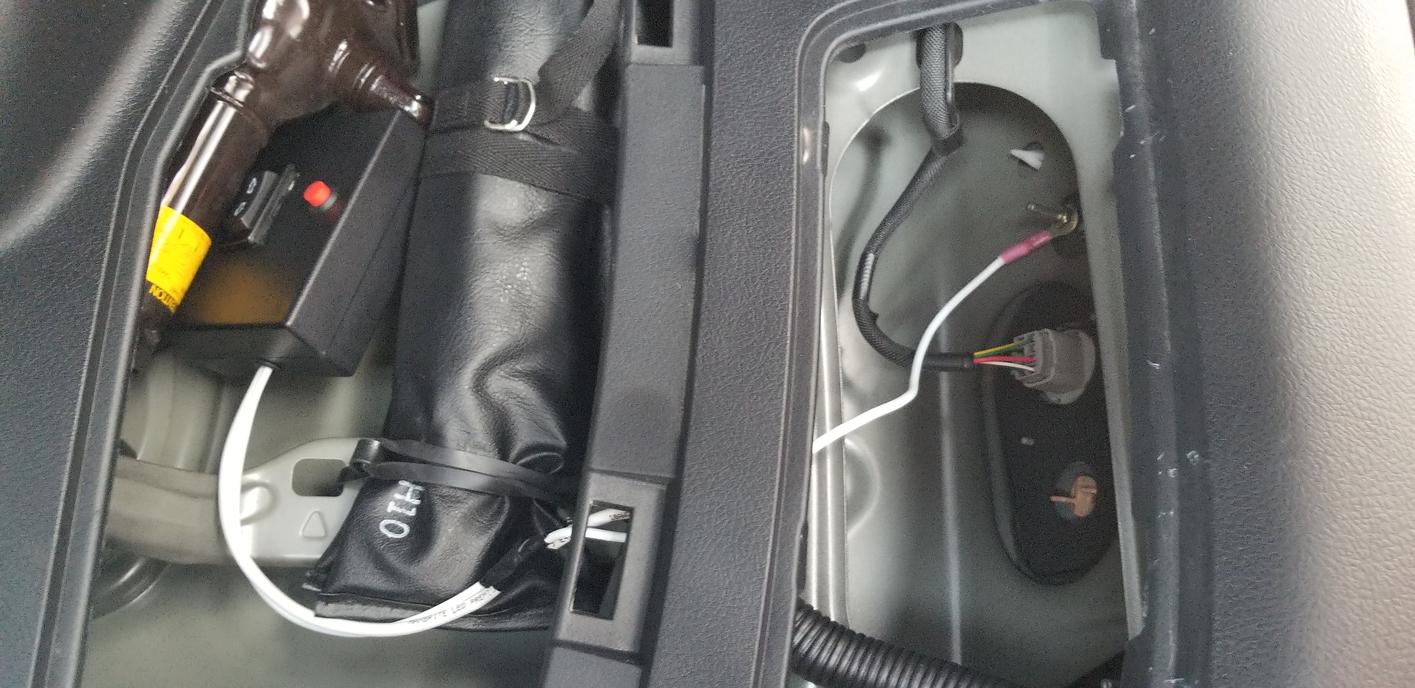

I received my kit last week. installed it this weekend. Had a couple questions with op quickly responded to. thanks for the help.
I did modify it a bit. I did not like the idea of mounting the buttons to the trim. so bought a project box from fry's and mounted the buttons in that. I tuck the box away into the jack storage hatch. I had to modify the wiring a bit to make best use of the length provided. The plan is to use velcro tape to mount it under the window when in use. keep it tucked away with the jack for everyday driving.
attached a couple photos
