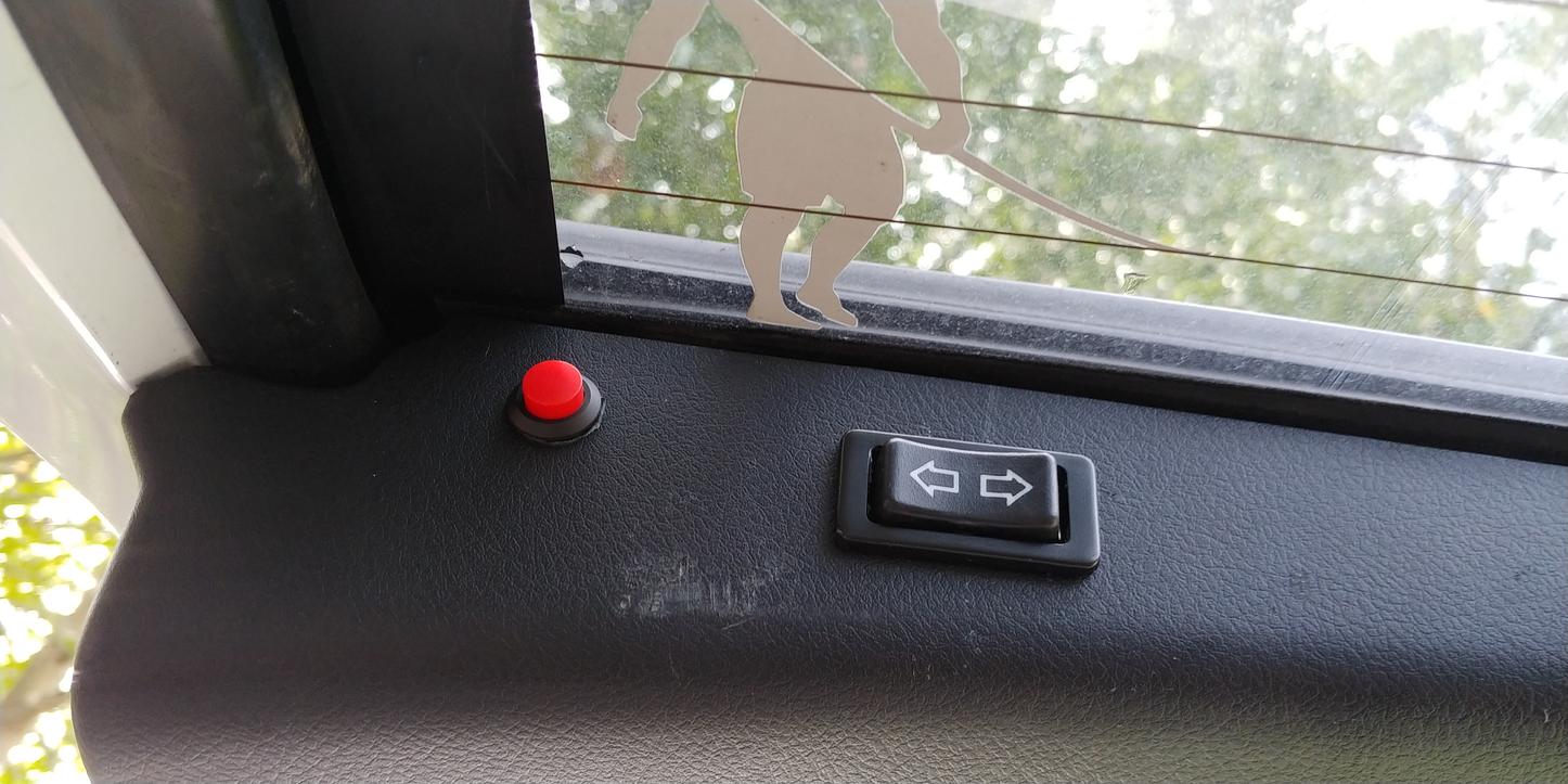

Installed my kit this morning. Super easy mod and I found the kit to be well built and the instructions well written. I mounted on the passenger side on the hatch. i used the pull down strap bolt to ground the setup and it worked great!!! Thanks again!

Installed mine yesterday. The kit is very high quality and the switches feel great. With the individual shipping on the switches I probably would not have been far from $50 anyway. I opted to install it in the rear door instead of the side trim. This was much easier than snaking it up and back down.
