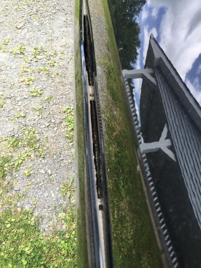

Driver's side trim separated at bottom from this...irony!
that sucks that your trim is already separating!

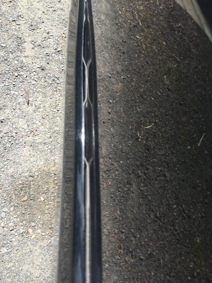

here's what all mine ended up doing (viewed from the top looking down)
I bought every expensive 3m tape known to man, used the adhesion promoter, removed and retaped the trim and stuck them back on a few times. I wound up buying a bunch of the orange and blue clips that are designed to break if you touch the fender trim. In the end, the L shaped profile of the pieces warped, and even the strongest 3m VHB tabe couldn't solve the fact that the oil had made a mess of the plastics, and they were no longer the same shape.
I had never heard of this happening before. As it turns out, I found out that the honda dealership in town specifically discourages the type of undercoating that I had because it is known to throw their plastics all out of whack too.
Very expensive lesson.

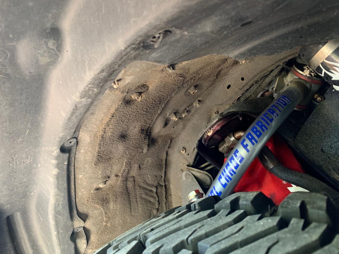

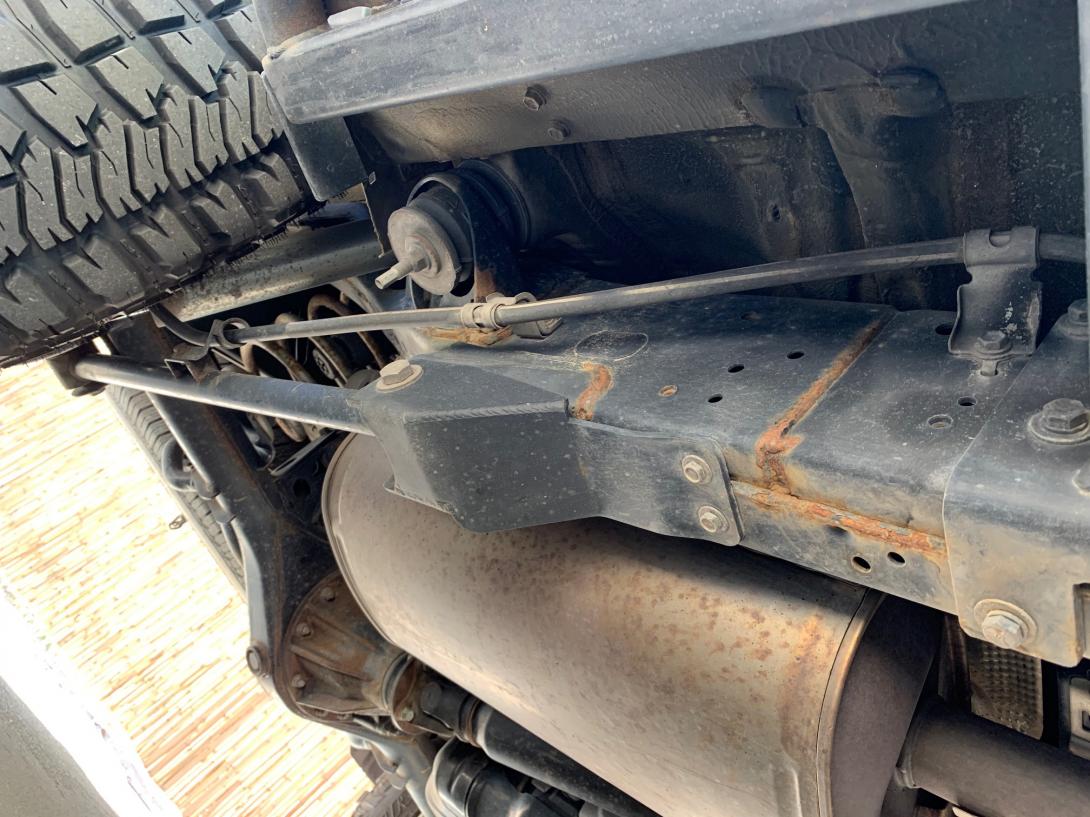

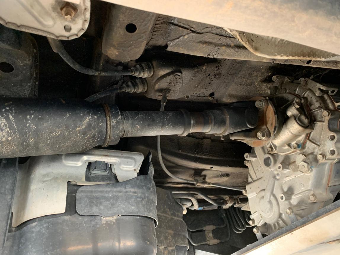

Here are a couple quick pics of my truck, I is six years old so don't mind the rusty frame weld bits... When it was done they removed heatshields, l;ower the spare, pulled the rubber splash guards. They did an acceptable job on my truck in my opinion.
Where your springs/shocks done? I mean mine are solidly coated black. And thank you for posting!
No, nothing was undercoated except the underside of the body. In the pics any where you see wavy brownish-black that is undercoating. For example in the second pic of the front fender well, notice the rough brownish material? That is UC. The plastic fender liner next to it, on the left, is smooth black plastic. The shock hoops those are factory black paint.

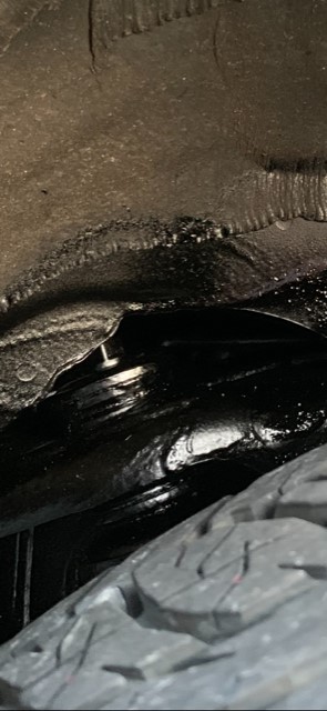

Here is the lower trim piece already showing the adhesive tape, plus some of the rustproof junk dripping down.
Also poor pic, but you can see the top of the suspension coated. Whole spring and shock assembly is like that.
