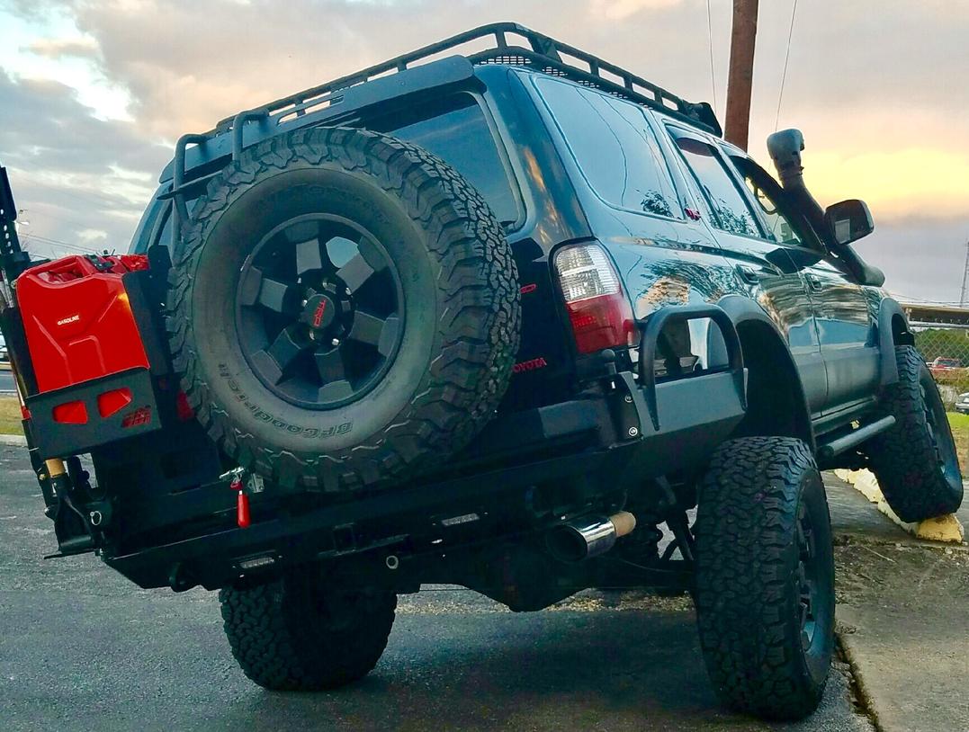

Got some more things knocked out this weekend. I swapped out my LC coils for the OME861's I bought from [MENTION=116877]fourfive[/MENTION] last summer. The stance is perfect in my opinion! Thanks to everyone I bothered about measurements, [MENTION=129084]Flemster[/MENTION], [MENTION=57546]4-Ripcord[/MENTION], and anyone else.
I got my rake back, but not too much that it looks silly. I actually got less lift than I thought I would from them, but that's OK. I was expecting somewhere around 39.25" ground to fender. Right after install, and after jumping up and down on the bumper a few times I was at 39" driver side and 38 3/4" passenger side. After driving about 50 miles and flexing the suspension a little I'm at 38 5/8" on both sides. Perfectly level side to side which is awesome! The panhard bar isn't that far off either, the axle sits about 1/3" further to the passenger side.
Here are my before measurements with the LC coils:
DF 21 3/4" 36 3/8"
PF 21 3/4" 36 1/2"
DR 22 7/8" 37 1/2"
PR 22 7/8" 37 1/2"
Here are the after measurements with the 861s.
DF 21 3/4" 36 5/8"
PF 21 3/4" 36 1/2"
DR 24" 38 5/8"
PR 24" 38 5/8"
And just for reference here's my measurements right after I installed the lift, before the bumpers and winch, but with the skids, sliders, and rack.

Also, I replaced the rear coils in an unconventional way for most of the members here. Instead of loosening all the control arms, taking the parking brake and brake line brackets off and then removing the lower shock mount and bump stops and flexing the suspension until you can get the springs out I went the easy way.
Put the frame on jackstands, lower the rear axle until the shocks bottom out, and then spring compressor time. I rented one from autozone, and used it to pull the old coils out and put the new ones in. This was so much easier than messing around with the panhard bar and flexing the suspension like I did last time. You just need to make sure that you have the spring compressors in the right spots so they clear the shock and you'll be good to go. I marked the locations of the spring compressors before I moved them from the LC coils to the 861s. It really didn't take very much compressing to get the new coils in there either.
The ride is a little different. It's not as cushy and Cadilac like with the 861s versus the LC coils, but it's nice having it a little firmer back there with all the weight. I do hear more rattles and squeaks from the rear interior pieces now though going over rough portions of road.
Overall I like the 861s, they ride pretty well, and they handle weight super well. With the LC coils if I stood on the back bumper (200 ish pounds) it would drop about an inch. Now with the 861s it drops like half an inch, but it also sits over an inch higher so it's much better.

Here's a few pics of the current stance of the truck on flat ground. It has the aggressive look/stance back again!
