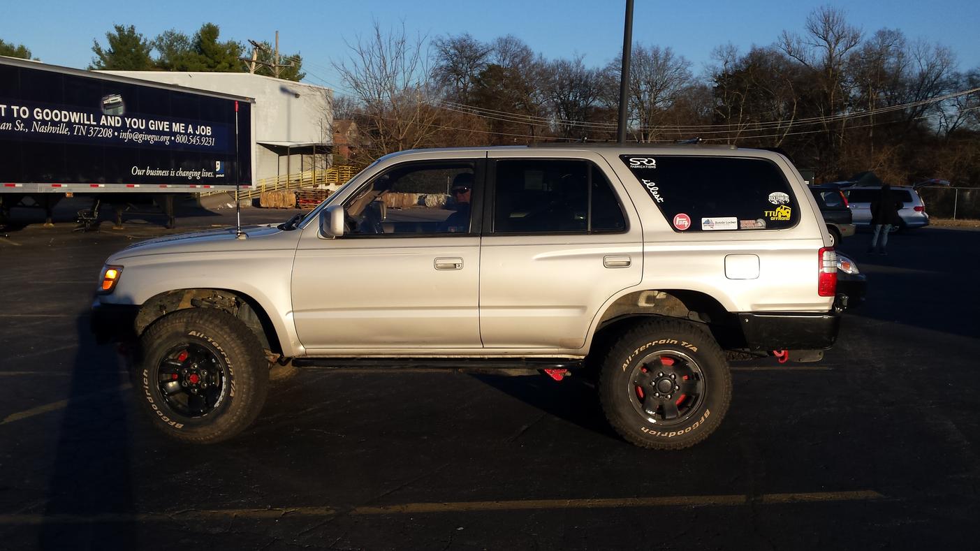

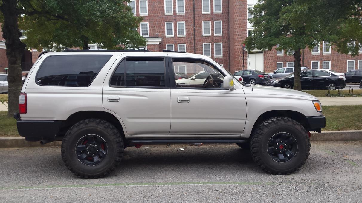

Here's a couple shots of mine. First is my 34" trail tires and 2nd is my 235/85 street tires
