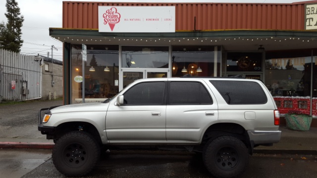

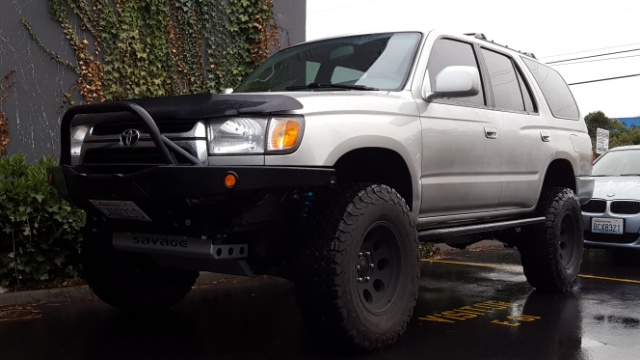

As for rake, I love mine and super glad I went that route. I did a SS rear lift with King 2.5 coilovers up front. I even set the CO's a bit on the high side because I knew skids and winch would soon follow. I would say throw those 861s on, especially with your rear bumper/ swing out.
The pick in front of the ice cream shop is right after lift installed. The second pic is after sliders and skids.
Well you ended up with a nice 4Runner anyway! The new bumper looks good on there. How much rake does your's have measurement wise? I want to put them in, but don't want to ride around like a stink bug anytime the truck is unloaded...
So after adding skids and whatnot, it looks like I ended up with about 2.5 inch lift up front with about 4 to 4.5 lift out back. So about a 2 inch rake.
I plan to give it a little time, especially after installing my winch with cable, to see where the front ends up. I can crank the front COs up a bit as needed to maintain my rake. I am unloaded in the rear. I really like the comfort of the ride. It feels super smooth overall on these unloaded 7 wraps with Tokico shocks. But you may want to find out people that switched to 861s specifically. It seems that a ton of our members running a swing out rear bumper end up with these. As to their comfort, I can't comment. Otherwise, I suppose there are Superflex, or LC 8 or 9 wraps, (that might balance out with your additional bumper weight in the rear.) Do you just want to make sure you are not sagging when loaded, or do you want a bit more rear lift overall? I would think that you could adjust your front coilovers so that the wreck was not so extreme. Obviously I imagine there is some break in time as well where are the rear would settle.
